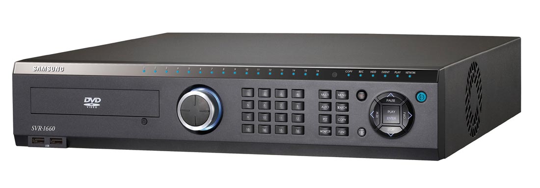

DVR Samsung SVR-1680C
ManufacturerSamsung
SeriesSVR
Part NumberSVR-1660C
Features
Detailed Description
  • MPEG-4 compression
  • Simultaneous MPEG-4/JPEG streaming
  • Two front panel USB ports for easy back up & mouse control
  • DVD writer is included as standard feature (ex.
    SVR-480 & SVR-945)
  • ATM/POS transaction data recording and search
  • Powerful CMS support as standard (SNM-128S/P)
  • Convenient control with a remote controller and a mouse
  • OSD (Multi-language)
  • Thumbnail search / Calendar search / Book mark function
  • Built-in web server
  • RS-232C, RS-485/422
  • Pan / Tilt / Zoom support (Multi-protocol)
