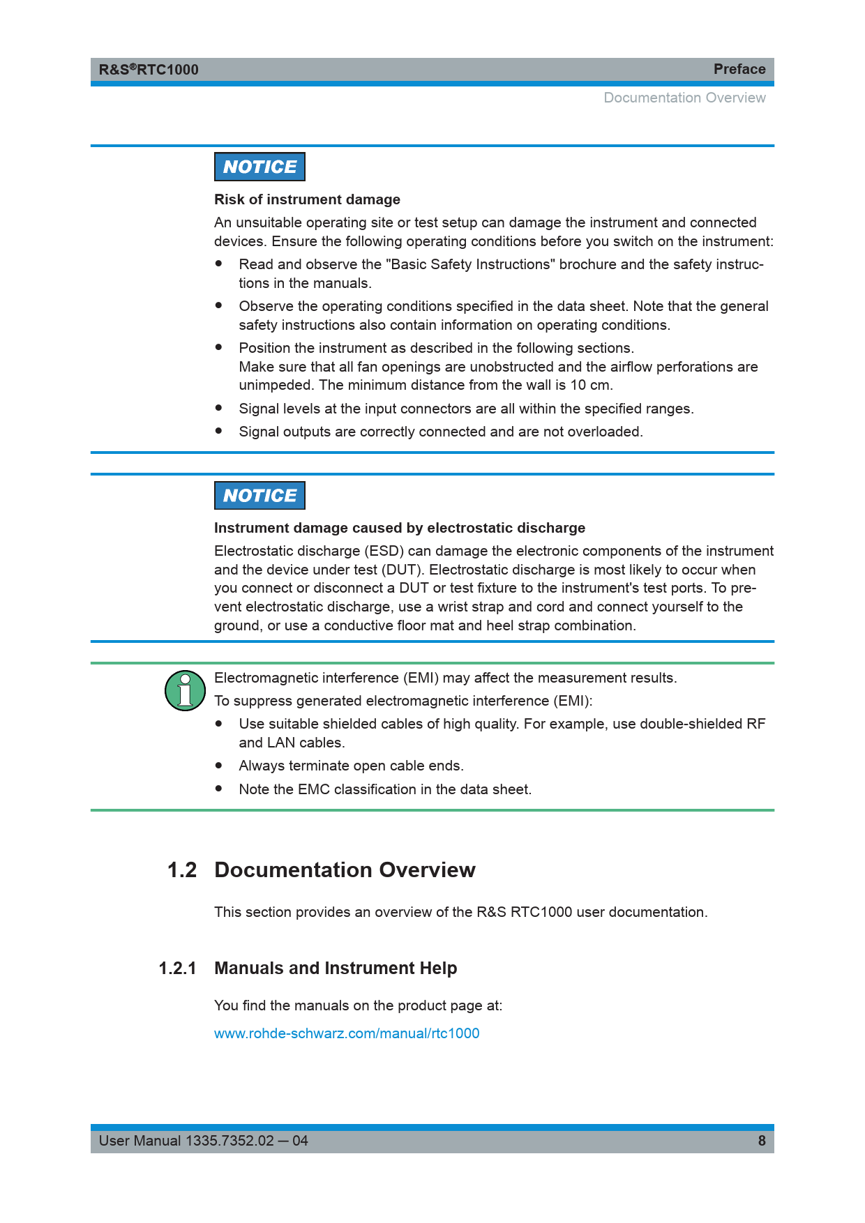

Risk of instrument damage
An unsuitable operating site or test setup can damage the instrument and connected devices. Ensure the following operating conditions before you switch on the instrument: ● Read and observe the "Basic Safety Instructions" brochure and the safety instruc- tions in the manuals. ● Observe the operating conditions specified in the data sheet. Note that the general safety instructions also contain information on operating conditions. ● Position the instrument as described in the following sections. Make sure that all fan openings are unobstructed and the airflow perforations are unimpeded. The minimum distance from the wall is 10 cm. ● Signal levels at the input connectors are all within the specified ranges. ● Signal outputs are correctly connected and are not overloaded.
Instrument damage caused by electrostatic discharge
Electrostatic discharge (ESD) can damage the electronic components of the instrument and the device under test (DUT). Electrostatic discharge is most likely to occur when you connect or disconnect a DUT or test fixture to the instrument's test ports. To pre- vent electrostatic discharge, use a wrist strap and cord and connect yourself to the ground, or use a conductive floor mat and heel strap combination. Electromagnetic interference (EMI) may affect the measurement results. To suppress generated electromagnetic interference (EMI): ● Use suitable shielded cables of high quality. For example, use double-shielded RF and LAN cables. ● Always terminate open cable ends. ● Note the EMC classification in the data sheet.
1.2 Documentation Overview
This section provides an overview of the R&S RTC1000 user documentation.
1.2.1 Manuals and Instrument Help
You find the manuals on the product page at: www.rohde-schwarz.com/manual/rtc1000 User Manual 1335.7352.02 ─ 04
