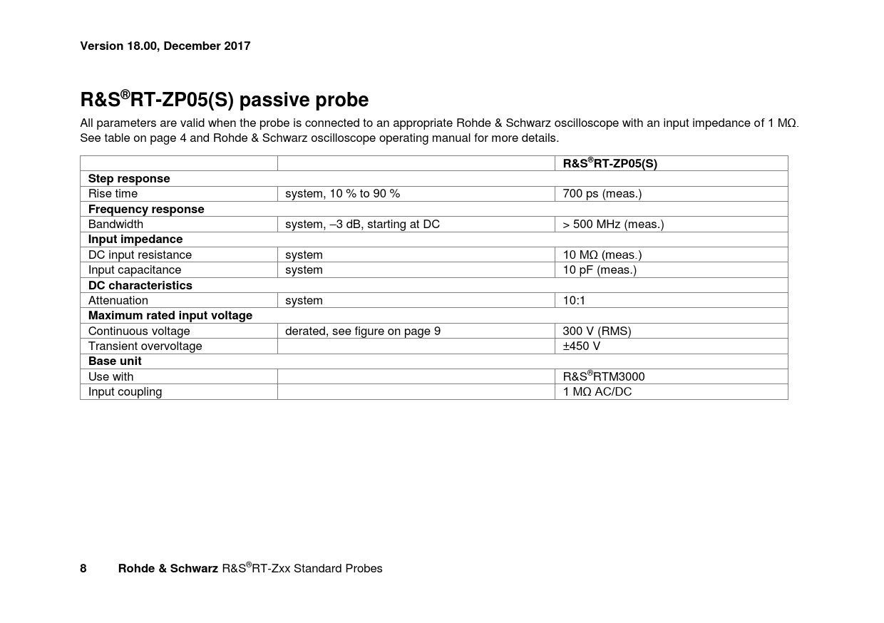

Version 18.00, December 2017 R&S®RT-ZP05(S) passive probe
All parameters are valid when the probe is connected to an appropriate Rohde & Schwarz oscilloscope with an input impedance of 1 MΩ. See table on page 4 and Rohde & Schwarz oscilloscope operating manual for more details.
R&S®RT-ZP05(S) Step response
Rise time system, 10 % to 90 % 700 ps (meas.)
Frequency response
Bandwidth system, –3 dB, starting at DC > 500 MHz (meas.)
Input impedance
DC input resistance system 10 MΩ (meas.) Input capacitance system 10 pF (meas.)
DC characteristics
Attenuation system 10:1
Maximum rated input voltage
Continuous voltage derated, see figure on page 9 300 V (RMS) Transient overvoltage ±450 V
Base unit
Use with R&S®RTM3000 Input coupling 1 MΩ AC/DC
