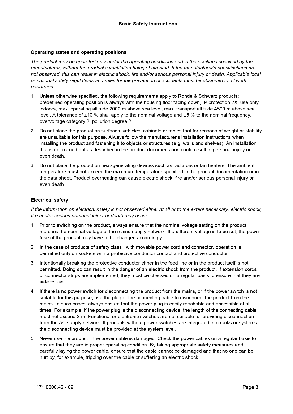

Basic Safety Instructions. Operating states and operating positions. Electrical safety
Basic Safety Instructions Operating states and operating positions Electrical safety
The product may be operated only under the operating conditions and in the positions specified by the manufacturer, without the product's ventilation being obstructed. If the manufacturer's specifications are not observed, this can result in electric shock, fire and/or serious personal injury or death. Applicable local or national safety regulations and rules for the prevention of accidents must be observed in all work performed. 1. Unless otherwise specified, the following requirements apply to Rohde & Schwarz products: predefined operating position is always with the housing floor facing down, IP protection 2X, use only indoors, max. operating altitude 2000 m above sea level, max. transport altitude 4500 m above sea level. A tolerance of ±10 % shal apply to the nominal voltage and ±5 % to the nominal frequency, overvoltage category 2, pol ution degree 2. 2. Do not place the product on surfaces, vehicles, cabinets or tables that for reasons of weight or stability are unsuitable for this purpose. Always follow the manufacturer's installation instructions when instal ing the product and fastening it to objects or structures (e.g. walls and shelves). An installation that is not carried out as described in the product documentation could result in personal injury or even death. 3. Do not place the product on heat-generating devices such as radiators or fan heaters. The ambient temperature must not exceed the maximum temperature specified in the product documentation or in the data sheet. Product overheating can cause electric shock, fire and/or serious personal injury or even death.
Electrical safety
If the information on electrical safety is not observed either at all or to the extent necessary, electric shock, fire and/or serious personal injury or death may occur. 1. Prior to switching on the product, always ensure that the nominal voltage setting on the product matches the nominal voltage of the mains-supply network. If a different voltage is to be set, the power fuse of the product may have to be changed accordingly. 2. In the case of products of safety class I with movable power cord and connector, operation is permitted only on sockets with a protective conductor contact and protective conductor. 3. Intentional y breaking the protective conductor either in the feed line or in the product itself is not permitted. Doing so can result in the danger of an electric shock from the product. If extension cords or connector strips are implemented, they must be checked on a regular basis to ensure that they are safe to use. 4. If there is no power switch for disconnecting the product from the mains, or if the power switch is not suitable for this purpose, use the plug of the connecting cable to disconnect the product from the mains. In such cases, always ensure that the power plug is easily reachable and accessible at al times. For example, if the power plug is the disconnecting device, the length of the connecting cable must not exceed 3 m. Functional or electronic switches are not suitable for providing disconnection from the AC supply network. If products without power switches are integrated into racks or systems, the disconnecting device must be provided at the system level. 5. Never use the product if the power cable is damaged. Check the power cables on a regular basis to ensure that they are in proper operating condition. By taking appropriate safety measures and carefully laying the power cable, ensure that the cable cannot be damaged and that no one can be hurt by, for example, tripping over the cable or suffering an electric shock. 1171.0000.42 - 09 Page 3 Document Outline Cover Basic Safety Instructions Customer Support Contents 1 Preface 1.1 Key Features 1.2 Documentation Overview 1.2.1 Manuals and Instrument Help 1.2.2 Data Sheet and Brochure 1.2.3 Release Notes, Open Source Acknowledgment 1.2.4 Calibration Certificate 1.2.5 Application notes, Application cards, Videos 1.3 Options Described in this Document 1.4 Conventions Used in the Documentation 1.4.1 Typographical Conventions 1.4.2 Conventions for Procedure Descriptions 2 Getting Started 2.1 Preparing for Use 2.1.1 Unpacking and Checking the Instrument 2.1.2 Positioning the Instrument 2.1.2.1 Bench Top Operation 2.1.2.2 Rackmounting 2.1.3 Starting the Instrument 2.1.3.1 Powering On 2.1.3.2 Starting Up and Shutting Down 2.1.3.3 Powering Off 2.1.3.4 EMI Suppression 2.1.4 Connecting External Devices 2.1.4.1 Connecting USB Devices 2.1.4.2 Connecting an External Monitor 2.2 Instrument Tour 2.2.1 Front Panel 2.2.1.1 Input Connectors 2.2.1.2 Other Front Panel Connectors 2.2.2 Rear Panel 2.2.3 Keys and Controls 2.2.3.1 SETUP Controls 2.2.3.2 HORIZONTAL Controls 2.2.3.3 VERTICAL Controls 2.2.3.4 TRIGGER Controls 2.2.3.5 ANALYSIS Keys 2.2.3.6 NAVIGATION Controls 2.2.3.7 POWER Key 2.3 Trying Out the Instrument 2.3.1 Displaying a Basic Signal 2.3.2 Acquiring Data 2.3.3 Changing the Waveform Scaling and Position 2.3.4 Zooming into the Display 2.3.4.1 Using the Standard Zoom 2.3.4.2 Using the Fingertip Zoom 2.3.5 Displaying the Waveform History 2.3.6 Showing Basic Measurement Results 2.3.6.1 Performing a Cursor Measurement 2.3.6.2 Performing Automatic Amplitude Measurements 2.3.6.3 Performing and Configuring the Quick Measurement 2.3.6.4 Displaying a Histogram 2.3.7 Performing a Basic FFT Analysis 2.3.8 Performing Mathematical Calculations 2.3.9 Performing a Search 2.3.10 Performing a Mask Test 2.3.11 Printing and Saving Screenshots 2.3.12 Saving Data 2.4 Operating the Instrument 2.4.1 Means of Manual Interaction 2.4.2 Touchscreen Display 2.4.2.1 Information on the Display 2.4.2.2 Control Elements on the Touchscreen 2.4.3 App Cockpit 2.4.4 Working with Waveforms 2.4.5 Using the Signal bar 2.4.6 Toolbar 2.4.6.1 Using the Toolbar 2.4.6.2 Configuring the Toolbar 2.4.6.3 Toolbar Functions 2.4.7 Displaying Results 2.4.8 Using Dialog Boxes 2.4.9 Entering Data 2.4.10 Messages 2.4.11 Getting Information and Help 2.4.11.1 Displaying Tutorials 2.4.11.2 Displaying Help 2.4.11.3 Using the Help Window 3 Instrument Setup 3.1 System Setup 3.1.1 System Settings 3.1.2 Setting the Display Language 3.2 Screen Setup 3.2.1 Screen Settings 3.2.2 Aligning the Touchscreen 3.3 Frontpanel Setup 3.3.1 Setup: Luminosity Settings 3.3.2 Hardkeys: Function Assignment 3.3.3 Knobs 3.4 Display Configuration 3.4.1 Adjustable Display Elements 3.4.2 Display Settings 3.4.2.1 Colors / Persistence 3.4.2.2 Color Tables 3.4.2.3 Diagram Layout 3.4.2.4 Waveform Labels 3.4.2.5 Performance 3.4.2.6 Clear Screen Results 3.4.3 Adjusting the Display 3.4.3.1 Editing Waveform Colors 3.4.3.2 Using the Signal bar 3.4.3.3 Configuring the Toolbar 3.4.3.4 Configuring Dialog Boxes and Result Boxes 3.5 Self-Alignment 3.5.1 Control 3.5.2 Results 3.5.3 Performing a Self-alignment 3.6 Options 3.6.1 SW Options 3.6.1.1 Active Options Settings 3.6.1.2 Deactivation Options 3.6.2 HW Options 3.6.3 Activating Options 3.6.4 Moving a Portable License 3.6.5 Options in Beta State 4 Acquisition and Waveform Setup 4.1 Basics 4.1.1 Vertical System 4.1.1.1 Input Coupling 4.1.1.2 Vertical Scale and Position 4.1.1.3 Bandwidth 4.1.2 Sampling and Acquisition 4.1.2.1 Sampling and Processing 4.1.2.2 Acquisition Settings 4.1.2.3 Acquisition Control 4.1.3 Horizontal System 4.1.3.1 Parameters of the Horizontal System 4.1.3.2 Horizontal Position 4.1.4 Probes 4.1.4.1 Voltage Probes Passive voltage probes Active voltage probes - General Differential Active Probes 4.2 Horizontal Settings 4.2.1 Setup 4.2.2 Acquisition 4.2.3 Ultra Segmentation 4.3 Vertical Settings 4.3.1 Channels 4.3.2 Coupled Channels 4.3.3 Power Calculation 4.4 High Definition Mode 4.4.1 High Definition Settings 4.4.2 Effects of the High Definition Mode 4.5 Probes 4.5.1 Shared Probe Settings 4.5.2 Settings for the R&S Probe Interface (Voltage Probes) 4.5.3 Setup for Passive Probes 4.5.4 Setup for Active Voltage Probes 4.5.4.1 R&S RT-ZS Single-Ended Probes 4.5.4.2 R&S RT-ZD Differential Probes 4.5.4.3 R&S RT-ZPR Power Rail Probes 4.5.4.4 R&S RT-ZHD High-Voltage Differential Probes 4.5.5 Setup for Modular Probes 4.5.6 Setup for Predefined Probes 4.5.7 Setup for Current Probes 4.5.8 Setup for Unknown Probes 4.5.9 Probe Attributes 4.5.10 Calibration Results 4.6 R&S RT-ZVC Probe 4.6.1 R&S RT-ZVC Overview 4.6.1.1 Setup 4.6.1.2 Probes 4.6.1.3 Power Calculation 4.6.2 ZVC Voltage Setup Settings 4.6.3 ZVC Current Setup Settings 4.7 Digital Filter Setup 4.8 Horizontal Accuracy 4.8.1 Reference Clock 4.8.2 Skew 4.9 Setting Up the Waveform 4.9.1 Adjusting Passive Probes 4.9.2 Setting Up the Signal Input with Autoset 4.9.3 Adjusting the Signal Input Manually 4.9.4 Setting the Acquisition 4.9.5 Starting and Stopping Acquisition 4.9.6 Using the Roll Mode 4.9.7 Using Ultra Segmentation 4.9.8 Using Digital Filters 5 Triggers 5.1 Basics of Triggering 5.2 Setting Up the Trigger 5.2.1 Configuring a Simple Trigger 5.2.2 Positioning the Trigger 5.2.3 Using Holdoff 5.2.4 Setting Up a Trigger Sequence 5.3 Trigger Types 5.3.1 Basic Trigger Settings 5.3.2 Edge 5.3.3 Analog Edge 5.3.4 Glitch 5.3.5 Width 5.3.6 Runt 5.3.7 Window 5.3.8 Timeout 5.3.9 Interval 5.3.10 Slew Rate 5.3.11 Data2Clock 5.3.12 State 5.3.13 Pattern 5.3.14 Serial Pattern 5.3.15 TV/Video Trigger 5.3.16 Line Trigger 5.3.17 Triggering on Serial Buses 5.3.18 Triggering on Parallel Buses and Digital Channels 5.4 Holdoff 5.5 Noise Reject 5.6 Control / Action 5.7 Sequence 5.7.1 B-Trigger Setup 5.8 Extern 5.9 Acquisition Info 6 Waveform Analysis 6.1 Zoom 6.1.1 Methods of Zooming 6.1.2 Zoom Settings 6.1.2.1 Zoom Functions on the Toolbar 6.1.2.2 Start and Stop Settings 6.1.2.3 Position and Range Settings 6.1.3 Zooming for Details 6.2 Reference Waveforms 6.2.1 Working with Reference Waveforms 6.2.2 Settings for Reference Waveforms 6.2.2.1 Reference Waveform Setup 6.2.2.2 Scaling 6.3 Mathematics 6.3.1 Displaying Math Waveforms 6.3.2 Basic Editor 6.3.2.1 Settings in the Basic Editor 6.3.2.2 Defining a Formula in the Basic Editor 6.3.3 Advanced Expressions 6.3.3.1 Advanced Formula Editor 6.3.3.2 Defining a Formula in the Advanced Formula Editor 6.3.4 Math Setup - General Settings 6.4 History 6.4.1 About History 6.4.2 History Setup 6.4.2.1 Viewer 6.4.2.2 Information 6.4.3 Using History 6.5 XY-diagram 6.5.1 Settings for XY-Diagrams 6.5.2 Displaying an XY-diagram 7 Measurements 7.1 Cursor measurements 7.1.1 Cursors and Results of Cursor Measurements 7.1.1.1 Cursor Measurements on Time Based Waveforms 7.1.1.2 Cursor Measurements on Spectrum Waveforms 7.1.2 Performing Cursor Measurements 7.1.2.1 Performing a Simple Cursor Measurement 7.1.2.2 Configuring a Cursor Measurement 7.1.2.3 Configuring the Cursor Display 7.1.3 Settings for Cursor Measurements 7.1.3.1 Cursor Setup 7.1.3.2 Cursor Labels 7.1.3.3 Peak Search 7.2 Automatic Measurements 7.2.1 Measurement Setup in General 7.2.1.1 General Measurement Settings 7.2.1.2 Starting an Automatic Measurement 7.2.1.3 Configuring Measurements 7.2.2 Measurement Results 7.2.2.1 Measurement Status 7.2.2.2 Result Display Settings 7.2.2.3 Configuring the Results Display 7.2.3 Measurement Gates 7.2.3.1 Gate Settings for Measurements 7.2.3.2 Using Measurement Gates 7.2.4 Reference Levels 7.2.4.1 Level Settings 7.2.4.2 Configuring Reference Levels 7.2.5 Amplitude/Time Measurements 7.2.5.1 Amplitude/Time Measurement Types Amplitude Measurements Time Measurements Area Measurements Counting 7.2.5.2 Amplitude/Time Measurement Settings 7.2.5.3 Measuring the Delay to Trigger 7.2.6 Eye Diagram Measurements 7.2.6.1 Eye Diagram Measurement Types 7.2.6.2 Eye Diagram Measurement Settings 7.2.7 Spectrum Measurements 7.2.7.1 Spectrum Measurement Types 7.2.7.2 Spectrum Measurement Settings 7.2.8 Histograms and Histogram Measurements 7.2.8.1 Histogram Characteristics and Measurement Types 7.2.8.2 Histogram Setup 7.2.8.3 Histogram Measurement Settings 7.2.8.4 Creating a Histogram 7.2.9 Long Term Measurements and Statistics 7.2.9.1 About Long Term Measurements and Statistics 7.2.9.2 Long Term/Track Settings 7.2.9.3 Horizontal Long Term Scaling 7.2.9.4 Performing Long-term Measurements 7.2.9.5 Compiling Measurement Statistics 7.2.10 Protocol Measurements 7.3 Quick Measurements 7.3.1 Starting Quick Measurement 7.3.2 Quick Measurement Settings 7.3.3 Configuring the Quick Measurement 8 Spectrum Analysis 8.1 FFT Analysis 8.1.1 Fundamentals of FFT Analysis 8.1.2 Configuring Spectrum Waveforms 8.1.3 FFT Configuration Settings 8.1.3.1 FFT Setup 8.1.3.2 FFT Overlap 8.1.3.3 FFT Gating 8.1.3.4 FFT Y-Units 8.1.3.5 FFT Coupling 8.2 Spectrum Analysis (Option R&S RTE-K18) 8.2.1 Spectrogram Display 8.2.2 Spectrum Analysis Functions 8.2.3 Configuring Spectrograms 8.2.4 Spectrogram Configuration Settings 9 Mask Testing 9.1 About Mask Testing 9.1.1 Results of a Mask Test 9.2 Mask Test Settings 9.2.1 Test Definition 9.2.2 Mask Definition 9.2.2.1 Mask Definition: User Mask 9.2.2.2 Mask Definition: Waveform Mask 9.2.3 Event Actions /Reset 9.2.4 Mask Display 9.3 Working with Masks 9.3.1 Setting Up User Masks 9.3.1.1 Creating User Masks 9.3.1.2 Modifying User Masks 9.3.2 Setting Up a Mask Test 9.3.3 Configuring the Mask and Hit Display 9.3.4 Running a Mask Test 9.3.5 Saving and Loading Masks 9.3.6 Mask Testing on History Acquisitions 10 Search Functions 10.1 Overview: Search Definition and Results 10.1.1 Search Definition 10.1.2 Search Results 10.2 Search Setup 10.2.1 Search Criteria 10.2.2 Search Parameters 10.2.2.1 Edge 10.2.2.2 Glitch 10.2.2.3 Width 10.2.2.4 Runt 10.2.2.5 Window 10.2.2.6 Timeout 10.2.2.7 Interval 10.2.2.8 Slew Rate 10.2.2.9 Data2Clock 10.2.2.10 State 10.2.2.11 Pattern 10.2.3 Frequency Marker Search 10.2.4 Configuring the Search Setup 10.3 Search Gate 10.3.1 Gate Settings 10.3.2 Defining the Search Gate 10.4 Result Presentation 10.4.1 Result Presentation Settings 10.4.2 Configuring the Search Results Presentation 10.5 Noise Reject 10.5.1 Noise Reject Settings 10.5.2 Defining Noise Rejection for Searches 11 Data and File Management 11.1 Instrument Settings 11.1.1 Savesets 11.1.1.1 Settings 11.1.1.2 Load Saveset Function 11.1.1.3 Saving and Loading Settings 11.1.2 User Preferences 11.1.3 User-defined Preset 11.1.4 User-defined Preset - Settings 11.1.5 Restoring Settings 11.2 Waveforms and Results 11.2.1 Waveform Export Files 11.2.1.1 Header Files 11.2.1.2 Waveform Data Files 11.2.1.3 Number of Samples in the Export File 11.2.2 Waveforms - Export Settings 11.2.3 Waveform Histograms 11.2.4 Numeric Results 11.2.5 Long Term / Track 11.2.6 Saving and Loading Waveform Data 11.3 Screenshots 11.3.1 Screenshot Settings 11.3.2 Printing Screenshots 11.3.3 Configuring and Saving Screenshots 11.4 Reports 11.4.1 Report Settings 11.5 Autonaming 11.5.1 Autonaming Settings 11.5.2 Defining Default File Paths and Names 11.6 File Selection Dialog 12 Protocol Analysis 12.1 Basics of Protocol Analysis 12.1.1 Configuration - General Settings 12.1.2 Display 12.1.3 Label Lists 12.1.3.1 Content and Format of the PTT File 12.1.3.2 Label List - General Settings 12.1.4 Bit Pattern Editor 12.2 I²C (Option R&S RTE-K1) 12.2.1 The I²C Protocol 12.2.2 I²C Configuration 12.2.2.1 I²C Configuration Settings 12.2.2.2 Configuring I²C Protocol 12.2.3 I²C Trigger 12.2.3.1 I²C Trigger Settings 12.2.3.2 Triggering on I²C Signals 12.2.4 I2C Label List 12.2.5 I²C Decode Results 12.2.6 Search on Decoded I²C Data 12.2.6.1 I²C Search Setup 12.2.6.2 I²C Search Results 12.3 SPI Bus (Option R&S RTE-K1) 12.3.1 The SPI Protocol 12.3.2 SPI Configuration 12.3.2.1 SPI Configuration Settings 12.3.2.2 Configuring SPI Signals 12.3.3 SPI Trigger 12.3.3.1 SPI Trigger 12.3.3.2 Triggering on SPI 12.3.4 SPI Decode Results 12.3.5 Search on Decoded SPI Data 12.3.5.1 SPI Search Setup 12.3.5.2 SPI Search Results 12.4 UART / RS232 (Option R&S RTE-K2) 12.4.1 The UART / RS232 Interface 12.4.2 UART Configuration 12.4.3 UART Trigger 12.4.4 UART Decode Results 12.5 CAN and CAN FD (Options R&S RTE-K3 and -K9) 12.5.1 CAN and CAN-FD Configuration 12.5.2 CAN / CAN FD Trigger 12.5.2.1 Trigger Settings 12.5.2.2 Triggering on CAN FD Data 12.5.3 CAN / CAN FD Label List 12.5.3.1 DBC files for CAN / CAN FD 12.5.3.2 PTT and CSV Files for CAN / CAN FD 12.5.4 CAN and CAN FD Decode Results 12.5.5 Search on Decoded CAN or CAN FD Data 12.5.5.1 Search Settings 12.5.5.2 Search Results 12.5.5.3 Searching CAN FD Data 12.5.6 Symbolic Trigger, Decode and Search 12.5.6.1 Symbolic Trigger 12.5.6.2 Symbolic Decode Waveform 12.5.6.3 Symbolic Search 12.5.6.4 Symbolic Search Results 12.6 LIN (Option R&S RTE-K3) 12.6.1 The LIN Protocol 12.6.2 LIN Configuration 12.6.3 LIN Trigger 12.6.4 LIN Label List 12.6.5 LIN Decode Results 12.6.6 Search on Decoded LIN Data 12.6.6.1 LIN Search Setup 12.6.6.2 LIN Search Results 12.7 FlexRay (Option R&S RTE-K4) 12.7.1 FlexRay Configuration 12.7.2 FlexRay Trigger 12.7.3 FlexRay Label List 12.7.4 FlexRay Decode Results 12.7.5 Search on Decoded FlexRay Data 12.7.5.1 FlexRay Search Setup 12.7.5.2 FlexRay Search Results 12.8 Audio Signals (Option R&S RTE-K5) 12.8.1 Audio Protocols 12.8.1.1 I²S Standard 12.8.1.2 Left Justified Data Format 12.8.1.3 Right Justified Data Format 12.8.1.4 TDM 12.8.2 Audio Signal Configuration 12.8.3 Audio Trigger 12.8.4 Audio Decode Results 12.8.5 Track and Trend 12.8.5.1 Track Displaying and Configuring a Track Track Settings in Protocol Setup Track and Trend Settings in Measurement Setup Track Enabling in Measurement Setup 12.8.5.2 Trend Displaying and Configuring the Trend 12.9 MIL-1553 (Option R&S RTE-K6) 12.9.1 The MIL-STD-1553 12.9.2 MIL-STD-1553 Configuration 12.9.2.1 MIL-STD-1553 Configuration Settings 12.9.2.2 Configuring MIL-STD-1553 12.9.3 MIL-STD-1553 Trigger 12.9.3.1 Trigger Settings MIL-STD-1553 12.9.3.2 Triggering on MIL-STD-1553 12.9.4 MIL-STD-1553 Label List 12.9.5 MIL-STD-1553 Decode Results 12.9.6 Search on Decoded MIL Data 12.9.6.1 MIL Search Setup 12.9.6.2 MIL Search Results 12.10 ARINC 429 (Option R&S RTE-K7) 12.10.1 ARINC 429 Basics 12.10.2 ARINC 429 Configuration 12.10.2.1 ARINC 429 Configuration Settings 12.10.2.2 Configuring ARINC 429 Signals 12.10.3 ARINC 429 Trigger 12.10.3.1 Triggering on ARINC 429 12.10.3.2 ARINC 429 Trigger Settings 12.10.4 ARINC 429 Label List 12.10.5 ARINC 429 Decode Results 12.10.6 Search on Decoded ARINC 429 Data 12.10.6.1 ARINC 429 Search Setup 12.10.6.2 ARINC Search Results 12.11 Ethernet 10BASE-T and 100BASE-TX (Option R&S RTE-K8) 12.11.1 The Ethernet Protocol 12.11.2 Ethernet Configuration 12.11.2.1 Ethernet Configuration Settings 12.11.2.2 Ethernet Display Settings 12.11.2.3 Configuring Ethernet Signals 12.11.3 Ethernet Label List 12.11.4 Ethernet Decode Results 12.11.5 Search on Decoded Ethernet Data 12.11.5.1 Ethernet Search Setup 12.11.5.2 Ethernet Search Results 12.11.5.3 Searching Ethernet Data 12.12 Ethernet 100BASE-T1 (Option R&S RTE-K57) 12.12.1 100BASE-T1 Basics 12.12.2 100BASE-T1 Configuration 12.12.2.1 100BASE-T1 Configuration Settings 12.12.2.2 100BASE-T1 Display Settings 12.12.2.3 Configuring 100BASE-T1 Signals 12.12.3 100BASE-T1 Trigger 12.12.3.1 100BASE-T1 Trigger Settings 12.12.3.2 Triggering on 100BASE-T1 12.12.4 100BASE-T1 Label List 12.12.5 100BASE-T1 Decode Results 12.12.6 Search on Decoded 100BASE-T1 Data 12.12.6.1 100BASE-T1 Search Setup 12.12.6.2 100BASE-T1 Search Results 12.12.6.3 Searching 100BASE-T1 Data 12.13 SENT (Option R&S RTE-K10) 12.13.1 The SENT Protocol 12.13.1.1 SENT Transmission Concept 12.13.1.2 SENT Message Definitions SENT Fast Channel SENT Slow Channel Trigger 12.13.2 SENT Configuration 12.13.3 SENT Trigger 12.13.4 SENT Label List 12.13.4.1 SENT Label List Translation Example 12.13.5 SENT Decode Results 12.13.6 Search on Decoded SENT Data 12.13.6.1 SENT Search Setup 12.13.6.2 SENT Search Results 12.14 Custom: Manchester / NRZ (Option R&S RTE-K50) 12.14.1 Custom: Manchester / NRZ Protocols 12.14.1.1 Special Features of Manchester Coding 12.14.2 Custom: Manchester / NRZ Configuration 12.14.2.1 Custom: Manchester / NRZ Configuration Settings 12.14.2.2 Frame Format Configuration 12.14.2.3 XML Syntax 12.14.2.4 Custom: Manchester / NRZ Display Settings 12.14.2.5 Configuring Custom Manchester / NRZ Signals 12.14.3 Custom: Manchester / NRZ Trigger 12.14.3.1 Custom: Manchester / NRZ Trigger Settings 12.14.3.2 Triggering on Custom Manchester / NRZ Serial Bus 12.14.4 Custom: Manchester / NRZ Decode Results 12.14.5 Search on Decoded Custom Manchester / NRZ Data 12.14.5.1 Custom Manchester / NRZ Search Setup 12.14.5.2 Searching Custom Serial Bus Data 12.15 MDIO (Option R&S RTE-K55) 12.15.1 The MDIO Protocol 12.15.2 MDIO Configuration 12.15.2.1 MDIO Configuration Settings 12.15.2.2 MDIO Display Settings 12.15.2.3 Configuring MDIO Signals 12.15.3 MDIO Trigger 12.15.3.1 MDIO Trigger Settings 12.15.3.2 Triggering on MDIO 12.15.4 MDIO Label List 12.15.5 MDIO Decode Results 12.15.6 Search on Decoded MDIO Data 12.15.6.1 MDIO Search Setup 12.15.6.2 MDIO Search Results 12.15.6.3 Searching MDIO Data 12.16 USB (Option R&S RTE-K60) 12.16.1 The USB Protocol 12.16.2 USB Configuration 12.16.2.1 USB Configuration Settings 12.16.2.2 Configuring USB Signals 12.16.3 USB Trigger 12.16.3.1 USB Trigger Settings 12.16.3.2 Triggering on USB 12.16.4 USB Decode Results 12.16.5 Search on Decoded USB Data 12.16.5.1 USB Search Setup 12.16.5.2 USB Search Results 12.16.5.3 Searching USB Data 12.17 USBPD (Option R&S RTE-K63) 12.17.1 The USB Power Delivery Protocol 12.17.2 USBPD Configuration 12.17.2.1 USBPD Configuration Settings 12.17.2.2 Display Settings 12.17.2.3 Configuring the USBPD Signals 12.17.3 USBPD Trigger 12.17.3.1 USBPD Trigger Settings 12.17.3.2 Triggering on USBPD 12.17.4 USBPD Decode Results 12.17.5 Search on Decoded USBPD Data 12.17.5.1 USBPD Search Setup 12.17.5.2 USBPD Search Results 12.17.5.3 Searching USBPD Data 12.18 SpaceWire (Option R&S RTE-K65) 12.18.1 SpaceWire Basic 12.18.2 SpaceWire Configuration 12.18.2.1 SpaceWire Configuration Settings 12.18.2.2 Display Settings 12.18.2.3 Configuring the SpaceWire Signals 12.18.3 SpaceWire Trigger 12.18.3.1 SpaceWire Trigger Settings 12.18.3.2 Triggering on SpaceWire 12.18.4 SpaceWire Decode Results 12.18.5 Search on Decoded SpaceWire Data 12.18.5.1 SpaceWire Search Setup 12.18.5.2 SpaceWire Search Results 12.18.5.3 Searching SpaceWire 12.19 CXPI (Option R&S RTE-K76) 12.19.1 The CXPI Protocol 12.19.2 CXPI Configuration 12.19.2.1 CXPI Configuration Settings 12.19.2.2 Display Settings 12.19.2.3 Configuring the CXPI Signals 12.19.3 CXPI Trigger 12.19.3.1 CXPI Trigger Settings 12.19.3.2 Triggering on CXPI 12.19.4 Search on Decoded CXPI Data 12.19.4.1 Search Settings 12.19.4.2 Search Results 12.19.4.3 Searching CXPI Data 12.19.5 CXPI Decode Results 13 Power Analysis (Option R&S RTE-K31) 13.1 Power Measurement Selection 13.1.1 General Settings 13.1.1.1 Auto Deskew Probes Settings 13.1.1.2 DUT 13.1.1.3 Report Test Results Layout Content 13.2 Overview of Power Measurement Setup 13.2.1 Channels Tab 13.2.2 Settings Tab 13.2.3 Details Tab 13.3 Power Quality 13.3.1 Power Quality Results 13.3.2 Configuring Power Quality 13.3.3 Power Quality Settings 13.4 Inrush Current 13.4.1 Inrush Current Results 13.4.2 Configuring Inrush Current 13.4.3 Inrush Current Settings 13.5 Current Harmonic 13.5.1 Current Harmonic Results 13.5.2 Configuring Current Harmonic 13.5.3 Current Harmonic Settings 13.6 Modulation Analysis 13.6.1 Modulation Analysis Results 13.6.2 Configuring Modulation Analysis 13.6.3 Modulation Analysis Settings 13.7 Dynamic On Resistance 13.7.1 Dynamic On Resistance Results 13.7.2 Configuring Dynamic On Resistance 13.7.3 Dynamic On Resistance Settings 13.8 Slew Rate 13.8.1 Slew Rate Results 13.8.2 Configuring Slew Rate 13.8.3 Slew Rate Settings 13.9 Safe Operating Area (S.O.A.) 13.9.1 Safe Operating Area Results 13.9.2 Configuring Safe Operating Area 13.9.3 Safe Operating Area Settings 13.10 Turn On/ Off 13.10.1 Turn On/ Off Results 13.10.2 Configuring Turn On/ Off 13.10.3 Turn On/ Off Settings 13.11 Switching Loss 13.11.1 Switching Loss Results 13.11.2 Configuring Switching Loss 13.11.3 Switching Loss Settings 13.12 Power Efficiency 13.12.1 Power Efficiency Results 13.12.2 Configuring Power Efficiency 13.12.3 Power Efficiency Settings 13.13 Output Ripple 13.13.1 Output Ripple Results 13.13.2 Configuring Output Ripple 13.13.3 Output Ripple Settings 13.14 Transient Response 13.14.1 Transient Response Results 13.14.2 Configuring Transient Response 13.14.3 Transient Response Settings 13.15 Output Spectrum 13.15.1 Output Spectrum Results 13.15.2 Configuring Output Spectrum 13.15.3 Output Spectrum Settings 14 Mixed Signal Option (MSO, R&S RTE-B1) 14.1 Digital channels and parallel buses 14.1.1 Parallel Buses - Configuration 14.1.2 Parallel Buses - Digital Probes 14.1.3 Digital Resolution 14.1.4 Using Digital Probes 14.1.5 Configuring Digital Channels and Parallel Buses 14.1.6 Setting the Logical Thresholds 14.2 Display 14.2.1 Parallel Bus - Decode Table 14.2.2 Adjusting the Display of Digital Channels and Parallel Buses 14.3 Trigger 14.3.1 Trigger Settings for Digital Signals and Parallel Buses 14.3.1.1 Basic Trigger Settings 14.3.1.2 Edge 14.3.1.3 Width 14.3.1.4 Timeout 14.3.1.5 Data2Clock 14.3.1.6 State 14.3.1.7 Pattern 14.3.1.8 Serial Pattern 14.3.2 Triggering on Digital Signals and Parallel Buses 14.4 Measurements on Digital Channels 14.5 Data export 14.6 Mathematics 14.7 Search 15 Waveform Generator (Option R&S RTE-B6) 15.1 Setup of the Waveform Generator 15.1.1 General Settings 15.1.2 Function Generator 15.1.3 Modulation 15.1.3.1 General Settings 15.1.3.2 AM Modulation 15.1.3.3 PWM Modulation 15.1.3.4 FM Modulation 15.1.3.5 FSK Modulation 15.1.4 Sweep 15.1.5 Arbitrary 15.1.5.1 General Settings 15.1.5.2 Saved Waveform 15.1.5.3 Scope Waveform 15.1.6 Output 15.1.7 Noise 15.2 Setup of the Pattern Generator 15.3 Coupling and Sync Settings 15.4 Configuring the Waveform Generator 15.4.1 Configuring a Function Waveform 15.4.2 Configuring a Modulation Waveform 15.4.3 Configuring a Sweep Waveform 15.4.4 Configuring an Arbitrary Waveform 15.4.5 Configuring a Pattern Generator Waveform 15.5 DC Offset Alignment 16 Network and Remote Operation 16.1 Operating System 16.1.1 Virus Protection 16.1.2 Service Packs and Updates 16.1.3 Logon 16.1.4 Accessing Windows functionality 16.2 Setting Up a Network (LAN) Connection 16.2.1 Connecting the Instrument to the Network 16.2.2 Assigning the IP Address 16.2.3 Using Computer Names 16.2.4 Changing the Windows Firewall Settings 16.3 Web Interface (LXI) 16.3.1 LXI Settings on the R&S RTE 16.3.2 LXI Web Browser 16.3.2.1 LAN Configuration IP Configuration Advanced Config Ping Client 16.3.2.2 Web Control 16.3.2.3 Device Screenshot 16.4 Remote Desktop Connection 16.5 Remote Control Interfaces and Protocols 16.5.1 VISA Libraries 16.5.2 LAN Interface 16.5.2.1 IP address 16.5.2.2 VXI-11 Protocol 16.5.2.3 HiSLIP Protocol 16.5.3 GPIB Interface (IEC/IEEE Bus Interface) 16.5.3.1 GPIB Instrument Address 16.6 Remote Settings 16.7 Starting and Stopping Remote Control 16.7.1 Starting a Remote Control Session 16.7.2 Using the display during remote control 16.7.3 Returning to Manual Operation 17 Remote Control Commands 17.1 Conventions used in Remote Command Description 17.2 Finding the Appropriate Command 17.3 Programming Examples 17.3.1 Display 17.3.1.1 Creating Zoom Diagrams 17.3.2 Automatic Measurements 17.3.2.1 Performing Amplitude/Time Measurements Simple Frequency and Amplitude Measurement 17.3.2.2 Setting Reference Levels Manual reference level definition using relative values Manual reference level definition using absolute values 17.3.2.3 Waveform Histograms Creating and Reading Histograms Exporting Histogram Data to File Transferring Histogram Data 17.3.2.4 Long Term Measurements Exporting Long Term Measurement Data to File Transferring Long Term Measurement Data 17.3.3 Mask Testing 17.3.3.1 Creating a user mask 17.3.4 Search 17.3.4.1 Searching for a pulse of specified width 17.3.5 Data Management 17.3.5.1 Saving a Screenshot to File 17.3.5.2 Exporting Waveform Data to File Exporting a Single Waveform to XML File Exporting Raw Data of a Single Waveform to BIN File Exporting Raw Data of a Measurement Gate to BIN File Exporting Interleaved x/y Data of a Single Waveform to CSV File Exporting Interleaved x/y Data of a Zoom to CSV File Exporting Multiple Running Acquisitions of a Single Waveform to XML File Exporting a Single Acquisition of the History to BIN File Exporting Multiple Acquisition of the History to XML File 17.3.5.3 Exporting Measurement Results to File 17.3.6 Protocol Analysis 17.3.6.1 SENT (Option R&S RTE-K10) Configuring SENT Bus Triggering on SENT Bus Searching SENT Data 17.3.7 Power Analysis (Option R&S RTE-K31) 17.3.7.1 Auto Deskew 17.3.7.2 Transient Response Measurement 17.4 Frequently Used Parameters and Suffixes 17.4.1 Waveform Suffix 17.4.2 Waveform Parameter 17.4.3 Slope Parameter 17.4.4 Polarity Parameter 17.4.5 Event Parameter 17.4.6 Bit Pattern Parameter 17.5 Common Commands 17.6 General Remote Settings 17.7 Instrument Setup 17.7.1 System Setup 17.7.2 Display Settings 17.7.2.1 Signal Colors / Persistence 17.7.2.2 Color Tables 17.7.2.3 Diagram Layout 17.7.2.4 Waveform Labels 17.8 Acquisition and Setup 17.8.1 Starting and Stopping Acquisition 17.8.2 Time Base 17.8.3 Acquisition 17.8.4 Ultra Segmentation 17.8.5 Vertical 17.8.6 Waveform Data 17.8.7 Probes 17.8.7.1 Common Probe Settings 17.8.7.2 Micro Button and R&S ProbeMeter 17.8.7.3 Passive Probes 17.8.7.4 Active Voltage Probes 17.8.7.5 Modular Probes 17.8.7.6 Predefined Probes 17.8.7.7 Current Probes 17.8.7.8 Probe Attributes 17.8.8 R&S RT-ZVC Probe 17.8.8.1 Probe Setup 17.8.8.2 Resolution 17.8.9 Digital Filter 17.8.10 Skew 17.8.11 AUX OUT 17.8.12 High Definition Mode 17.8.13 Reference Clock 17.9 Trigger 17.9.1 Basic Trigger Settings 17.9.2 Edge Trigger 17.9.3 Glitch Trigger 17.9.4 Width Trigger 17.9.5 Runt Trigger 17.9.6 Window Trigger 17.9.7 Timeout Trigger 17.9.8 Interval Trigger 17.9.9 Slew Rate Trigger 17.9.10 Data2Clock Trigger 17.9.11 State Trigger 17.9.12 Pattern Trigger 17.9.13 Serial Pattern Trigger 17.9.14 TV/Video Trigger 17.9.15 Line Trigger 17.9.16 Holdoff 17.9.17 Noise Reject 17.9.18 Trigger Sequence 17.9.19 Trigger Control 17.9.20 Actions on Trigger 17.9.21 External Trigger Input 17.9.22 Acquisition Info 17.10 Waveform Analysis 17.10.1 Zoom 17.10.2 Reference Waveforms 17.10.2.1 Reference 17.10.2.2 Scaling 17.10.2.3 Waveform Data Export 17.10.2.4 Import of Multichannel Waveform Data 17.10.3 Mathematics 17.10.4 History 17.10.5 XY-Diagram 17.11 Cursor Measurements 17.12 Automatic Measurements 17.12.1 General Settings 17.12.2 Results 17.12.3 Amplitude/Time Measurement 17.12.4 Eye Diagram Measurements 17.12.5 Spectrum 17.12.6 Histograms 17.12.6.1 Histogram Display 17.12.6.2 Histogram Measurement 17.12.7 Display 17.12.8 Statistics and Long-term Measurements 17.12.9 Track and Trend 17.12.10 Gating 17.12.11 Reference Levels 17.12.11.1 General Reference Level Settings 17.12.11.2 Automatic Configuration 17.12.11.3 Manual Configuration 17.12.11.4 Results 17.13 Spectrum Analysis 17.13.1 Basic FFT 17.13.2 Waveform Data 17.13.3 Spectrum Analysis (Option R&S RTE-K18) 17.14 Mask Testing 17.14.1 Mask Test Definition 17.14.2 Mask Definition: User Mask 17.14.3 Mask Definition: Waveform Mask 17.14.4 Event Actions 17.14.5 Mask Display 17.14.6 Results 17.15 Search 17.15.1 General Search Settings 17.15.2 Basic Trigger Search Conditions 17.15.3 Edge Search Conditions 17.15.4 Glitch Search Conditions 17.15.5 Interval Search Conditions 17.15.6 Runt Search Conditions 17.15.7 Slew Rate Search Conditions 17.15.8 Timeout Search Conditions 17.15.9 Width Search Conditions 17.15.10 Window Search Conditions 17.15.11 Data2Clock Search Conditions 17.15.12 Pattern Search Conditions 17.15.13 State Search Conditions 17.15.14 Search on Spectrum 17.15.15 Search Scope Settings 17.15.16 Noise Rejection 17.15.17 Search Results 17.16 Data Management 17.16.1 Instrument Settings 17.16.2 Autonaming 17.16.3 Waveform Data Transmission 17.16.4 Waveform Data Export to File 17.16.5 Waveform Histogram Export to File 17.16.6 Long Term Measurement Results and Measurement Histogram Export to File 17.16.7 Screenshots 17.16.8 Reports 17.17 Protocols 17.17.1 Configuration Settings for all Serial Protocols 17.17.2 Trigger Settings for all Serial Protocols 17.17.3 I²C (Option R&S RTE-K1) 17.17.3.1 Configuration 17.17.3.2 Trigger 17.17.3.3 Decode Results 17.17.3.4 I²C Search Settings 17.17.3.5 I²C Search Results 17.17.4 SPI (Option R&S RTE-K1) 17.17.4.1 SPI Bus Configuration 17.17.4.2 SPI Trigger 17.17.4.3 SPI Decode Results 17.17.4.4 SPI Search Settings 17.17.4.5 SPI Search Results 17.17.5 UART (Option R&S RTE-K2) 17.17.5.1 Configuration 17.17.5.2 Trigger 17.17.5.3 Decode Results 17.17.6 CAN (Option R&S RTE-K3/R&S RTE-K9) 17.17.6.1 Configuration 17.17.6.2 Trigger 17.17.6.3 Decode Results 17.17.6.4 Search Settings 17.17.6.5 Search Results 17.17.6.6 Symbolic Trigger, Decode and Search Symbolic Trigger Symbolic Decode Results Symbolic Search 17.17.7 LIN (Option R&S RTE-K3) 17.17.7.1 Configuration 17.17.7.2 Trigger 17.17.7.3 Decode Results 17.17.7.4 LIN Search Settings 17.17.7.5 LIN Search Results 17.17.8 FlexRay (Option R&S RTE-K4) 17.17.8.1 Configuration 17.17.8.2 Trigger 17.17.8.3 Decode Results 17.17.8.4 Search Settings 17.17.8.5 Search Results 17.17.9 Audio Signals (Option R&S RTE-K5) 17.17.9.1 Configuration 17.17.9.2 Trigger 17.17.9.3 Decode Results 17.17.9.4 Track and Trend 17.17.10 MIL-1553 (Option R&S RTE-K6) 17.17.10.1 Configuration 17.17.10.2 Trigger 17.17.10.3 Decode Results 17.17.10.4 Search Settings 17.17.10.5 Search Results 17.17.11 ARINC 429 (Option R&S RTE-K7) 17.17.11.1 Configuration 17.17.11.2 Trigger 17.17.11.3 Decode Results 17.17.11.4 Search Settings 17.17.11.5 Search Results 17.17.12 Ethernet (Option R&S RTE-K8) 17.17.12.1 Configuration 17.17.12.2 Decode Results 17.17.12.3 Search Settings 17.17.12.4 Search Results 17.17.13 SENT (Option R&S RTE-K10) 17.17.13.1 Configuration 17.17.13.2 Trigger 17.17.13.3 Decode Results 17.17.13.4 SENT Search Settings 17.17.13.5 SENT Search Results 17.17.14 Custom: Manchester / NRZ (Option R&S RTE-K50) 17.17.14.1 Configuration 17.17.14.2 Trigger 17.17.14.3 Decode Results 17.17.14.4 Search Settings 17.17.15 MDIO (Option R&S RTE-K55) 17.17.15.1 Configuration 17.17.15.2 Trigger 17.17.15.3 Decode Results 17.17.15.4 Search Settings 17.17.15.5 Search Results 17.17.16 USB (Option R&S RTE-K60) 17.17.16.1 Configuration 17.17.16.2 Trigger 17.17.16.3 Decode Results 17.17.16.4 Search Settings 17.17.16.5 Search Results 17.17.17 USBPD (Option R&S RTE-K63) 17.17.17.1 Configuration 17.17.17.2 Trigger 17.17.17.3 Decode Results 17.17.17.4 Search Settings 17.17.17.5 Search Results 17.17.18 Space Wire (Option R&S RTE-K65) 17.17.18.1 Configuration 17.17.18.2 Trigger 17.17.18.3 Decode Results 17.17.18.4 Search Settings 17.17.18.5 Search Results 17.17.19 CXPI (Option R&S RTE-K76) 17.17.19.1 Configuration 17.17.19.2 Trigger 17.17.19.3 Decode Results 17.17.19.4 Search Settings 17.17.19.5 Search Result Settings 17.17.20 100BASE-T1 (Option R&S RTE-K57) 17.17.20.1 Configuration 17.17.20.2 Trigger 17.17.20.3 Decode Results 17.17.20.4 Search Settings 17.17.20.5 Search Results 17.18 Mixed Signal Option (MSO, R&S RTE-B1) 17.18.1 Digital Channels 17.18.2 Parallel Bus Configuration 17.18.3 Digital Resolution 17.18.4 Trigger Settings for Digital Signals and Parallel Buses 17.18.4.1 General Commands 17.18.4.2 Edge Trigger 17.18.4.3 Width Trigger 17.18.4.4 Timeout Trigger 17.18.4.5 Data2Clock Trigger 17.18.4.6 State Trigger 17.18.4.7 Pattern Trigger 17.18.4.8 Serial Pattern Trigger 17.18.5 MSO Data 17.19 Waveform Generator (Option R&S RTE-B6) 17.19.1 Waveform Generator Setup 17.19.1.1 General 17.19.1.2 Function Generator 17.19.1.3 Modulation 17.19.1.4 Sweep 17.19.1.5 ARB 17.19.1.6 Output 17.19.1.7 Noise 17.19.2 Pattern Generator Setup 17.19.3 Coupling & Sync 17.19.4 DC Offset Alignment 17.20 Power Analysis (Option R&S RTE-K31) 17.20.1 General 17.20.2 Deskew 17.20.3 Report 17.20.4 Power Quality 17.20.5 Inrush Current 17.20.6 Current Harmonic 17.20.7 Modulation Analysis 17.20.8 Dynamic ON Resistance 17.20.9 Slew Rate 17.20.10 S.O.A 17.20.11 Turn On/Off 17.20.12 Switching Loss 17.20.13 Power Efficiency 17.20.14 Ripple 17.20.15 Transient Response 17.20.16 Spectrum 17.21 Maintenance 17.22 Status Reporting 17.22.1 STATus:OPERation Register 17.22.2 STATus:QUEStionable Registers 17.23 Remote Trace 17.23.1 Standard Commands 17.23.2 Diagnostic Remote Trace Commands 17.24 Deprecated Commands 18 Maintenance 18.1 Cleaning 18.2 Information for Technical Support 18.3 Data Security 18.4 Storing and Packing 18.5 Performing a Self-test 18.6 Reference for Maintenance Settings 18.6.1 Board Detection/Maintenance 18.6.1.1 System Info 18.6.1.2 Mainboard 18.6.1.3 Frontend 18.6.1.4 Frontpanel 18.6.1.5 MSO Option 18.6.1.6 Service 18.6.2 Selftest Annex A Menu Overview A.1 File Menu A.2 Horizontal Menu A.3 Trigger Menu A.4 Vertical Menu A.5 Math Menu A.6 Cursor Menu A.7 Meas Menu A.8 Masks Menu A.9 Search Menu A.10 Analysis Menu A.11 Display Menu A.12 WaveGen Menu (with Option R&S RTE-B6) B Remote Control - Basics B.1 Messages B.1.1 Instrument Messages B.1.2 Interface Massages B.1.2.1 GPIB Interface Messages Universal Commands Addressed Commands B.1.2.2 LAN Interface Messages B.2 SCPI Command Structure B.2.1 Syntax for Common Commands B.2.2 Syntax for Device-Specific Commands B.2.2.1 Long and short form B.2.2.2 Numeric Suffixes B.2.2.3 Optional Mnemonics B.2.3 SCPI Parameters B.2.3.1 Numeric Values B.2.3.2 Special Numeric Values B.2.3.3 Boolean Parameters B.2.3.4 Text Parameters B.2.3.5 Character Strings B.2.3.6 Block Data B.2.4 Overview of Syntax Elements B.2.5 Structure of a Command Line B.2.6 Responses to Queries B.3 Command Sequence and Synchronization B.3.1 Preventing Overlapping Execution B.4 General Programming Recommendations C Remote Control - Status Reporting System C.1 Structure of a SCPI Status Register C.2 Hierarchy of status registers C.3 Contents of the Status Registers C.3.1 Status Byte (STB) and Service Request Enable Register (SRE) C.3.2 IST Flag and Parallel Poll Enable Register (PPE) C.3.3 Event Status Register (ESR) and Event Status Enable Register (ESE) C.3.4 STATus:OPERation Register C.3.5 STATus:QUEStionable Register C.3.5.1 STATus:QUEStionable:COVerload register C.3.5.2 STATus:QUEStionable:TEMPerature register C.3.5.3 STATus:QUEStionable:ADCState Register C.3.5.4 STATus:QUEStionable:LAMP Register C.3.5.5 STATus:QUEStionable:MASK register C.3.5.6 STATus:QUEStionable:ZVCO register C.4 Application of the Status Reporting System C.4.1 Service Request C.4.2 Serial Poll C.4.3 Parallel Poll C.4.4 Query of an instrument status C.4.4.1 Decimal representation of a bit pattern C.4.5 Error Queue C.5 Reset Values of the Status Reporting System List of Commands Index
