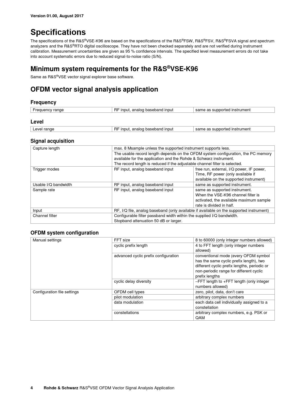

Version 01.00, August 2017 Specifications
The specifications of the R&S®VSE-K96 are based on the specifications of the R&S®FSW, R&S®FSV, R&S®FSVA signal and spectrum analyzers and the R&S®RTO digital oscilloscope. They have not been checked separately and are not verified during instrument calibration. Measurement uncertainties are given as 95 % confidence intervals. The specified level measurement errors do not take into account systematic errors due to reduced signal-to-noise ratio (S/N).
Minimum system requirements for the R&S®VSE-K96
Same as R&S®VSE vector signal explorer base software.
OFDM vector signal analysis application Frequency
Frequency range RF input, analog baseband input same as supported instrument
Level
Level range RF input, analog baseband input same as supported instrument
Signal acquisition
Capture length max. 8 Msample unless the supported instrument supports less. The usable record length depends on the OFDM system configuration, the PC memory available for the application and the Rohde & Schwarz instrument. The record length is reduced if the adjustable channel filter is selected. Trigger modes RF input, analog baseband input free run, external, I/Q power, IF power, Time, RF power (only available if available on the supported instrument) Usable I/Q bandwidth RF input, analog baseband input same as supported instrument. Sample rate RF input, analog baseband input same as supported instrument. When the VSE-K96 channel filter is activated, the available maximum sample rate is divided in half. Input RF, I/Q file, analog baseband (only available if available on the supported instrument) Channel filter Configurable filter passband width within the supplied I/Q bandwidth. Stopband attenuation 50 dB or larger.
Manual settings FFT size 8 to 60000 (only integer numbers allowed) cyclic prefix length 4 to FFT length (only integer numbers allowed) advanced cyclic prefix configuration conventional mode (every OFDM symbol has the same cyclic prefix length), two different cyclic prefix lengths, periodic or non-periodic range for different cyclic prefix lengths cyclic delay diversity –FFT length to +FFT length (only integer numbers allowed) Configuration file settings OFDM cell types zero, pilot, data, don’t care pilot modulation arbitrary complex numbers data modulation each data cell individually assigned to a constellation constellations arbitrary complex numbers, e.g. PSK or QAM
