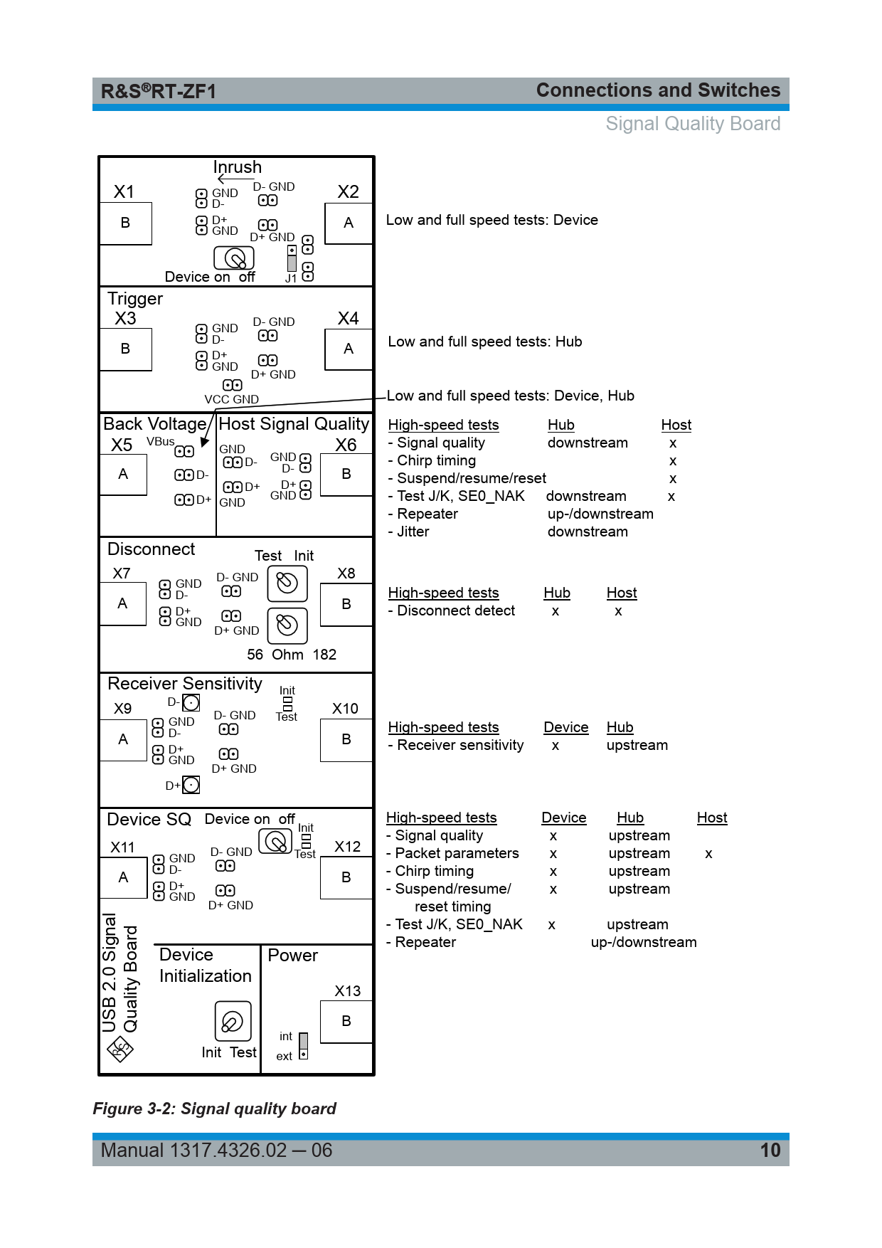

R&S. RT-ZF1. Connections and Switches. Figure 3-2: Signal quality board
R&S RT-ZF1 Connections and Switches Figure 3-2: Signal quality board
R&S
Signal Quality Board Inrush X1 GND D- GND X2 D- B D+ A Low and full speed tests: Device GND D+ GND Device on off J1 Trigger X3 D- GND X4 GND D- B A Low and full speed tests: Hub D+ GND D+ GND VCC GND Low and full speed tests: Device, Hub Back Voltage Host Signal Quality High-speed tests Hub Host X5 VBus GND X6 - Signal quality downstream x GND D- - Chirp timing x A D- D- B - Suspend/resume/reset x D+ D+ GND D+ GND - Test J/K, SE0_NAK downstream x - Repeater up-/downstream - Jitter downstream Disconnect Test Init X7 D- GND X8 GND D- High-speed tests Hub Host A B D+ - Disconnect detect x x GND D+ GND 56 Ohm 182 Receiver Sensitivity Init X9 D- X10 GND D- GND Test High-speed tests Device Hub A D- B D+ - Receiver sensitivity x upstream GND D+ GND D+ Device SQ Device on off High-speed tests Device Hub Host Init - Signal quality x upstream X11 X12 GND D- GND Test - Packet parameters x upstream x A D- B - Chirp timing x upstream D+ - Suspend/resume/ x upstream GND D+ GND reset timing - Test J/K, SE0_NAK x upstream - Repeater up-/downstream Device Power Board Initialization X13 USB 2.0 Signal Quality B int R S Init Test ext
