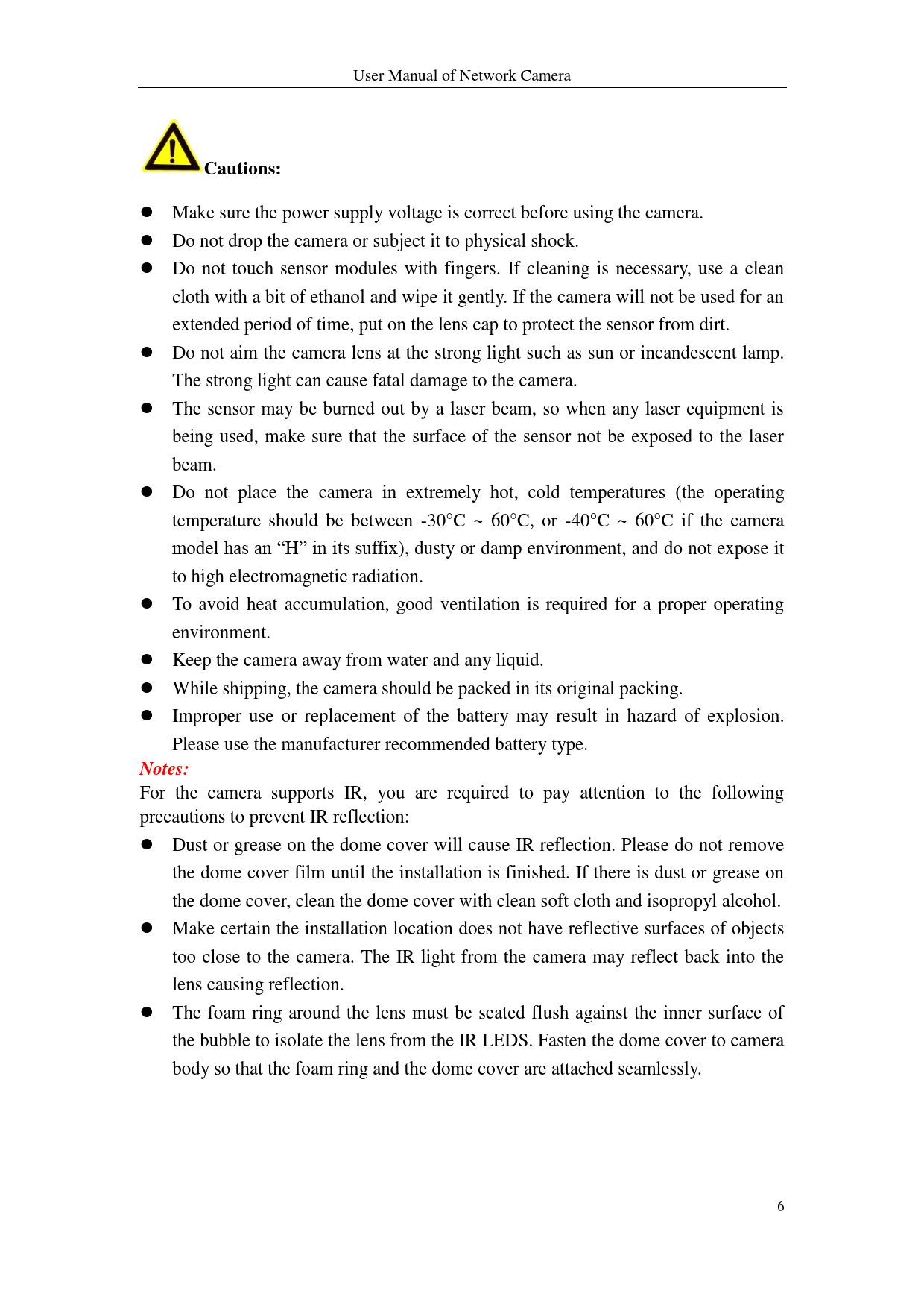

Cautions:
Make sure the power supply voltage is correct before using the camera. Do not drop the camera or subject it to physical shock. Do not touch sensor modules with fingers. If cleaning is necessary, use a clean cloth with a bit of ethanol and wipe it gently. If the camera will not be used for an extended period of time, put on the lens cap to protect the sensor from dirt. Do not aim the camera lens at the strong light such as sun or incandescent lamp. The strong light can cause fatal damage to the camera. The sensor may be burned out by a laser beam, so when any laser equipment is being used, make sure that the surface of the sensor not be exposed to the laser beam. Do not place the camera in extremely hot, cold temperatures (the operating temperature should be between -30°C ~ 60°C, or -40°C ~ 60°C if the camera model has an “H” in its suffix), dusty or damp environment, and do not expose it to high electromagnetic radiation. To avoid heat accumulation, good ventilation is required for a proper operating environment. Keep the camera away from water and any liquid. While shipping, the camera should be packed in its original packing. Improper use or replacement of the battery may result in hazard of explosion. Please use the manufacturer recommended battery type.
Notes:
For the camera supports IR, you are required to pay attention to the following precautions to prevent IR reflection: Dust or grease on the dome cover will cause IR reflection. Please do not remove the dome cover film until the installation is finished. If there is dust or grease on the dome cover, clean the dome cover with clean soft cloth and isopropyl alcohol. Make certain the installation location does not have reflective surfaces of objects too close to the camera. The IR light from the camera may reflect back into the lens causing reflection. The foam ring around the lens must be seated flush against the inner surface of the bubble to isolate the lens from the IR LEDS. Fasten the dome cover to camera body so that the foam ring and the dome cover are attached seamlessly. 6 Document Outline Chapter 1 System Requirement Chapter 2 Network Connection 2.1 Setting the Network Camera over the LAN 2.1.1 Wiring over the LAN 2.1.2 Activating the Camera 2.2 Setting the Network Camera over the WAN 2.2.1 Static IP Connection 2.2.2 Dynamic IP Connection Chapter 3 Access to the Network Camera 3.1 Accessing by Web Browsers 3.2 Accessing by Client Software Chapter 4 Wi-Fi Settings 4.1 Configuring Wi-Fi Connection in Manage and Ad-hoc Modes 4.2 Easy Wi-Fi Connection with WPS function 4.3 IP Property Settings for Wireless Network Connection Chapter 5 Live View 5.1 Live View Page 5.2 Starting Live View 5.3 Recording and Capturing Pictures Manually 5.4 Operating PTZ Control 5.4.1 PTZ Control Panel 5.4.2 Setting / Calling a Preset 5.4.3 Setting / Calling a Patrol Chapter 6 Network Camera Configuration 6.1 Configuring Local Parameters 6.2 Configuring Time Settings 6.3 Configuring Network Settings 6.3.1 Configuring TCP/IP Settings 6.3.2 Configuring Port Settings 6.3.3 Configuring PPPoE Settings 6.3.4 Configuring DDNS Settings 6.3.5 Configuring SNMP Settings 6.3.6 Configuring 802.1X Settings 6.3.7 Configuring QoS Settings 6.3.8 Configuring UPnP™ Settings 6.3.9 Configuring Wireless Dial Settings 6.3.10 Email Sending Triggered by Alarm 6.3.11 Configuring NAT (Network Address Translation) Settings 6.3.12 Configuring FTP Settings 6.3.13 Platform Access 6.3.14 HTTPS Settings 6.4 Configuring Video and Audio Settings 6.4.1 Configuring Video Settings 6.4.2 Configuring Audio Settings 6.4.3 Configuring ROI Encoding 6.4.4 Display Information on Stream 6.4.5 Configuring Target Cropping 6.5 Configuring Image Parameters 6.5.1 Configuring Display Settings 6.5.2 Configuring OSD Settings 6.5.3 Configuring Text Overlay Settings 6.5.4 Configuring Privacy Mask 6.5.5 Configuring Picture Overlay 6.6 Configuring and Handling Alarms 6.6.1 Configuring Motion Detection 6.6.2 Configuring Video Tampering Alarm 6.6.3 Configuring Alarm Input 6.6.4 Configuring Alarm Output 6.6.5 Handling Exception 6.6.6 Configuring Other Alarm 6.6.7 Configuring Audio Exception Detection 6.6.8 Configuring Defocus Detection 6.6.9 Configuring Scene Change Detection 6.6.10 Configuring Face Detection 6.6.11 Configuring Line Crossing Detection 6.6.12 Configuring Intrusion Detection 6.6.13 Configuring Region Entrance Detection 6.6.14 Configuring Region Exiting Detection 6.6.15 Configuring Unattended Baggage Detection 6.6.16 Configuring Object Removal Detection 6.7 VCA Configuration 6.7.1 Behavior Analysis 6.7.2 Face Capture 6.7.3 Heat Map 6.7.4 People Counting Chapter 7 Storage Settings 7.1 Configuring NAS Settings 7.2 Configuring Recording Schedule 7.3 Configuring Snapshot Settings 7.4 Configuring Lite Storage 7.5 Configuring Cloud Storage Chapter 8 Counting Chapter 9 Road Traffic Chapter 10 Playback Chapter 11 Log Searching Chapter 12 Others 12.1 Managing User Accounts 12.2 Authentication 12.3 Anonymous Visit 12.4 IP Address Filter 12.5 Security Service 12.6 Viewing Device Information 12.7 Maintenance 12.7.1 Rebooting the Camera 12.7.2 Restoring Default Settings 12.7.3 Exporting / Importing Configuration File 12.7.4 Upgrading the System 12.8 RS-232 Settings 12.9 RS-485 Settings 12.10 Service Settings Appendix Appendix 1 SADP Software Introduction Appendix 2 Port Mapping
