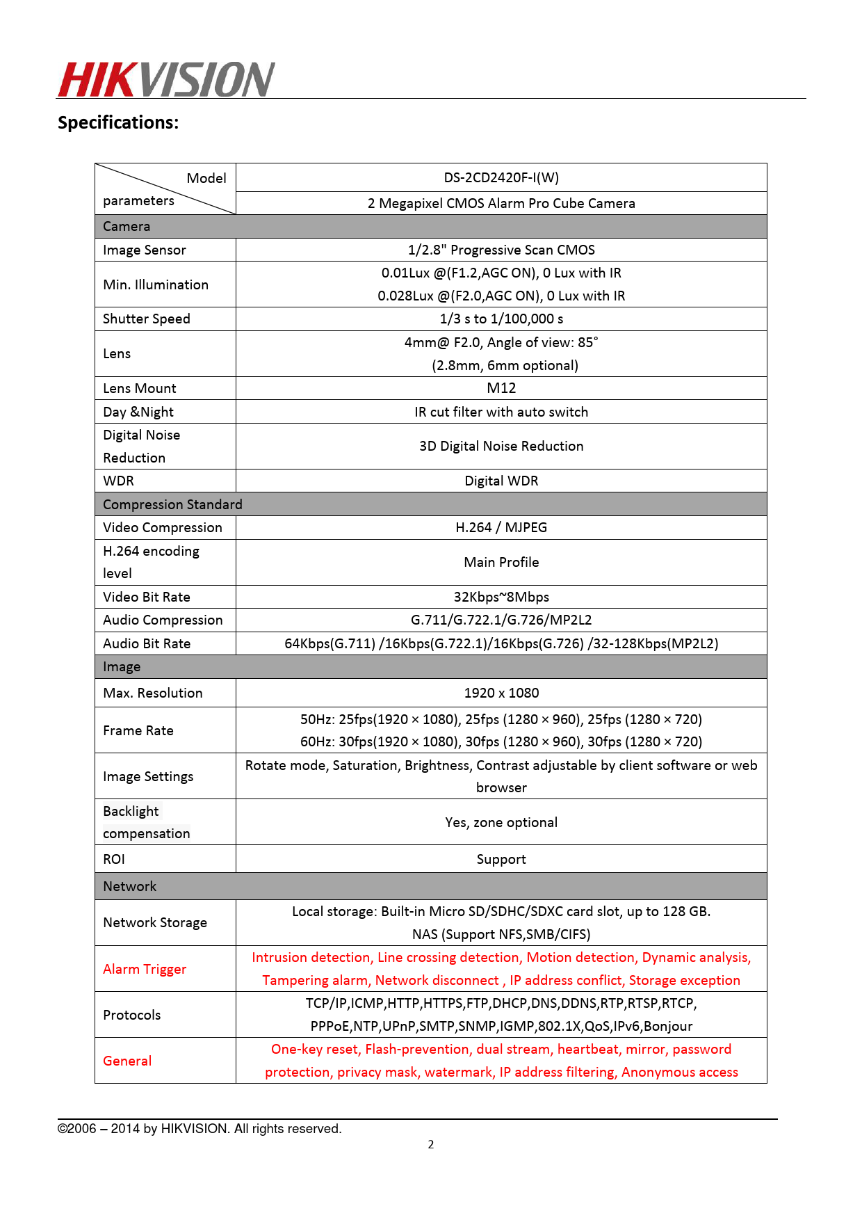

Specifications:
Specifications:
Model DS-2CD2420F-I(W) parameters 2 Megapixel CMOS Alarm Pro Cube Camera Camera Image Sensor 1/2.8" Progressive Scan CMOS 0.01Lux @(F1.2,AGC ON), 0 Lux with IR Min. Illumination 0.028Lux @(F2.0,AGC ON), 0 Lux with IR Shutter Speed 1/3 s to 1/100,000 s 4mm@ F2.0, Angle of view: 85° Lens (2.8mm, 6mm optional) Lens Mount M12 Day &Night IR cut filter with auto switch Digital Noise 3D Digital Noise Reduction Reduction WDR Digital WDR Compression Standard Video Compression H.264 / MJPEG H.264 encoding Main Profile level Video Bit Rate 32Kbps~8Mbps Audio Compression G.711/G.722.1/G.726/MP2L2 Audio Bit Rate 64Kbps(G.711) /16Kbps(G.722.1)/16Kbps(G.726) /32-128Kbps(MP2L2) Image Max. Resolution 1920 x 1080 50Hz: 25fps(1920 × 1080), 25fps (1280 × 960), 25fps (1280 × 720) Frame Rate 60Hz: 30fps(1920 × 1080), 30fps (1280 × 960), 30fps (1280 × 720) Rotate mode, Saturation, Brightness, Contrast adjustable by client software or web Image Settings browser Backlight Yes, zone optional compensation ROI Support Network Local storage: Built-in Micro SD/SDHC/SDXC card slot, up to 128 GB. Network Storage NAS (Support NFS,SMB/CIFS) Intrusion detection, Line crossing detection, Motion detection, Dynamic analysis, Alarm Trigger Tampering alarm, Network disconnect , IP address conflict, Storage exception TCP/IP,ICMP,HTTP,HTTPS,FTP,DHCP,DNS,DDNS,RTP,RTSP,RTCP, Protocols PPPoE,NTP,UPnP,SMTP,SNMP,IGMP,802.1X,QoS,IPv6,Bonjour One-key reset, Flash-prevention, dual stream, heartbeat, mirror, password General protection, privacy mask, watermark, IP address filtering, Anonymous access ©2006 – 2014 by HIKVISION. All rights reserved. 2
