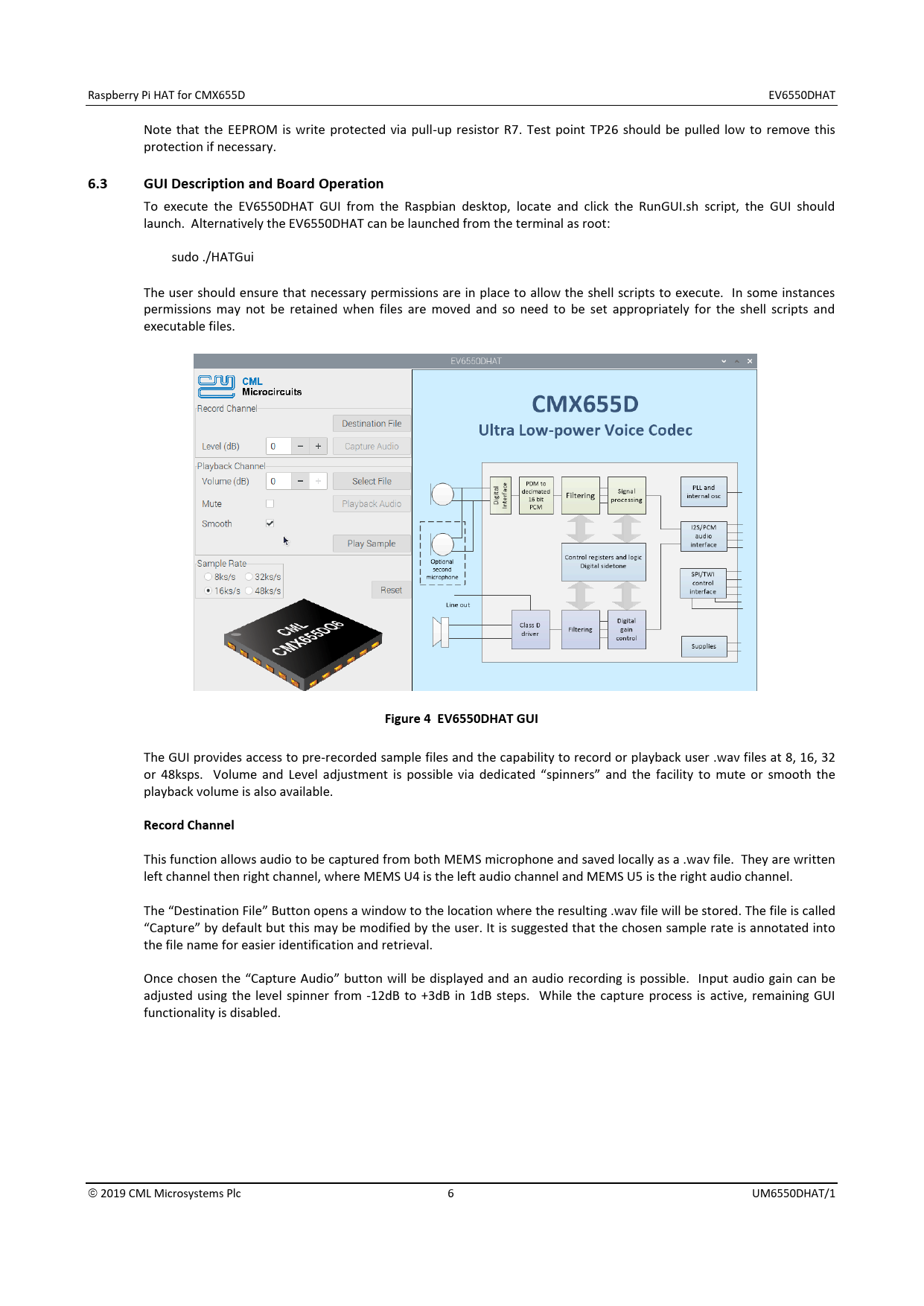

To execute the EV6550DHAT GUI from the Raspbian desktop, locate and click the RunGUI.sh script, the GUI should launch. Alternatively the EV6550DHAT can be launched from the terminal as root: sudo ./HATGui The user should ensure that necessary permissions are in place to allow the shell scripts to execute. In some instances permissions may not be retained when files are moved and so need to be set appropriately for the shell scripts and executable files.
Figure 4 EV6550DHAT GUI
The GUI provides access to pre-recorded sample files and the capability to record or playback user .wav files at 8, 16, 32 or 48ksps. Volume and Level adjustment is possible via dedicated “spinners” and the facility to mute or smooth the playback volume is also available.
