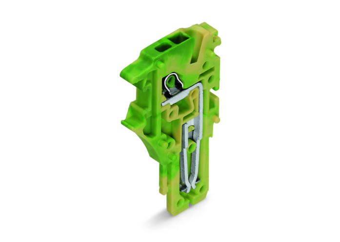

End module for 1-conductor female connector; 1.5 mm²; 1-pole
Detailed Description
Parametrics
| Actuation type | Open Tool Slot |
| Color | green-yellow |
| Connectable conductor materials | Copper |
| Connection technology | Push-in CAGE CLAMP® |
| Connector connection type | for conductors |
| Contact type (pluggable connector) | Female connector/socket |
| Страна происхождения | CN |
| Depth | 22.4 mm / 0.882 inch |
| Fine-stranded conductor | 0.14 … 1.5 mm² / 24 … 16 AWG |
| Fine-stranded conductor with ferrule, push-in termination, from | 0.5 mm² / 20 AWG |
| Fire load | 0.039 MJ |
| Global Trade Item Number (GTIN) | 4050821245186 |
| Height | 40.5 mm / 1.594 inch |
| Insulating material | Polyamide 66 (PA 66) |
| Marking level | Side marking |
| Nominal cross section | 1 mm² |
| Number of Poles | 1 |
| Product Group | 18 (X-COM-System) |
| Rated current UL (Use Group B) | 15 A |
| Rated current UL (Use Group C) | 15 A |
| Rated current UL (Use Group D) | 15 A |
| Rated voltage UL (Use Group B) | 300 V |
| Rated voltage UL (Use Group C) | 300 V |
| Rated voltage UL (Use Group D) | 300 V |
| Solid conductor | 0.14 … 1.5 mm² / 24 … 16 AWG |
| Solid conductor, push-in termination | 0.5 … 1.5 mm² / 20 … 16 AWG |
| Strip length | 9 … 11 mm / 0.35 … 0.43 Inch |
| Total number of connection points | 1 |
| Total number of potentials | 1 |
| Type of wiring | Front-entry wiring |
| Weight | 2.22 g |
| Width | 3.5 mm / 0.138 inch |
