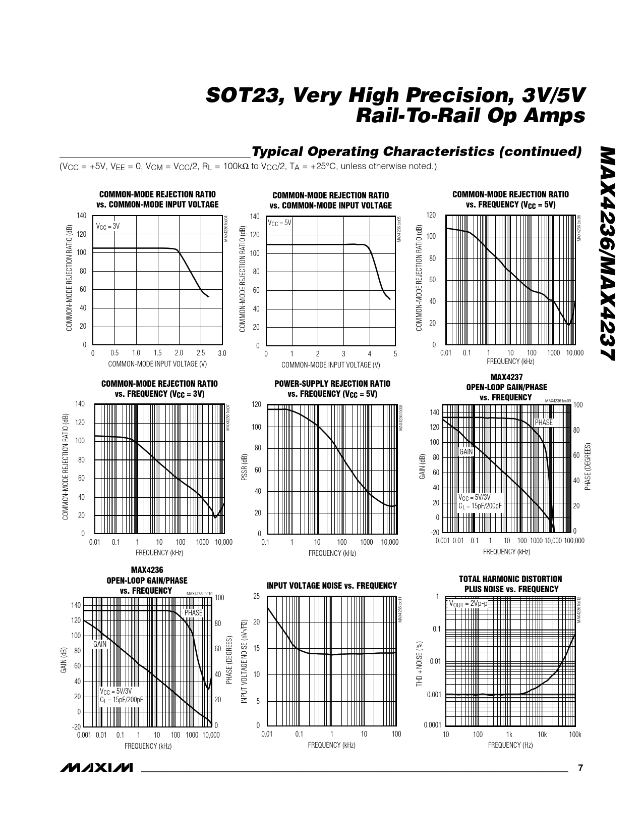

SOT23, Very High Precision, 3V/5V. Rail-To-Rail Op Amps. MAX4236/MAX4237. Typical Operating Characteristics (continued)
SOT23, Very High Precision, 3V/5V Rail-To-Rail Op Amps MAX4236/MAX4237 Typical Operating Characteristics (continued)
(VCC = +5V, VEE = 0, VCM = VCC/2, RL = 100kΩ to VCC/2, TA = +25°C, unless otherwise noted.)
COMMON-MODE REJECTION RATIO COMMON-MODE REJECTION RATIO COMMON-MODE REJECTION RATIO vs. COMMON-MODE INPUT VOLTAGE vs. COMMON-MODE INPUT VOLTAGE vs. FREQUENCY (VCC = 5V)
140 120 140 V V CC = 5V CC = 3V 120 120 100 MAX4236 toc04 MAX4236 toc06 MAX4236 toc05 100 100 80 80 80 60 60 60 40 40 40 20 20 COMMON-MODE REJECTION RATIO (dB) 20 COMMON-MODE REJECTION RATIO (dB) COMMON-MODE REJECTION RATIO (dB) 0 0 0 0 0.5 1.0 1.5 2.0 2.5 3.0 0 1 2 3 4 5 0.01 0.1 1 10 100 1000 10,000 COMMON-MODE INPUT VOLTAGE (V) FREQUENCY (kHz) COMMON-MODE INPUT VOLTAGE (V)
MAX4237 COMMON-MODE REJECTION RATIO POWER-SUPPLY REJECTION RATIO OPEN-LOOP GAIN/PHASE vs. FREQUENCY (VCC = 3V) vs. FREQUENCY (VCC = 5V) vs. FREQUENCY
140 MAX4236 toc09 120 100 140 120 PHASE MAX4236 toc07 100 MAX4236 toc08 120 80 100 100 80 GAIN 60 80 80 60 60 60 PSSR (dB) GAIN (dB) 40 40 40 PHASE (DEGREES) 40 VCC = 5V/3V 20 CL = 15pF/200pF 20 20 COMMON-MODE REJECTION RATIO (dB) 20 0 0 0 -20 0 0.01 0.1 1 10 100 1000 10,000 0.1 1 10 100 1000 10,000 0.001 0.01 0.1 1 10 100 1000 10,000 100,000 FREQUENCY (kHz) FREQUENCY (kHz) FREQUENCY (kHz)
MAX4236 OPEN-LOOP GAIN/PHASE TOTAL HARMONIC DISTORTION INPUT VOLTAGE NOISE vs. FREQUENCY vs. FREQUENCY PLUS NOISE vs. FREQUENCY
MAX4236 toc10 100 25 1 140 VOUT = 2Vp-p PHASE 120 80 20 MAX4236 toc11 MAX4236 toc12 √Hz) 0.1 100 GAIN 80 60 15 0.01 60 GAIN (dB) 40 10 40 PHASE (DEGREES) THD + NOISE (%) VCC = 5V/3V 20 0.001 CL = 15pF/200pF 20 INPUT VOLTAGE NOISE (nV 5 0 -20 0 0 0.0001 0.001 0.01 0.1 1 10 100 1000 10,000 0.01 0.1 1 10 100 10 100 1k 10k 100k FREQUENCY (kHz) FREQUENCY (kHz) FREQUENCY (Hz)
