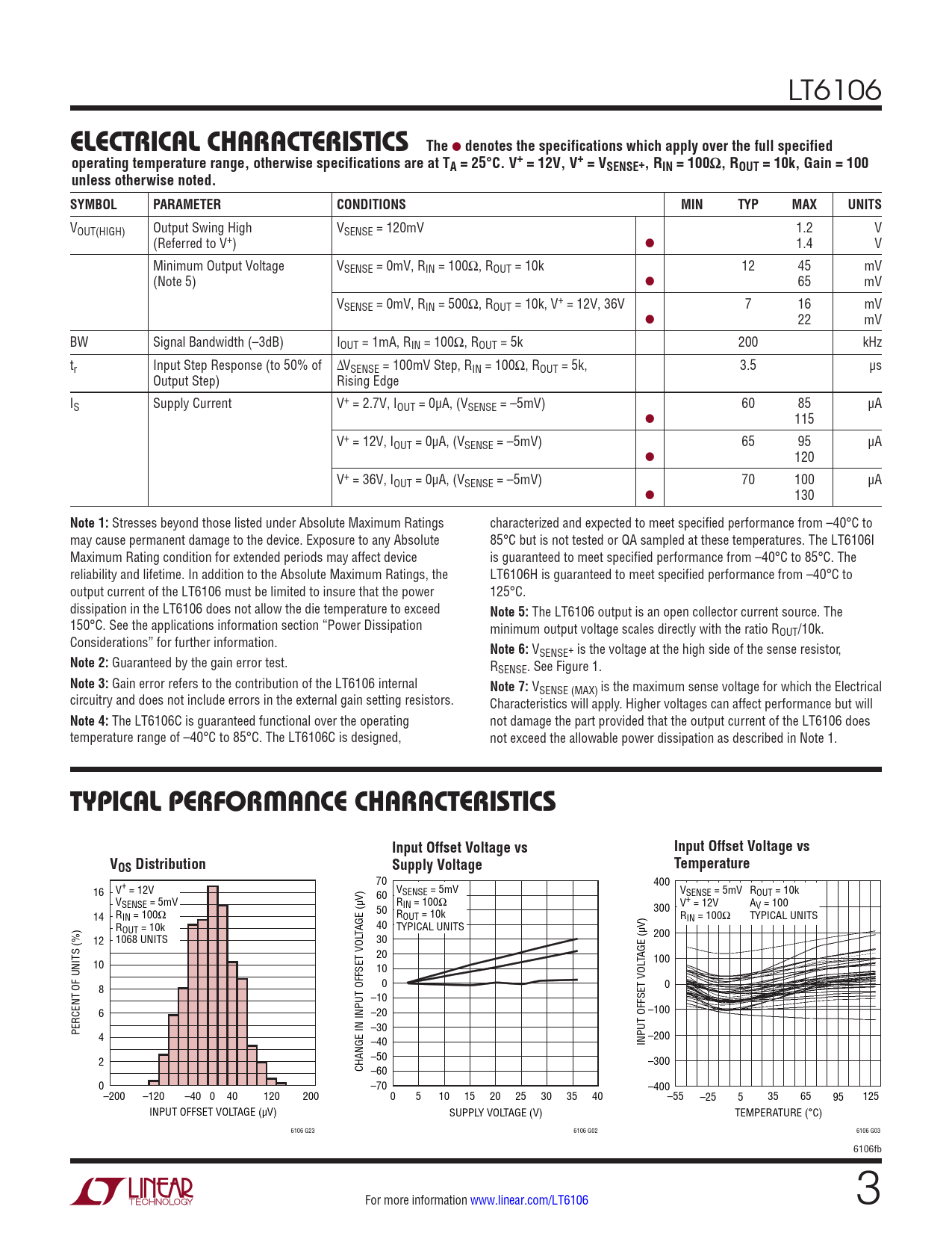

ELECTRICAL CHARACTERISTICS. The. denotes the specifications which apply over the full specified
ELECTRICAL CHARACTERISTICS The denotes the specifications which apply over the full specified
LT6106
l
denotes the specifications which apply over the full specified operating temperature range, otherwise specifications are at TA = 25°C. V+ = 12V, V+ = VSENSE+, RIN = 100Ω, ROUT = 10k, Gain = 100 unless otherwise noted. SYMBOL PARAMETER CONDITIONS MIN TYP MAX UNITS
VOUT(HIGH) Output Swing High VSENSE = 120mV 1.2 V (Referred to V+) l 1.4 V Minimum Output Voltage VSENSE = 0mV, RIN = 100Ω, ROUT = 10k 12 45 mV (Note 5) l 65 mV VSENSE = 0mV, RIN = 500Ω, ROUT = 10k, V+ = 12V, 36V 7 16 mV l 22 mV BW Signal Bandwidth (–3dB) IOUT = 1mA, RIN = 100Ω, ROUT = 5k 200 kHz tr Input Step Response (to 50% of ΔVSENSE = 100mV Step, RIN = 100Ω, ROUT = 5k, 3.5 µs Output Step) Rising Edge IS Supply Current V+ = 2.7V, IOUT = 0µA, (VSENSE = –5mV) 60 85 µA l 115 V+ = 12V, IOUT = 0µA, (VSENSE = –5mV) 65 95 µA l 120 V+ = 36V, IOUT = 0µA, (VSENSE = –5mV) 70 100 µA l 130
Note 1:
Stresses beyond those listed under Absolute Maximum Ratings characterized and expected to meet specified performance from –40°C to may cause permanent damage to the device. Exposure to any Absolute 85°C but is not tested or QA sampled at these temperatures. The LT6106I Maximum Rating condition for extended periods may affect device is guaranteed to meet specified performance from –40°C to 85°C. The reliability and lifetime. In addition to the Absolute Maximum Ratings, the LT6106H is guaranteed to meet specified performance from –40°C to output current of the LT6106 must be limited to insure that the power 125°C. dissipation in the LT6106 does not allow the die temperature to exceed
Note 5:
The LT6106 output is an open collector current source. The 150°C. See the applications information section “Power Dissipation minimum output voltage scales directly with the ratio ROUT/10k. Considerations” for further information.
Note 6:
VSENSE+ is the voltage at the high side of the sense resistor,
Note 2:
Guaranteed by the gain error test. RSENSE. See Figure 1.
Note 3:
Gain error refers to the contribution of the LT6106 internal
Note 7:
VSENSE (MAX) is the maximum sense voltage for which the Electrical circuitry and does not include errors in the external gain setting resistors. Characteristics will apply. Higher voltages can affect performance but will
Note 4:
The LT6106C is guaranteed functional over the operating not damage the part provided that the output current of the LT6106 does temperature range of –40°C to 85°C. The LT6106C is designed, not exceed the allowable power dissipation as described in Note 1.
TYPICAL PERFORMANCE CHARACTERISTICS Input Offset Voltage vs Input Offset Voltage vs VOS Distribution Supply Voltage Temperature
70 400 16 V+ = 12V VSENSE = 5mV VSENSE = 5mV ROUT = 10k V V) 60 SENSE = 5mV R 50 IN = 100Ω 300 V+ = 12V AV = 100 14 RIN = 100Ω ROUT = 10k R TYPICAL UNITS 40 V) IN = 100Ω ROUT = 10k TAGE (µ TYPICAL UNITS 200 12 1068 UNITS 30 20 TAGE (µ 100 10 10 0 0 8 –10 –100 6 –20 PERCENT OF UNITS (%) –30 4 –40 INPUT OFFSET VOL –200 2 –50 –300 CHANGE IN INPUT OFFSET VOL –60 0 –70 –400 –200 –120 –40 0 40 120 200 0 5 10 15 20 25 30 35 40 –55 –25 5 35 65 95 125 INPUT OFFSET VOLTAGE (µV) SUPPLY VOLTAGE (V) TEMPERATURE (°C) 6106 G23 6106 G02 6106 G03 6106fb For more information www.linear.com/LT6106 3
