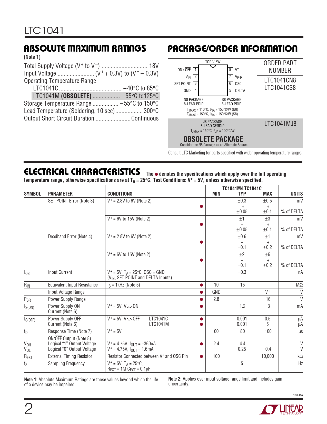

ABSOLUTE AXI U RATI GS. PACKAGE/ORDER I FOR ATIO. (Note 1). (OBSOLETE). OBSOLETE PACKAGE. ELECTRICAL CHARACTERISTICS The
ABSOLUTE AXI U RATI GS PACKAGE/ORDER I FOR ATIO (Note 1) (OBSOLETE) OBSOLETE PACKAGE ELECTRICAL CHARACTERISTICS The
LTC1041
W W W U U W U ABSOLUTE AXI U RATI GS PACKAGE/ORDER I FOR ATIO (Note 1)
TOP VIEW ORDER PART Total Supply Voltage (V+ to V –) .. 18V ON / OFF 1 8 V+ NUMBER Input Voltage .. (V+ + 0.3V) to (V – – 0.3V) V 2 7 IN VP-P Operating Temperature Range LTC1041CN8 SET POINT 3 6 OSC LTC1041C ... – 40°C to 85°C LTC1041CS8 GND 4 5 DELTA LTC1041M
(OBSOLETE)
.. – 55°C to125°C N8 PACKAGE S8 PACKAGE Storage Temperature Range ... – 55°C to 150°C 8-LEAD PDIP 8-LEAD PDIP TJMAX = 110°C, θJA = 150°C/W (N8) Lead Temperature (Soldering, 10 sec).. 300°C TJMAX = 150°C, θJA = 150°C/W (S8) Output Short Circuit Duration ... Continuous J8 PACKAGE LTC1041MJ8 8-LEAD CERDIP TJMAX = 150°C, θJA = 100°C/W
OBSOLETE PACKAGE
Consider the N8 Package as an Alternate Source Consult LTC Marketing for parts specified with wider operating temperature ranges.
C. Test Conditions: V+ = 5V, unless otherwise specified. TC1041M/LTC1041C SYMBOL PARAMETER CONDITIONS MIN TYP MAX UNITS
SET POINT Error (Note 3) V + = 2.8V to 6V (Note 2) ±0.3 ±0.5 mV ● + + ±0.05 ±0.1 % of DELTA V + = 6V to 15V (Note 2) ±1 ±3 mV ● + + ±0.05 ±0.1 % of DELTA Deadband Error (Note 4) V + = 2.8V to 6V (Note 2) ±0.6 ±1 mV ● + + ±0.1 ±0.2 % of DELTA V + = 6V to 15V (Note 2) ±2 ±6 ● + + ±0.1 ±0.2 % of DELTA IOS Input Current V + = 5V, TA = 25°C, OSC = GND ±0.3 nA (VIN, SET POINT and DELTA Inputs) RIN Equivalent Input Resistance fS = 1kHz (Note 5) ● 10 15 MΩ Input Voltage Range ● GND V + V PSR Power Supply Range ● 2.8 16 V IS(ON) Power Supply ON V + = 5V, VP-P ON ● 1.2 3 mA Current (Note 6) IS(OFF) Power Supply OFF V + = 5V, VP-P OFF LTC1041C ● 0.001 0.5 µA Current (Note 6) LTC1041M ● 0.001 5 µA tD Response Time (Note 7) V + = 5V 60 80 100 µs ON/OFF Output (Note 8) VOH Logical “1” Output Voltage V + = 4.75V, IOUT = –360µA ● 2.4 4.4 V VOL Logical “0” Output Voltage V + = 4.75V, IOUT = 1.6mA 0.25 0.4 V REXT External Timing Resistor Resistor Connected between V+ and OSC Pin ● 100 10,000 kΩ fS Sampling Frequency V + = 5V, TA = 25°C, 5 Hz REXT = 1M CEXT = 0.1µF
