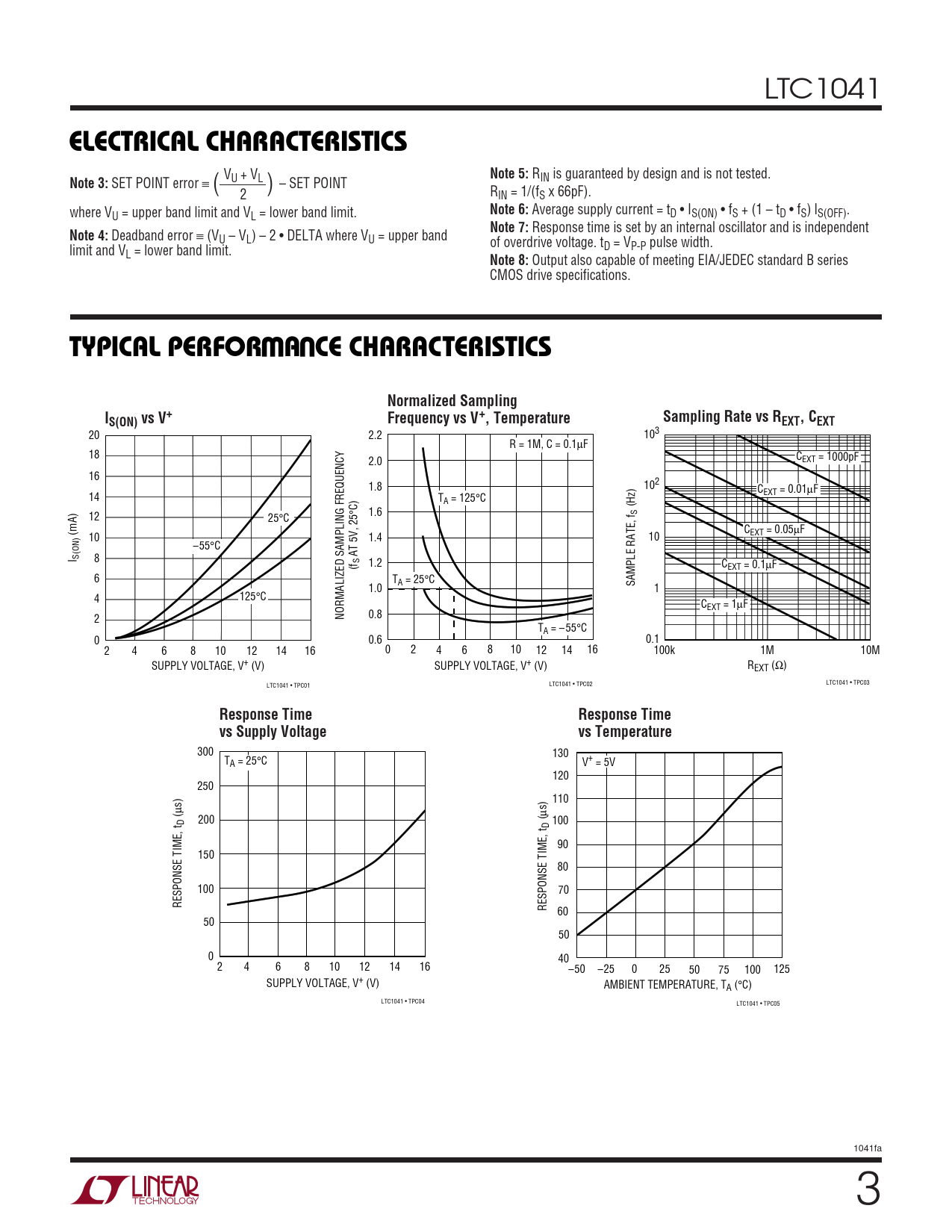

ELECTRICAL CHARACTERISTICS. Note 5:. Note 3:. Note 6:. Note 7:. Note 4:. Note 8:. TYPICAL PERFOR A CE CHARACTERISTICS
ELECTRICAL CHARACTERISTICS Note 5: Note 3: Note 6: Note 7: Note 4: Note 8: TYPICAL PERFOR A CE CHARACTERISTICS
LTC1041
V
Note 5:
R
Note 3:
SET POINT error ≡ – SET POINT U + VL ( ) IN is guaranteed by design and is not tested. 2 RIN = 1/(fS x 66pF). where V
Note 6:
Average supply current = t U = upper band limit and VL = lower band limit. D • IS(ON) • fS + (1 – tD • fS) lS(OFF).
Note 7:
Response time is set by an internal oscillator and is independent
Note 4:
Deadband error ≡ (VU – VL) – 2 • DELTA where VU = upper band of overdrive voltage. t limit and V D = VP-P pulse width. L = lower band limit.
Note 8:
Output also capable of meeting EIA/JEDEC standard B series CMOS drive specifications.
W U TYPICAL PERFOR A CE CHARACTERISTICS Normalized Sampling IS(ON) vs V+ Frequency vs V+, Temperature Sampling Rate vs REXT, CEXT
20 2.2 103 R = 1M, C = 0.1µF 18 2.0 CEXT = 1000pF 16 1.8 102 CEXT = 0.01µF 14 TA = 125°C °C) (Hz) S 12 1.6 25°C (mA) CEXT = 0.05µF 10 1.4 10 –55°C AT 5V, 25 I S(ON) 8 S(f 1.2 CEXT = 0.1µF 6 TA = 25°C SAMPLE RATE, f 1.0 1 4 125°C CEXT = 1µF 2 NORMALIZED SAMPLING FREQUENCY 0.8 TA = –55°C 0 0.6 0.1 2 4 6 8 10 12 14 16 0 2 4 6 8 10 12 14 16 100k 1M 10M SUPPLY VOLTAGE, V+ (V) SUPPLY VOLTAGE, V+ (V) REXT (Ω) LTC1041 • TPC03 LTC1041 • TPC01 LTC1041 • TPC02
Response Time Response Time vs Supply Voltage vs Temperature
300 130 TA = 25°C V+ = 5V 120 250 110 µs) ( µs) D 200 ( D 100 90 150 80 100 70 RESPONSE TIME, t RESPONSE TIME, t 60 50 50 0 40 2 4 6 8 10 12 14 16 –50 –25 0 25 50 75 100 125 SUPPLY VOLTAGE, V+ (V) AMBIENT TEMPERATURE, TA (°C) LTC1041 • TPC04 LTC1041 • TPC05 1041fa 3
