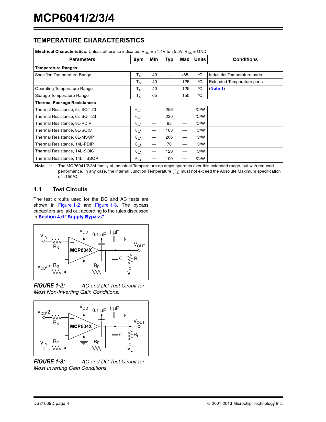

MCP6041/2/3/4 TEMPERATURE CHARACTERISTICS Electrical Characteristics:
Unless otherwise indicated, VDD = +1.4V to +5.5V, VSS = GND.
Parameters Sym Min Typ Max Units Conditions Temperature Ranges
Specified Temperature Range TA -40 — +85 °C Industrial Temperature parts TA -40 — +125 °C Extended Temperature parts Operating Temperature Range TA -40 — +125 °C
(Note 1 )
Storage Temperature Range TA -65 — +150 °C
Thermal Package Resistances
Thermal Resistance, 5L-SOT-23 JA — 256 — °C/W Thermal Resistance, 6L-SOT-23 JA — 230 — °C/W Thermal Resistance, 8L-PDIP JA — 85 — °C/W Thermal Resistance, 8L-SOIC JA — 163 — °C/W Thermal Resistance, 8L-MSOP JA — 206 — °C/W Thermal Resistance, 14L-PDIP JA — 70 — °C/W Thermal Resistance, 14L-SOIC JA — 120 — °C/W Thermal Resistance, 14L-TSSOP JA — 100 — °C/W
Note 1:
The MCP6041/2/3/4 family of Industrial Temperature op amps operates over this extended range, but with reduced performance. In any case, the internal Junction Temperature (TJ) must not exceed the Absolute Maximum specification of +150°C.
1.1 Test Circuits
The test circuits used for the DC and AC tests are shown in Figure 1-2 and Figure 1-3. The bypass capacitors are laid out according to the rules discussed in
Section 4.6 “Supply Bypass”
. VDD 1 µF V 0.1 µF IN R VOUT N
MCP604X
CL RL R V G RF DD/2 VL
FIGURE 1-2:
AC and DC Test Circuit for Most Non-Inverting Gain Conditions. VDD 1 µF V 0.1 µF DD/2 R V N OUT
MCP604X
CL RL R V G RF IN VL
FIGURE 1-3:
AC and DC Test Circuit for Most Inverting Gain Conditions. DS21669D-page 4  2001-2013 Microchip Technology Inc. Document Outline 1.0 Electrical Characteristics FIGURE 1-1: Chip Select (CS) Timing Diagram (MCP6043 only). 1.1 Test Circuits FIGURE 1-2: AC and DC Test Circuit for Most Non-Inverting Gain Conditions. FIGURE 1-3: AC and DC Test Circuit for Most Inverting Gain Conditions. 2.0 Typical Performance Curves FIGURE 2-1: Input Offset Voltage. FIGURE 2-2: Input Offset Voltage Drift with TA = -40°C to +85°C. FIGURE 2-3: Input Offset Voltage vs. Common Mode Input Voltage with VDD = 1.4V. FIGURE 2-4: Input Offset Voltage Drift with TA = +85°C to +125°C and VDD = 1.4V. FIGURE 2-5: Input Offset Voltage Drift with TA = +25°C to +125°C and VDD = 5.5V. FIGURE 2-6: Input Offset Voltage vs. Common Mode Input Voltage with VDD = 5.5V. FIGURE 2-7: Input Offset Voltage vs. Output Voltage. FIGURE 2-8: Input Noise Voltage Density vs. Frequency. FIGURE 2-9: CMRR, PSRR vs. Frequency. FIGURE 2-10: The MCP6041/2/3/4 family shows no phase reversal. FIGURE 2-11: Input Noise Voltage Density vs. Common Mode Input Voltage. FIGURE 2-12: CMRR, PSRR vs. Ambient Temperature. FIGURE 2-13: Input Bias, Offset Currents vs. Ambient Temperature. FIGURE 2-14: Open-Loop Gain, Phase vs. Frequency. FIGURE 2-15: DC Open-Loop Gain vs. Power Supply Voltage. FIGURE 2-16: Input Bias, Offset Currents vs. Common Mode Input Voltage. FIGURE 2-17: DC Open-Loop Gain vs. Load Resistance. FIGURE 2-18: DC Open-Loop Gain vs. Output Voltage Headroom. FIGURE 2-19: Channel-to-Channel Separation vs. Frequency (MCP6042 and MCP6044 only). FIGURE 2-20: Gain Bandwidth Product, Phase Margin vs. Ambient Temperature with VDD = 1.4V. FIGURE 2-21: Quiescent Current vs. Power Supply Voltage. FIGURE 2-22: Gain Bandwidth Product, Phase Margin vs. Common Mode Input Voltage. FIGURE 2-23: Gain Bandwidth Product, Phase Margin vs. Ambient Temperature with VDD = 5.5V. FIGURE 2-24: Output Short Circuit Current vs. Power Supply Voltage. FIGURE 2-25: Output Voltage Headroom vs. Output Current Magnitude. FIGURE 2-26: Slew Rate vs. Ambient Temperature. FIGURE 2-27: Small Signal Non-inverting Pulse Response. FIGURE 2-28: Output Voltage Headroom vs. Ambient Temperature. FIGURE 2-29: Maximum Output Voltage Swing vs. Frequency. FIGURE 2-30: Small Signal Inverting Pulse Response. FIGURE 2-31: Large Signal Non-inverting Pulse Response. FIGURE 2-32: Chip Select (CS) to Amplifier Output Response Time (MCP6043 only). FIGURE 2-33: Input Current vs. Input Voltage (below VSS). FIGURE 2-34: Large Signal Inverting Pulse Response. FIGURE 2-35: Chip Select (CS) Hysteresis (MCP6043 only). 3.0 Pin Descriptions TABLE 3-1: Pin Function Table 3.1 Analog Outputs 3.2 Analog Inputs 3.3 Chip Select Digital Input 3.4 Power Supply Pins 4.0 Applications Information 4.1 Rail-to-Rail Input FIGURE 4-1: Simplified Analog Input ESD Structures. FIGURE 4-2: Protecting the Analog Inputs. 4.2 Rail-to-Rail Output 4.3 Output Loads and Battery Life 4.4 Capacitive Loads FIGURE 4-3: Output Resistor, RISO Stabilizes Large Capacitive Loads. FIGURE 4-4: Recommended RISO Values for Capacitive Loads. 4.5 MCP6043 Chip Select 4.6 Supply Bypass 4.7 Unused Op Amps FIGURE 4-5: Unused Op Amps. 4.8 PCB Surface Leakage FIGURE 4-6: Example Guard Ring Layout for Inverting Gain. 4.9 Application Circuits FIGURE 4-7: High-Side Battery Current Sensor. FIGURE 4-8: Two Op Amp Instrumentation Amplifier. 5.0 Design Aids 5.1 SPICE Macro Model 5.2 FilterLab® Software 5.3 MAPS (Microchip Advanced Part Selector) 5.4 Analog Demonstration and Evaluation Boards 5.5 Application Notes 6.0 Packaging Information 6.1 Package Marking Information Appendix A: Revision History Product Identification System Trademarks Worldwide Sales and Service
