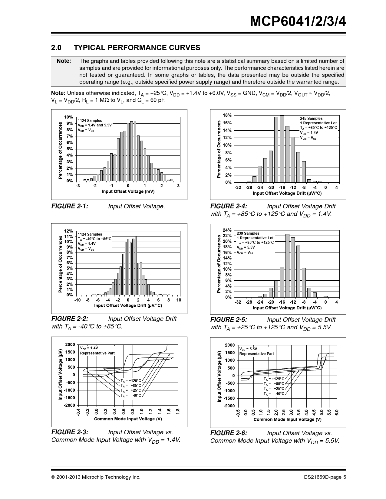

MCP6041/2/3/4. 2.0. TYPICAL PERFORMANCE CURVES. Note:. 10%. 18%. 245 Samples. 1124 Samples. s 16%. 1 Representative Lot. DD = 1.4V and 5.5V
MCP6041/2/3/4 2.0 TYPICAL PERFORMANCE CURVES Note: 10% 18% 245 Samples 1124 Samples s 16% 1 Representative Lot DD = 1.4V and 5.5V
The graphs and tables provided following this note are a statistical summary based on a limited number of samples and are provided for informational purposes only. The performance characteristics listed herein are not tested or guaranteed. In some graphs or tables, the data presented may be outside the specified operating range (e.g., outside specified power supply range) and therefore outside the warranted range.
Note:
Unless otherwise indicated, T  A = +25°C, VDD = +1.4V to +6.0V, VSS = GND, VCM = VDD/2, VOUT VDD/2, VL = VDD/2, RL = 1 M to VL, and CL = 60 pF.
10% 18% 245 Samples s 1124 Samples 9% s 16% V 1 Representative Lot DD = 1.4V and 5.5V 8% T V A = +85°C to +125°C CM = VSS 14% rence V 7% rrence DD = 1.4V u 12% VCM = VSS 6% 10% 5% Occ of 8% 4% ge age of Occur 3% 6% ta n 2% 4% rce ercent 1% e 2% P P 0% 0% -3 -2 -1 0 1 2 3 -32 -28 -24 -20 -16 -12 -8 -4 0 4 Input Offset Voltage (mV) Input Offset Voltage Drift (µV/°C) FIGURE 2-1:
Input Offset Voltage.
FIGURE 2-4:
Input Offset Voltage Drift with TA = +85°C to +125°C and VDD = 1.4V.
12% 24% 239 Samples 11% s 22% es 1124 Samples T 1 Representative Lot 10% A = -40°C to +85°C 20% V TA = +85°C to +125°C 9% DD = 1.4V 18% V rrenc VCM = VSS rrence DD = 5.5V 8% u 16% VCM = VSS 7% 14% 6% Occ 12% 5% of 10% 4% ge age of Occu 8% 3% ta ent n 6% 2% erc rce 4% 1% e P P 2% 0% 0% -10 -8 -6 -4 -2 0 2 4 6 8 10 -32 -28 -24 -20 -16 -12 -8 -4 0 4 Input Offset Voltage Drift (µV/°C) Input Offset Voltage Drift (µV/°C) FIGURE 2-2:
FIGURE 2-5:
Input Offset Voltage Drift with TA = -40°C to +85°C. with TA = +25°C to +125°C and VDD = 5.5V.
2000 2000 ) VDD = 1.4V V 1500 ) VDD = 5.5V Representative Part 1500 V Representative Part µ 1000 1000 e ( age g lt 500 o 500 lta o 0 V 0 et V TA = +125°C -500 T ffs A = +125°C set -500 T TA = +85°C A = +85°C t O -1000 T TA = +25°C A = +25°C t Off -1000 u TA = -40°C -1500 T Inpu A = -40°C p -1500 In -2000 -2000 .4 .2 .5 -0 -0 0.0 0.2 0.4 0.6 0.8 1.0 1.2 1.4 1.6 1.8 -0 0.0 0.5 1.0 1.5 2.0 2.5 3.0 3.5 4.0 4.5 5.0 5.5 6.0 Common Mode Input Voltage (V) Common Mode Input Voltage (V) FIGURE 2-3:
Input Offset Voltage vs.
FIGURE 2-6:
Input Offset Voltage vs. Common Mode Input Voltage with VDD = 1.4V. Common Mode Input Voltage with VDD = 5.5V.  2001-2013 Microchip Technology Inc. DS21669D-page 5 Document Outline 1.0 Electrical Characteristics FIGURE 1-1: Chip Select (CS) Timing Diagram (MCP6043 only). 1.1 Test Circuits FIGURE 1-2: AC and DC Test Circuit for Most Non-Inverting Gain Conditions. FIGURE 1-3: AC and DC Test Circuit for Most Inverting Gain Conditions. 2.0 Typical Performance Curves FIGURE 2-1: Input Offset Voltage. FIGURE 2-2: Input Offset Voltage Drift with TA = -40°C to +85°C. FIGURE 2-3: Input Offset Voltage vs. Common Mode Input Voltage with VDD = 1.4V. FIGURE 2-4: Input Offset Voltage Drift with TA = +85°C to +125°C and VDD = 1.4V. FIGURE 2-5: Input Offset Voltage Drift with TA = +25°C to +125°C and VDD = 5.5V. FIGURE 2-6: Input Offset Voltage vs. Common Mode Input Voltage with VDD = 5.5V. FIGURE 2-7: Input Offset Voltage vs. Output Voltage. FIGURE 2-8: Input Noise Voltage Density vs. Frequency. FIGURE 2-9: CMRR, PSRR vs. Frequency. FIGURE 2-10: The MCP6041/2/3/4 family shows no phase reversal. FIGURE 2-11: Input Noise Voltage Density vs. Common Mode Input Voltage. FIGURE 2-12: CMRR, PSRR vs. Ambient Temperature. FIGURE 2-13: Input Bias, Offset Currents vs. Ambient Temperature. FIGURE 2-14: Open-Loop Gain, Phase vs. Frequency. FIGURE 2-15: DC Open-Loop Gain vs. Power Supply Voltage. FIGURE 2-16: Input Bias, Offset Currents vs. Common Mode Input Voltage. FIGURE 2-17: DC Open-Loop Gain vs. Load Resistance. FIGURE 2-18: DC Open-Loop Gain vs. Output Voltage Headroom. FIGURE 2-19: Channel-to-Channel Separation vs. Frequency (MCP6042 and MCP6044 only). FIGURE 2-20: Gain Bandwidth Product, Phase Margin vs. Ambient Temperature with VDD = 1.4V. FIGURE 2-21: Quiescent Current vs. Power Supply Voltage. FIGURE 2-22: Gain Bandwidth Product, Phase Margin vs. Common Mode Input Voltage. FIGURE 2-23: Gain Bandwidth Product, Phase Margin vs. Ambient Temperature with VDD = 5.5V. FIGURE 2-24: Output Short Circuit Current vs. Power Supply Voltage. FIGURE 2-25: Output Voltage Headroom vs. Output Current Magnitude. FIGURE 2-26: Slew Rate vs. Ambient Temperature. FIGURE 2-27: Small Signal Non-inverting Pulse Response. FIGURE 2-28: Output Voltage Headroom vs. Ambient Temperature. FIGURE 2-29: Maximum Output Voltage Swing vs. Frequency. FIGURE 2-30: Small Signal Inverting Pulse Response. FIGURE 2-31: Large Signal Non-inverting Pulse Response. FIGURE 2-32: Chip Select (CS) to Amplifier Output Response Time (MCP6043 only). FIGURE 2-33: Input Current vs. Input Voltage (below VSS). FIGURE 2-34: Large Signal Inverting Pulse Response. FIGURE 2-35: Chip Select (CS) Hysteresis (MCP6043 only). 3.0 Pin Descriptions TABLE 3-1: Pin Function Table 3.1 Analog Outputs 3.2 Analog Inputs 3.3 Chip Select Digital Input 3.4 Power Supply Pins 4.0 Applications Information 4.1 Rail-to-Rail Input FIGURE 4-1: Simplified Analog Input ESD Structures. FIGURE 4-2: Protecting the Analog Inputs. 4.2 Rail-to-Rail Output 4.3 Output Loads and Battery Life 4.4 Capacitive Loads FIGURE 4-3: Output Resistor, RISO Stabilizes Large Capacitive Loads. FIGURE 4-4: Recommended RISO Values for Capacitive Loads. 4.5 MCP6043 Chip Select 4.6 Supply Bypass 4.7 Unused Op Amps FIGURE 4-5: Unused Op Amps. 4.8 PCB Surface Leakage FIGURE 4-6: Example Guard Ring Layout for Inverting Gain. 4.9 Application Circuits FIGURE 4-7: High-Side Battery Current Sensor. FIGURE 4-8: Two Op Amp Instrumentation Amplifier. 5.0 Design Aids 5.1 SPICE Macro Model 5.2 FilterLab® Software 5.3 MAPS (Microchip Advanced Part Selector) 5.4 Analog Demonstration and Evaluation Boards 5.5 Application Notes 6.0 Packaging Information 6.1 Package Marking Information Appendix A: Revision History Product Identification System Trademarks Worldwide Sales and Service
