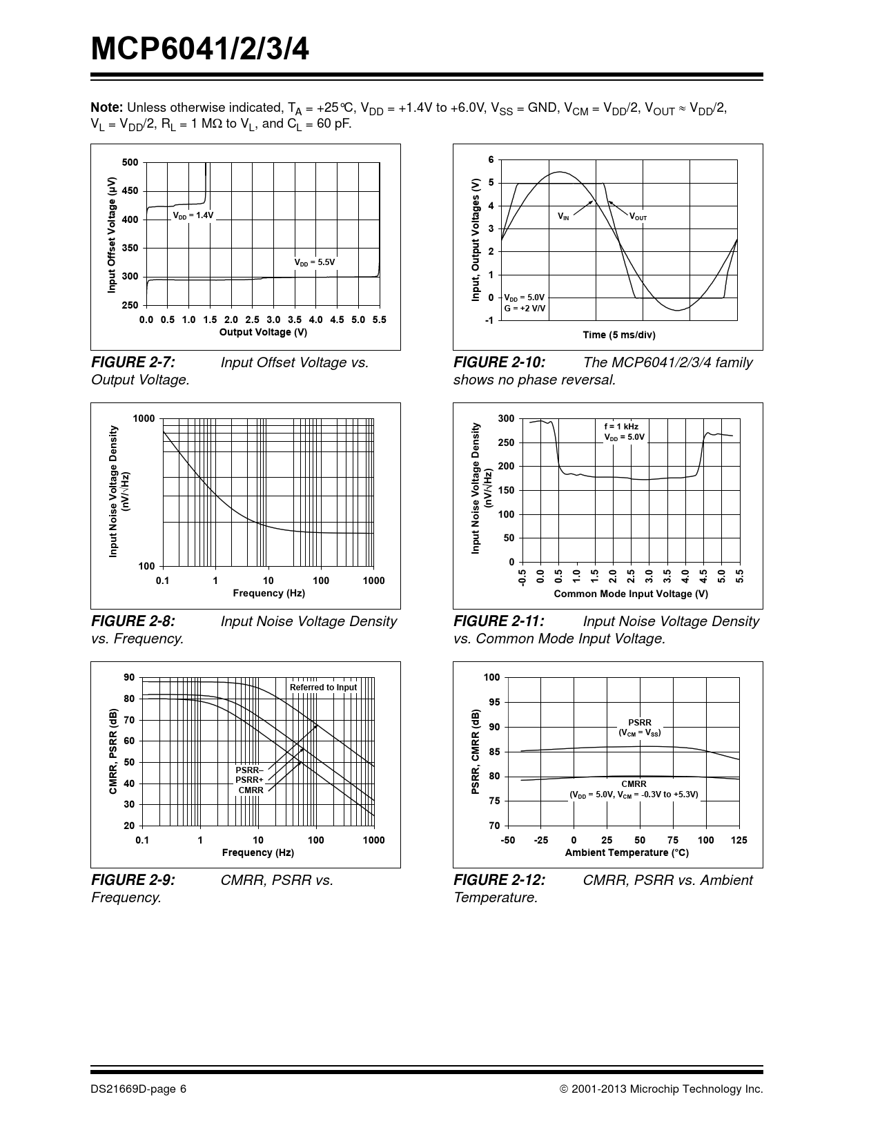

Pages / Page40 / 6 — MCP6041/2/3/4. Note:. 500. ) V. ) V 5. 450. e (µ. es ( 4. ltag 400. VDD = …
MCP6041/2/3/4. Note:. 500. ) V. ) V 5. 450. e (µ. es ( 4. ltag 400. VDD = 1.4V. VIN. VOUT. ltag o 3. t V. set V 350. u 2. Off. DD = 5.5V. u 300. t, Ou u. Inp
MCP6041/2/3/4 Note: 500 ) V ) V 5 450 e (µ es ( 4 ltag 400 VDD = 1.4V VIN VOUT ltag o 3 t V set V 350 u 2 Off DD = 5.5V u 300 t, Ou u Inp
MCP6041/2/3/4 Note:
Unless otherwise indicated, T  A = +25°C, VDD = +1.4V to +6.0V, VSS = GND, VCM = VDD/2, VOUT VDD/2, VL = VDD/2, RL = 1 M to VL, and CL = 60 pF.
500 6 ) V ) V 5 450 e (µ es ( 4 ltag 400 VDD = 1.4V VIN VOUT o ltag o 3 t V set V 350 u 2 tp Off V t DD = 5.5V u 300 1 t, Ou u Inp p In 0 V 250 DD = 5.0V G = +2 V/V 0.0 0.5 1.0 1.5 2.0 2.5 3.0 3.5 4.0 4.5 5.0 5.5 -1 Output Voltage (V) 0 5 T 10 ime (5 ms 15 /div) 20 25 FIGURE 2-7:
Input Offset Voltage vs.
FIGURE 2-10:
The MCP6041/2/3/4 family Output Voltage. shows no phase reversal.
1000 300 f = 1 kHz V 250 DD = 5.0V 200 Hz)
150 (nV/Hz) (nV/ 100 50 Input Noise Voltage Density Input Noise Voltage Density 100 0 0.1 1 10 100 1000 -0.5 0.0 0.5 1.0 1.5 2.0 2.5 3.0 3.5 4.0 4.5 5.0 5.5 Frequency (Hz) Common Mode Input Voltage (V) FIGURE 2-8:
FIGURE 2-11:
Input Noise Voltage Density vs. Frequency. vs. Common Mode Input Voltage.
90 100 Referred to Input 80 95 B) d 70 B) d ( 90 PSRR (VCM = VSS) 60 RR ( 85 50 RR, PSRR PSRR– RR, CM 80 40 PSRR+ S CMRR CM CMRR P (VDD = 5.0V, VCM = -0.3V to +5.3V) 30 75 20 70 0.1 1 10 100 1000 -50 -25 0 25 50 75 100 125 Frequency (Hz) Ambient Temperature (°C) FIGURE 2-9:
CMRR, PSRR vs.
FIGURE 2-12:
