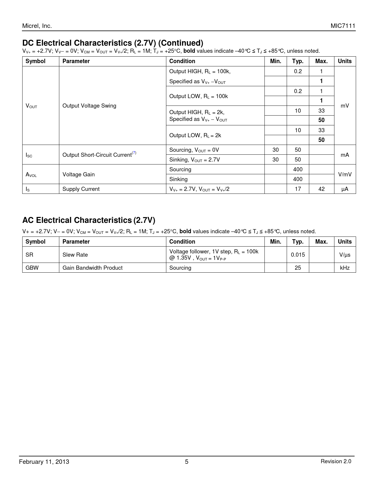

Micrel, Inc. MIC7111 DC Electrical Characteristics (2.7V) (Continued) VV+ = +2.7V; VV− = 0V; VCM = VOUT = VV+/2; RL = 1M; TJ = +25°C, bold values indicate –40°C ≤ TJ ≤ +85°C, unless noted.
Symbol Parameter Condition Min. Output HIGH, RL = 100k, Typ. Max. 0.2 1 Specified as VV+ −VOUT 1
0.2 Output LOW, RL = 100k
VOUT 10 Output HIGH, RL = 2k,
Specified as VV+ − VOUT (7) AVOL Voltage Gain IS Supply Current 33 mV 50
10 Output LOW, RL = 2k Output Short-Circuit Current 1
1 Output Voltage Swing ISC Units 33
50 Sourcing, VOUT = 0V 30 50 Sinking, VOUT = 2.7V 30 50 Sourcing 400 Sinking 400 VV+ = 2.7V, VOUT = VV+/2 17 mA V/mV
42 µA Max. Units AC Electrical Characteristics (2.7V)
V+ = +2.7V; V− = 0V; VCM = VOUT = VV+/2; RL = 1M; TJ = +25°C, bold values indicate –40°C ≤ TJ ≤ +85°C, unless noted.
Symbol Parameter Condition SR Slew Rate Voltage follower, 1V step, RL = 100k
@ 1.35V , VOUT = 1VP-P GBW Gain Bandwidth Product Sourcing February 11, 2013 5 Min. Typ.
0.015 V/µs 25 kHz Revision 2.0
