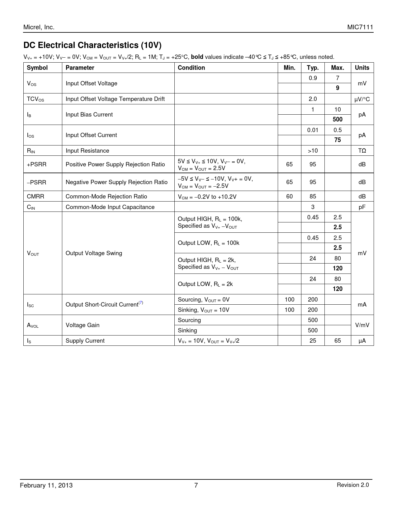

Micrel, Inc. MIC7111 DC Electrical Characteristics (10V)
Micrel, Inc MIC7111 DC Electrical Characteristics (10V)
VV+ = +10V; VV− = 0V; VCM = VOUT = VV+/2; RL = 1M; TJ = +25°C, bold values indicate –40°C ≤ TJ ≤ +85°C, unless noted.
Symbol Parameter Condition VOS Input Offset Voltage TCVOS Input Offset Voltage Temperature Drift Min. 0.9 7 2.0
1 Input Bias Current IOS Input Offset Current RIN Input Resistance +PSRR Positive Power Supply Rejection Ratio 5V ≤ VV+ ≤ 10V, VV− = 0V,
VCM = VOUT = 2.5V −PSRR Negative Power Supply Rejection Ratio CMRR Common-Mode Rejection Ratio CIN Common-Mode Input Capacitance 0.01 0.5
75 95 dB −5V ≤ VV− ≤ −10V, VV+ = 0V,
VCM = VOUT = −2.5V 65 95 dB VCM = −0.2V to +10.2V 60 85 dB 3 pF 0.45 Voltage Gain IS Supply Current 0.45 2.5
2.5 24 80 mV 120
24 80
120 Sourcing, VOUT = 0V 100 200 Sinking, VOUT = 10V 100 200 Sourcing 500 Sinking 500 VV+ = 10V, VOUT = VV+/2 25 7 2.5
2.5 Output LOW, RL = 2k AVOL pA 65 Output HIGH, RL = 2k,
Specified as VV+ − VOUT (7) pA TΩ Output Voltage Swing Output Short-Circuit Current mV >10 Output LOW, RL = 100k ISC Units µV/°C
10
500 Output HIGH, RL = 100k,
Specified as VV+ −VOUT February 11, 2013 Max. 9 IB VOUT Typ. mA V/mV
