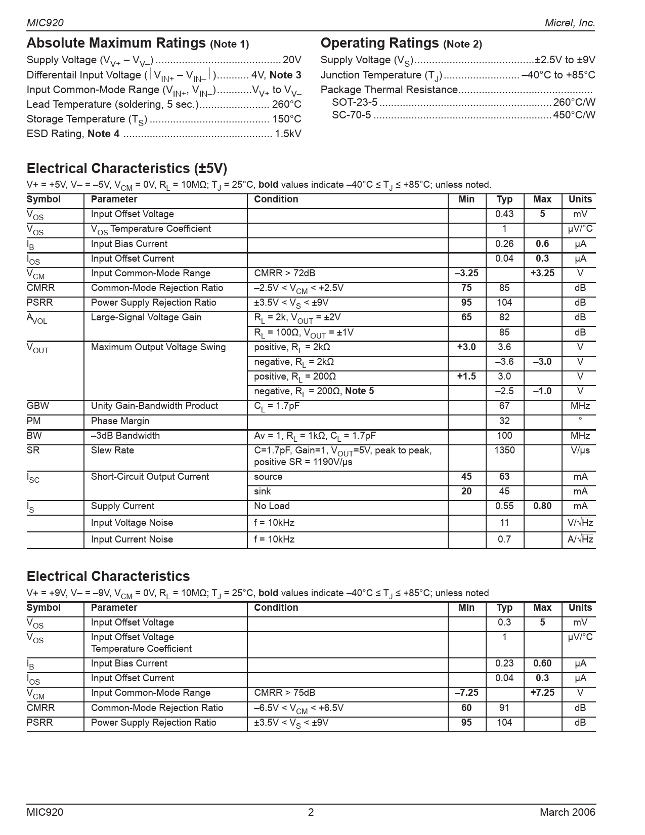

Absolute Maximum Ratings (Note 1). Operating Ratings (Note 2). Note 3. Note 4. Electrical Characteristics (±5V). bold. Symbol
MIC920 Micrel, Inc.
Absolute Maximum Ratings (Note 1) Operating Ratings (Note 2)
Supply Voltage (VV+ – VV–) ...20V Supply Voltage (VS) ...±2.5V to ±9V Differentail Input Voltage (VIN+ – VIN–) ... 4V,
Note 3
Junction Temperature (TJ) .. –40°C to +85°C Input Common-Mode Range (VIN+, VIN–) ..VV+ to VV– Package Thermal Resistance .. Lead Temperature (soldering, 5 sec.) .. 260°C SOT-23-5 ...260°C/W Storage Temperature (T SC-70-5 ...450°C/W S) ... 150°C ESD Rating,
Note 4
... 1.5kV
V+ = +5V, V– = –5V, VCM = 0V, RL = 10MΩ; TJ = 25°C,
bold
values indicate –40°C ≤ TJ ≤ +85°C; unless noted.
Symbol Parameter Condition Min Typ Max Units
VOS Input Offset Voltage 0.43
5
mV VOS VOS Temperature Coefficient 1 µV/°C IB Input Bias Current 0.26
0.6
µA IOS Input Offset Current 0.04
0.3
µA VCM Input Common-Mode Range CMRR > 72dB
–3.25 +3.25
V CMRR Common-Mode Rejection Ratio –2.5V < VCM < +2.5V
75
85 dB PSRR Power Supply Rejection Ratio ±3.5V < VS < ±9V
95
104 dB AVOL Large-Signal Voltage Gain RL = 2k, VOUT = ±2V
65
82 dB RL = 100Ω, VOUT = ±1V 85 dB VOUT Maximum Output Voltage Swing positive, RL = 2kΩ
+3.0
3.6 V negative, RL = 2kΩ –3.6
–3.0
V positive, RL = 200Ω
+1.5
3.0 V negative, RL = 200Ω,
Note 5
–2.5
–1.0
V GBW Unity Gain-Bandwidth Product CL = 1.7pF 67 MHz PM Phase Margin 32 ° BW –3dB Bandwidth Av = 1, RL = 1kΩ, CL = 1.7pF 100 MHz SR Slew Rate C=1.7pF, Gain=1, VOUT=5V, peak to peak, 1350 V/µs positive SR = 1190V/µs ISC Short-Circuit Output Current source
45 63
mA sink
20
45 mA IS Supply Current No Load 0.55
0.80
mA Input Voltage Noise f = 10kHz 11 V/√Hz Input Current Noise f = 10kHz 0.7 A/√Hz
V+ = +9V, V– = –9V, VCM = 0V, RL = 10MΩ; TJ = 25°C,
bold
VOS Input Offset Voltage 0.3
5
mV VOS Input Offset Voltage 1 µV/°C Temperature Coefficient IB Input Bias Current 0.23
0.60
0.3
µA VCM Input Common-Mode Range CMRR > 75dB
–7.25 +7.25
V CMRR Common-Mode Rejection Ratio –6.5V < VCM < +6.5V
60
91 dB PSRR Power Supply Rejection Ratio ±3.5V < VS < ±9V
95
104 dB MIC920 2 March 2006
