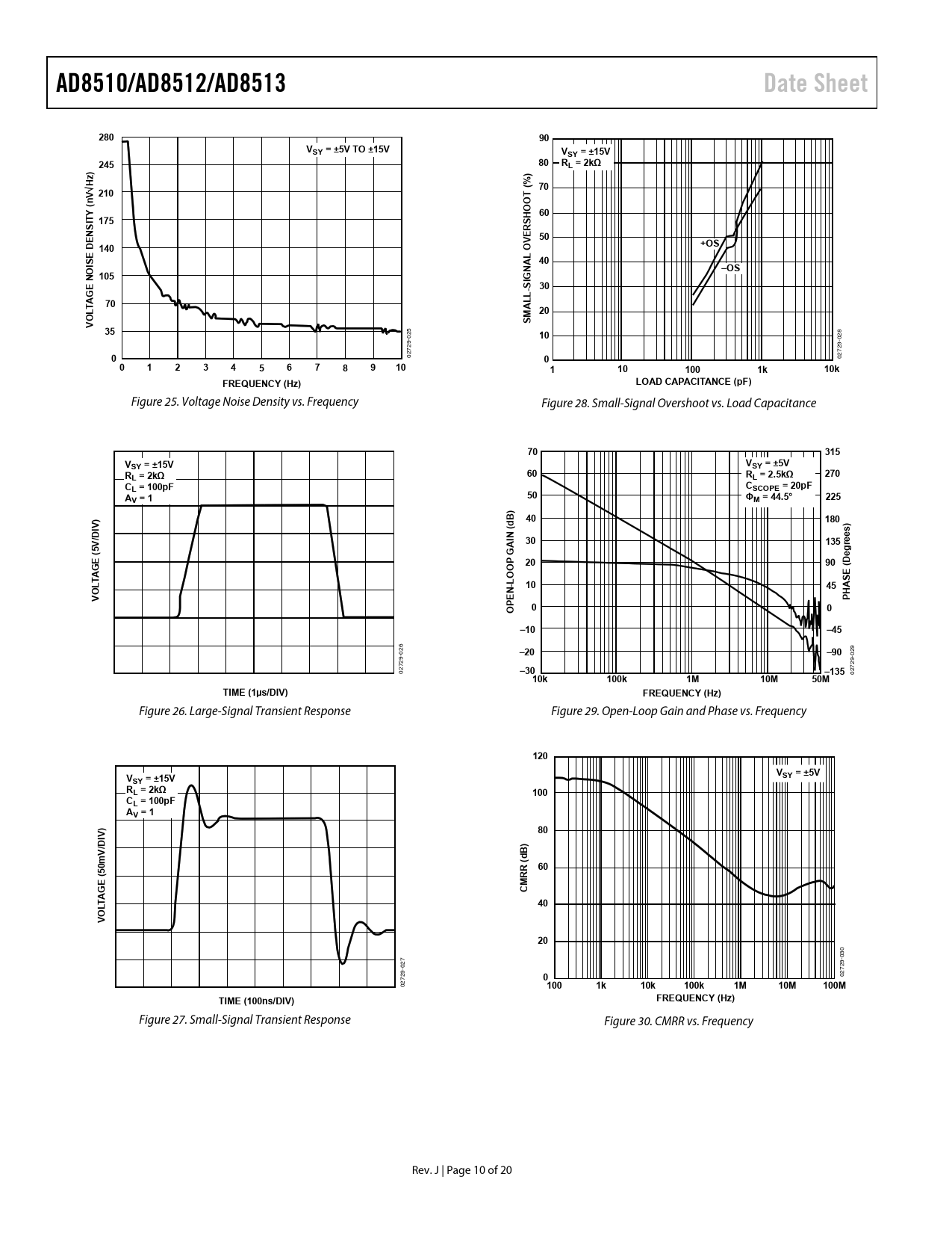

AD8510/AD8512/AD8513. Date Sheet. 280. VSY = ±5V TO ±15V. VSY = ±15V. 245. RL = 2kΩ. ) %. ( 70. V 210. n Y (. OOT H 60. IT 175. S R. E 50. +OS. DE 140
AD8510/AD8512/AD8513 Date Sheet 280 VSY = ±5V TO ±15V VSY = ±15V 245 RL = 2kΩ ) % ( 70 V 210 n Y ( OOT H 60 IT 175 S R E 50 +OS DE 140
AD8510/AD8512/AD8513 Date Sheet 280 90 VSY = ±5V TO ±15V VSY = ±15V 245 80 RL = 2kΩ ) ) % Hz ( 70 V 210 n Y ( OOT H 60 IT 175 S R NS E 50 +OS DE 140 E OV L IS A 40 N –OS NO 105 IG E S 30 G 70 LL- LTA A 20 O M V S 35

0 1 2 3 4 5 6 7 8 9 10 1 10 100 1k 10k FREQUENCY (Hz) LOAD CAPACITANCE (pF)
Figure 25. Voltage Noise Density vs. Frequency Figure 28. Small-Signal Overshoot vs. Load Capacitance
70 315 VSY = ±15V VSY = ±5V R 60 R 270 L = 2kΩ L = 2.5kΩ CL = 100pF CSCOPE = 20pF A 50 V = 1 ΦM = 44.5° 225 ) ) B d 40 180 IV ( D IN V/ 30 135 rees) (5 GA eg E P 20 D 90 G ( E TA OO -L 10 N 45 HAS VOL E P P O 0 0 –10 –45

10k 100k 1M 10M 50M TIME (1µs/DIV) FREQUENCY (Hz)
Figure 26. Large-Signal Transient Response Figure 29. Open-Loop Gain and Phase vs. Frequency
120 V V SY = ±5V SY = ±15V RL = 2kΩ 100 CL = 100pF AV = 1 80 IV) /D ) V B d ( 50m 60 RR E ( G CM LTA 40 VO 20

100 1k 10k 100k 1M 10M 100M TIME (100ns/DIV) FREQUENCY (Hz)
Figure 27. Small-Signal Transient Response Figure 30. CMRR vs. Frequency Rev. J | Page 10 of 20 Document Outline Features Applications Pin Configurations General Description Revision History Specifications Electrical Characteristics Absolute Maximum Ratings ESD Caution Typical Performance Characteristics General Application Information Input Overvoltage Protection Output Phase Reversal Total Harmonic Distortion (THD) + Noise Total Noise Including Source Resistors Settling Time Overload Recovery Time Capacitive Load Drive Open-Loop Gain and Phase Response Precision Rectifiers I-V Conversion Applications Photodiode Circuits Signal Transmission Applications Crosstalk Outline Dimensions Ordering Guide
