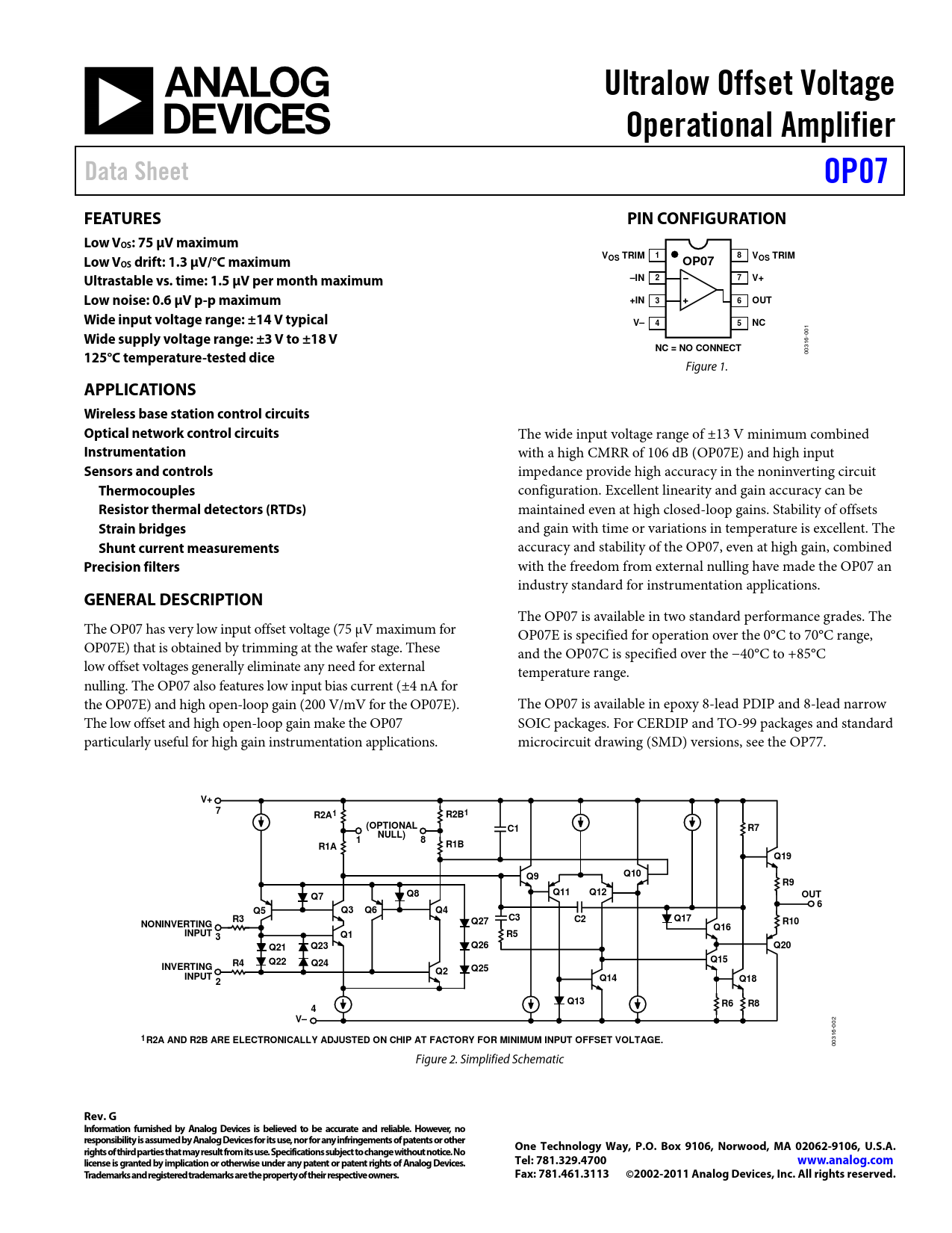

Ultralow Offset Voltage Operational Amplifier Data Sheet OP07 FEATURES PIN CONFIGURATION Low VOS: 75 μV maximum Low V V 1 OS TRIM 8 VOS TRIM OS drift: 1.3 μV/°C maximum OP07 Ultrastable vs. time: 1.5 μV per month maximum –IN 2 7 V+ Low noise: 0.6 μV p-p maximum +IN 3 6 OUT Wide input voltage range: ±14 V typical V– 4 5 NC Wide supply voltage range: ±3 V to ±18 V

00316- Figure 1.

V+ 7 R2A1 R2B1 (OPTIONAL C1 R7 NULL) 1 8 R1A R1B Q19 Q9 Q10 R9 Q11 Q8 Q12 OUT Q7 6 Q5 Q3 Q6 Q4 R3 C3 Q27 C2 Q17 R10 NONINVERTING Q16 INPUT 3 Q1 R5 Q21 Q23 Q26 Q20 R4 Q22 Q24 Q15 INVERTING Q2 Q25 INPUT 2 Q14 Q18 Q13 R6 R8 4 V–
002
1 R2A AND R2B ARE ELECTRONICALLY ADJUSTED ON CHIP AT FACTORY FOR MINIMUM INPUT OFFSET VOLTAGE.
00316- Figure 2. Simplified Schematic
