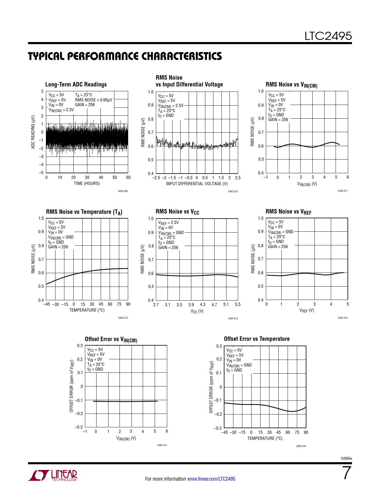

typical perForMance characteristics. RMS Noise. Long-Term ADC Readings. vs Input Differential Voltage. RMS Noise vs VIN(CM)
LTC2495
typical perForMance characteristics RMS Noise Long-Term ADC Readings vs Input Differential Voltage RMS Noise vs VIN(CM)
5 1.0 1.0 VCC = 5V TA = 25°C VCC = 5V VCC = 5V 4 VREF = 5V RMS NOISE = 0.60µV VREF = 5V VREF = 5V V GAIN = 256 0.9 V 3 IN = 0V VIN(CM) = 2.5V 0.9 IN = 0V VIN(CM) = 2.5V TA = 25°C TA = 25°C 2 f fO = GND 0.8 O = GND 0.8 GAIN = 256 1 0 0.7 0.7 –1 ADC READING (µV) RMS NOISE (µV) RMS NOISE (µV) –2 0.6 0.6 –3 0.5 0.5 –4 –5 0.4 0.4 0 10 20 30 40 50 60 –2.5 –2 –1.5 –1 –0.5 0 0.5 1 1.5 2 2.5 –1 0 1 2 3 4 5 6 TIME (HOURS) INPUT DIFFERENTIAL VOLTAGE (V) VIN(CM) (V) 2495 G09 2495 G10 2495 G11
RMS Noise vs Temperature (TA) RMS Noise vs VCC RMS Noise vs VREF
1.0 1.0 1.0 VCC = 5V VREF = 2.5V VCC = 5V VREF = 5V VIN = 0V VIN = 0V 0.9 VIN = 0V 0.9 VIN(CM) = GND 0.9 VIN(CM) = GND VIN(CM) = GND TA = 25°C TA = 25°C f f fO = GND 0.8 O = GND O = GND GAIN = 256 0.8 GAIN = 256 0.8 GAIN = 256 0.7 0.7 0.7 RMS NOISE (µV) 0.6 RMS NOISE (µV) 0.6 RMS NOISE (µV) 0.6 0.5 0.5 0.5 0.4 0.4 0.4 –45 –30 –15 0 15 30 45 60 75 90 2.7 3.1 3.5 3.9 4.3 4.7 5.1 5.5 0 1 2 3 4 5 TEMPERATURE (°C) VCC (V) VREF (V) 2495 G12 2495 G13 2495 G14
Offset Error vs VIN(CM) Offset Error vs Temperature
0.3 0.3 VCC = 5V VCC = 5V VREF = 5V VREF = 5V ) 0.2 VIN = 0V ) 0.2 VIN = 0V REF TA = 25°C VIN(CM) = GND f REF f 0.1 O = GND 0.1 O = GND 0 0 –0.1 –0.1 OFFSET ERROR (ppm of V –0.2 OFFSET ERROR (ppm of V –0.2 –0.3 –0.3 –1 0 1 2 3 4 5 6 –45 –30 –15 0 15 30 45 60 75 90 VIN(CM) (V) TEMPERATURE (°C) 2495 G15 2495 G16 2495fe For more information www.linear.com/LTC2495 7 Document Outline Features Description Applications Typical Application Absolute Maximum Ratings Pin Configuration order information Electrical Characteristics (Normal Speed) Electrical Characteristics (2x Speed) Converter Characteristics Analog Input and Reference I2C Inputs And Digital Outputs Power Requirements Digital Inputs And Digital Outputs I2C Timing Characteristics Typical Performance Characteristics Pin Functions Functional Block Diagram Applications Information Package Description Revision History Related Parts
