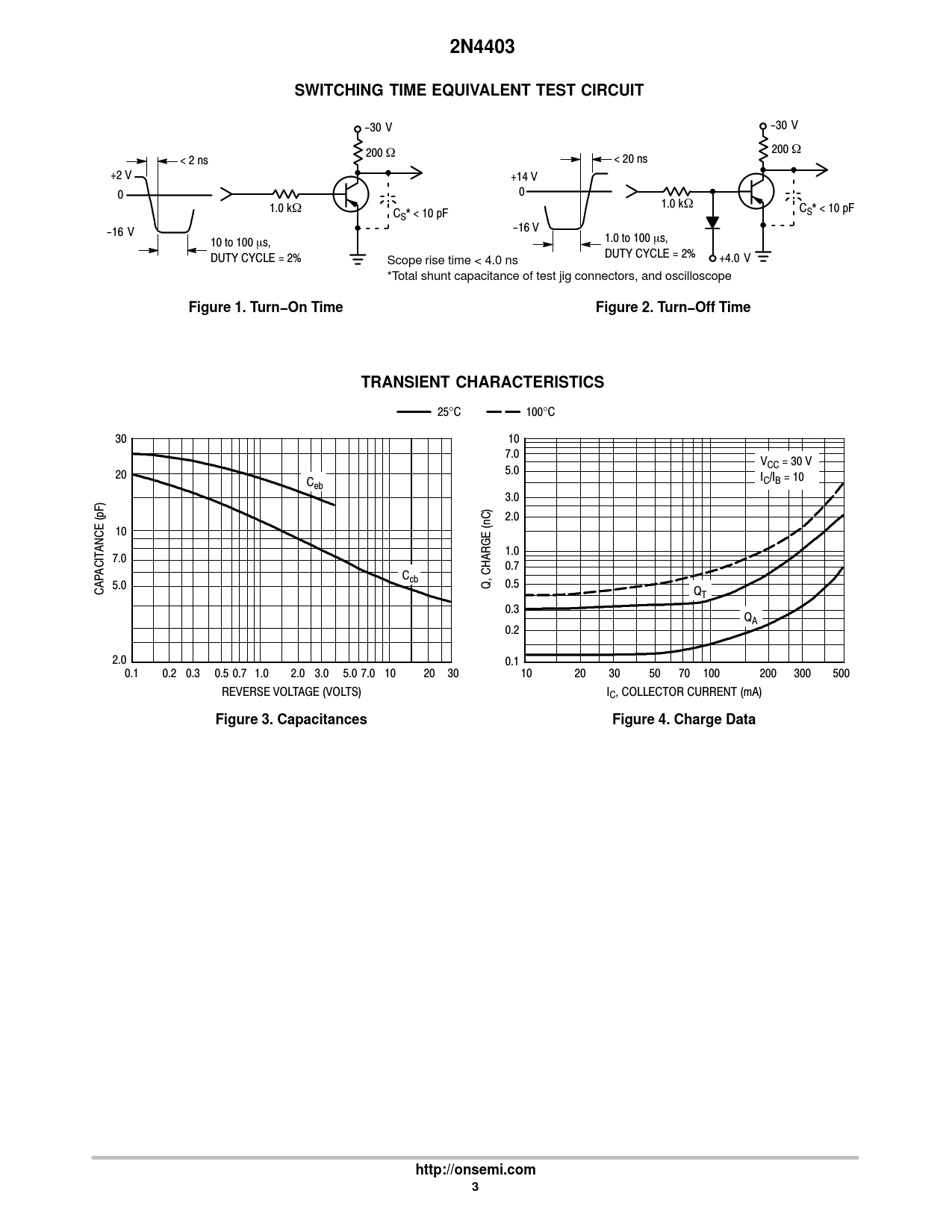

Pages / Page7 / 3 — 2N4403. SWITCHING TIME EQUIVALENT TEST CIRCUIT. Figure 1. Turn−On Time. …
Revision3
File Format / SizePDF / 121 Kb
2N4403. SWITCHING TIME EQUIVALENT TEST CIRCUIT. Figure 1. Turn−On Time. Figure 2. Turn−Off Time. TRANSIENT CHARACTERISTICS
2N4403 SWITCHING TIME EQUIVALENT TEST CIRCUIT Figure 1 Turn−On Time Figure 2 Turn−Off Time TRANSIENT CHARACTERISTICS
−30 V −30 V 200 W 200 W < 2 ns < 20 ns +2 V +14 V 0 0 1.0 kW 1.0 kW C C S* < 10 pF S* < 10 pF −16 V −16 V 10 to 100 ms, 1.0 to 100 ms, DUTY CYCLE = 2% DUTY CYCLE = 2% Scope rise time < 4.0 ns +4.0 V *Total shunt capacitance of test jig connectors, and oscilloscope
Figure 1. Turn−On Time Figure 2. Turn−Off Time TRANSIENT CHARACTERISTICS
25°C 100°C 30 10 7.0 VCC = 30 V 20 5.0 IC/IB = 10 Ceb 3.0 2.0 10 ANCE (pF) 1.0 7.0 ACIT 0.7 Ccb 5.0 0.5 CAP Q, CHARGE (nC) QT 0.3 QA 0.2 2.0 0.1 0.1 0.2 0.3 0.5 0.7 1.0 2.0 3.0 5.0 7.0 10 20 30 10 20 30 50 70 100 200 300 500 REVERSE VOLTAGE (VOLTS) IC, COLLECTOR CURRENT (mA)
Figure 3. Capacitances Figure 4. Charge Data http://onsemi.com 3
