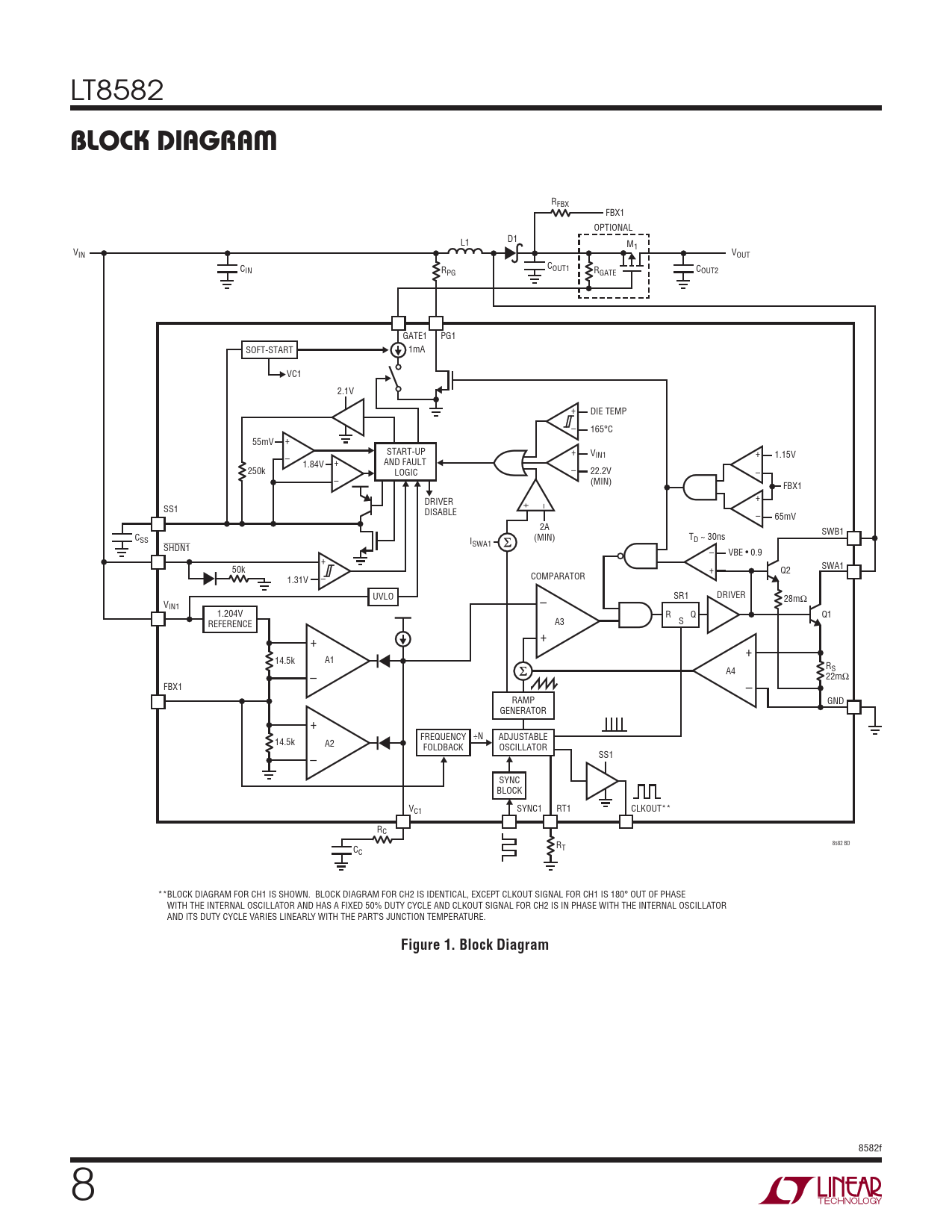

Pages / Page36 / 8 — BLOCK DIAGRAM. Figure 1. Block Diagram
File Format / SizePDF / 460 Kb
BLOCK DIAGRAM Figure 1 Block Diagram
LT8582
BLOCK DIAGRAM
RFBX FBX1 OPTIONAL L1 D1 M1 V V IN OUT C C IN R OUT1 R C PG GATE OUT2 GATE1 PG1 SOFT-START 1mA VC1 2.1V + DIE TEMP – 165°C + 55mV – START-UP + VIN1 + 1.15V 1.84V + AND FAULT 250k LOGIC – 22.2V – – (MIN) FBX1 DRIVER + + – SS1 DISABLE – 65mV 2A SWB1 C T SS I (MIN) D ~ 30ns SWA1 SHDN1 + – 7#&t 50k SWA1 – + Q2 1.31V COMPARATOR UVLO – SR1 DRIVER 28mΩ VIN1 1.204V R Q Q1 A3 S REFERENCE + + + 14.5k A1 R A4 S – 22mΩ FBX1 – RAMP GND GENERATOR + FREQUENCY ÷N ADJUSTABLE 14.5k A2 FOLDBACK OSCILLATOR – SS1 SYNC BLOCK V SYNC1 RT1 CLKOUT** C1 RC 8582 BD RT CC **BLOCK DIAGRAM FOR CH1 IS SHOWN. BLOCK DIAGRAM FOR CH2 IS IDENTICAL, EXCEPT CLKOUT SIGNAL FOR CH1 IS 180° OUT OF PHASE WITH THE INTERNAL OSCILLATOR AND HAS A FIXED 50% DUTY CYCLE AND CLKOUT SIGNAL FOR CH2 IS IN PHASE WITH THE INTERNAL OSCILLATOR AND ITS DUTY CYCLE VARIES LINEARLY WITH THE PART’S JUNCTION TEMPERATURE.
