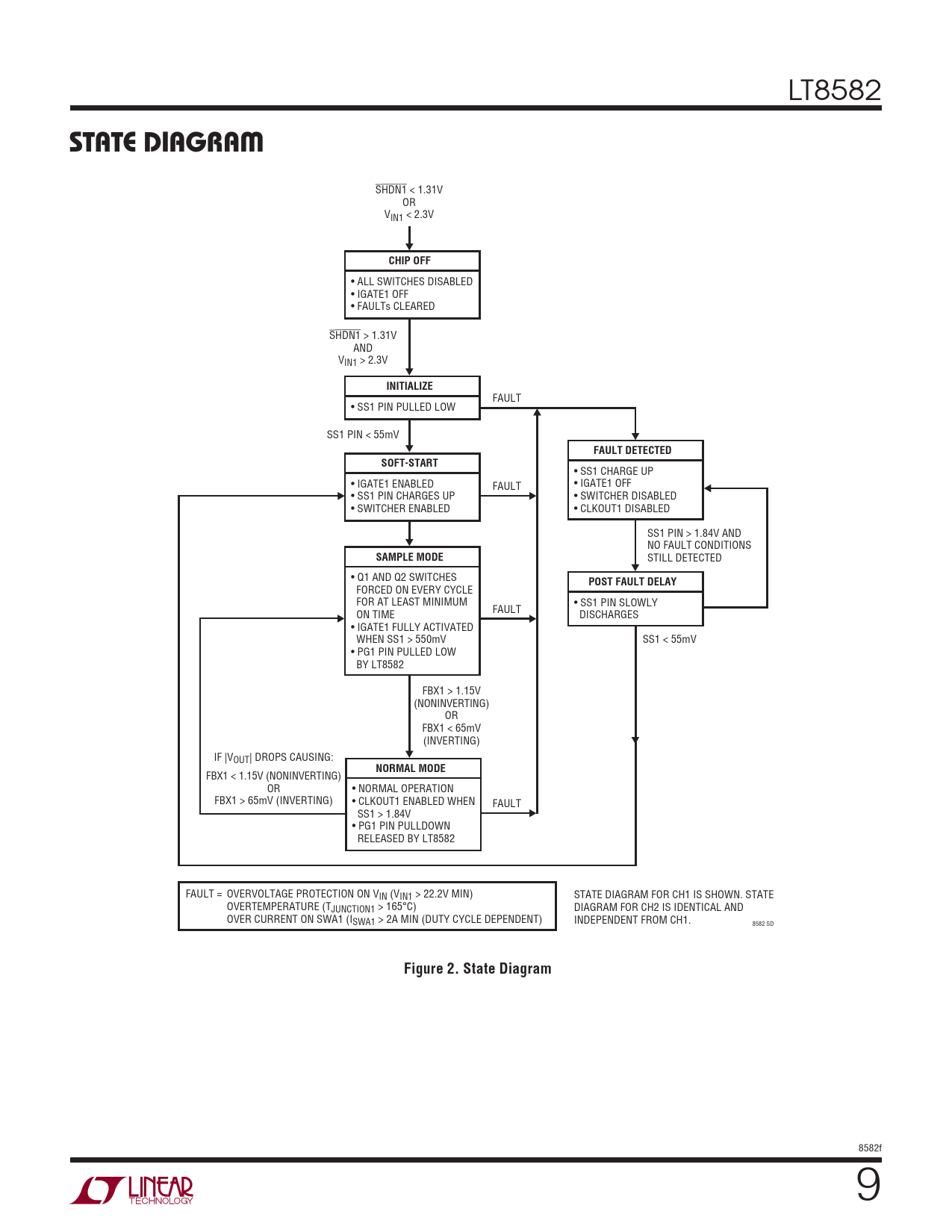

STATE DIAGRAM. CHIP OFF. INITIALIZE. FAULT DETECTED. SOFT-START. SAMPLE MODE. POST FAULT DELAY. NORMAL MODE. Figure 2. State Diagram

STATE DIAGRAM
SHDN17 03 7*/7
CHIP OFF
t"--48*5$)&4%*4"#-&% t*("5&0'' t'"6-5T$-&"3&% SHDN17 "/% 7*/7
INITIALIZE
'"6-5 t441*/16--&%-08 441*/N7
FAULT DETECTED SOFT-START
t44$)"3(&61 t*("5&&/"#-&% t*("5&0'' '"6-5 t441*/$)"3(&461 t48*5$)&3%*4"#-&% t48*5$)&3&/"#-&% t$-,065%*4"#-&% 441*/7"/% /0'"6-5$0/%*5*0/4
SAMPLE MODE
45*--%&5&$5&% t2"/%248*5$)&4
POST FAULT DELAY
'03$&%0/&7&3:$:$-& '03"5-&"45.*/*.6. t441*/4-08-: 0/5*.& '"6-5 %*4$)"3(&4 t*("5&'6--:"$5*7"5&% 8)&/44N7 44N7 t1(1*/16--&%-08 #:-5 '#97 /0/*/7&35*/( 03 '#9N7 */7&35*/( *']7065]%3014$"64*/(
NORMAL MODE
'#97 /0/*/7&35*/( 03 t/03."-01&3"5*0/ '#9N7 */7&35*/( t$-,065&/"#-&%8)&/ '"6-5 447 t1(1*/16--%08/ 3&-&"4&%#:-5 '"6-5 07&370-5"(&1305&$5*0/0/7*/ 7*/7.*/ 45"5&%*"(3".'03$)*44)08/45"5& 07&35&.1&3"563& 5+6/$5*0/¡$ %*"(3".'03$)*4*%&/5*$"-"/% 07&3$633&/50/48" *48"".*/ %65:$:$-&%&1&/%&/5 */%&1&/%&/5'30.$) 8582 SD
