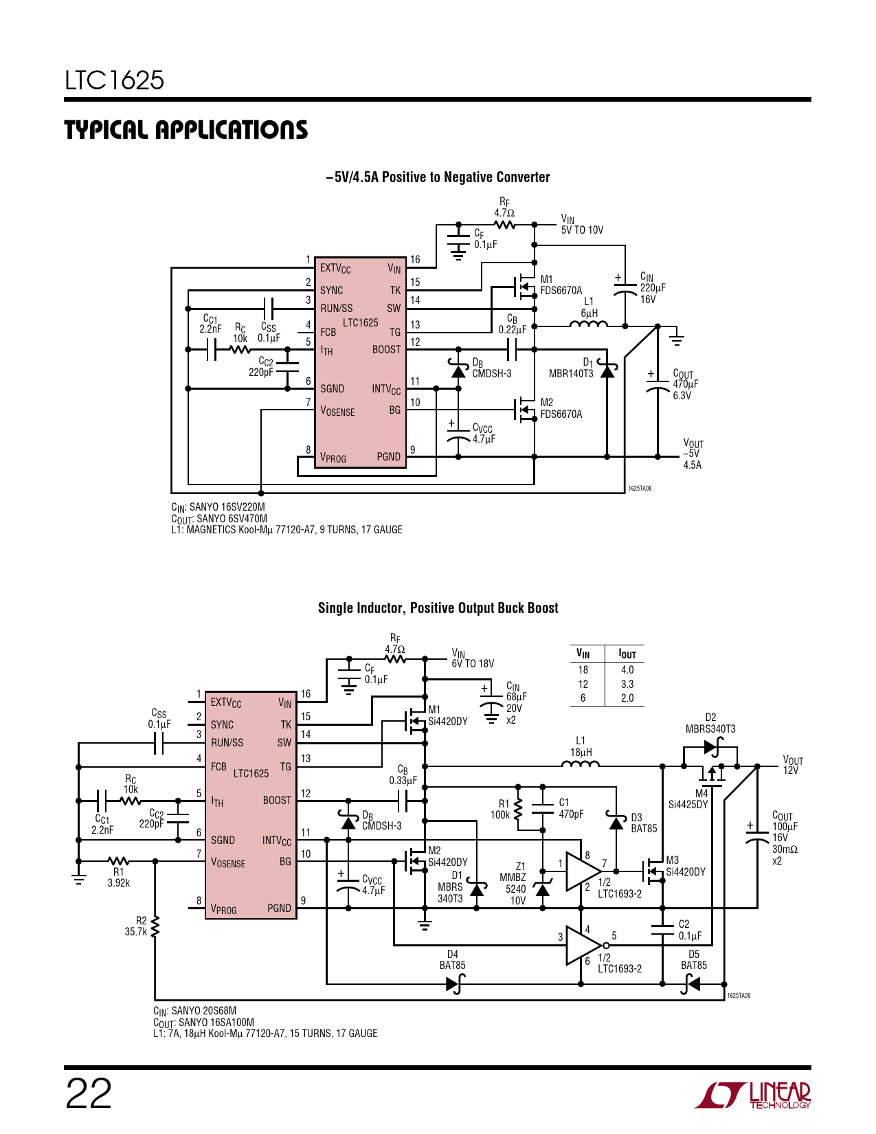

TYPICAL APPLICATIONS. – 5V/4.5A Positive to Negative Converter. Single Inductor, Positive Output Buck Boost. VIN. IOUT
TYPICAL APPLICATIONS – 5V/4.5A Positive to Negative Converter Single Inductor, Positive Output Buck Boost VIN IOUT
LTC1625
U TYPICAL APPLICATIONS – 5V/4.5A Positive to Negative Converter
RF 4.7Ω VIN 5V TO 10V CF 0.1µF 1 16 EXTV V CC IN M1 + CIN 2 15 220 SYNC TK µF FDS6670A 3 14 L1 16V RUN/SS SW 6µH CC1 LTC1625 CB R C 2.2nF 4 13 C SS FCB TG 0.22µF 10k 0.1µF 5 12 I BOOST TH CC2 DB D1 220pF CMDSH-3 MBR140T3 + COUT 6 11 470µF SGND INTVCC 6.3V 7 10 M2 V BG OSENSE FDS6670A + CVCC 4.7µF VOUT 8 9 –5V VPROG PGND 4.5A 1625TA08 CIN: SANYO 16SV220M COUT: SANYO 6SV470M L1: MAGNETICS Kool-Mµ 77120-A7, 9 TURNS, 17 GAUGE
RF 4.7Ω VIN
VIN IOUT
