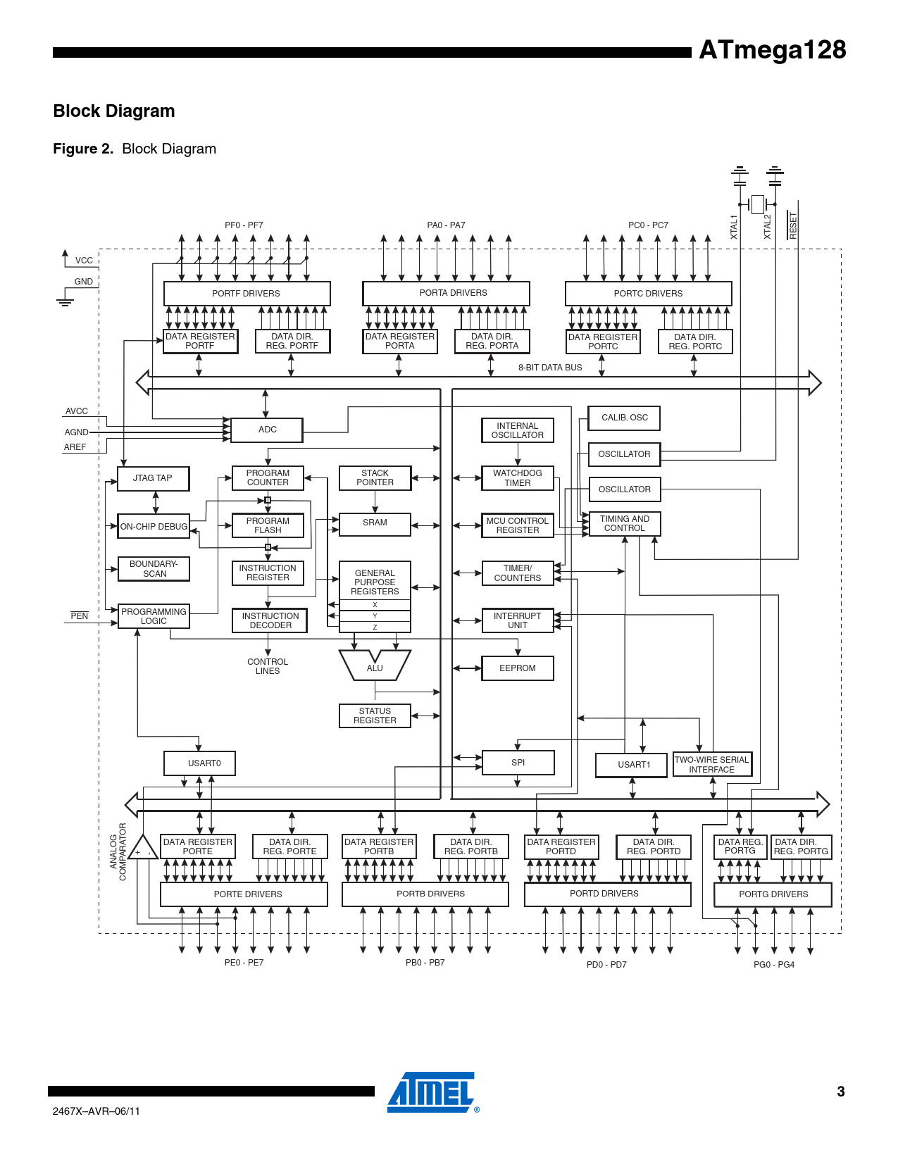

ATmega128. Block Diagram. Figure 2
ATmega128 Block Diagram Figure 2
ATmega128 Block Diagram Figure 2.
Block Diagram PF0 - PF7 PA0 - PA7 PC0 - PC7 AL1 AL2 XT XT RESET VCC GND PORTF DRIVERS PORTA DRIVERS PORTC DRIVERS DATA REGISTER DATA DIR. DATA REGISTER DATA DIR. DATA REGISTER DATA DIR. PORTF REG. PORTF PORTA REG. PORTA PORTC REG. PORTC 8-BIT DATA BUS AVCC CALIB. OSC INTERNAL AGND ADC OSCILLATOR AREF OSCILLATOR PROGRAM STACK WATCHDOG JTAG TAP COUNTER POINTER TIMER OSCILLATOR PROGRAM SRAM MCU CONTROL TIMING AND ON-CHIP DEBUG FLASH REGISTER CONTROL BOUNDARY- INSTRUCTION TIMER/ SCAN GENERAL REGISTER COUNTERS PURPOSE REGISTERS X PROGRAMMING PEN INSTRUCTION Y INTERRUPT LOGIC DECODER Z UNIT CONTROL ALU EEPROM LINES STATUS REGISTER USART0 SPI TWO-WIRE SERIAL USART1 INTERFACE R O T DATA REGISTER DATA DIR. DATA REGISTER DATA DIR. DATA REGISTER DATA DIR. DATA REG. DATA DIR. ARA + - PORTE REG. PORTE PORTB REG. PORTB PORTD REG. PORTD PORTG REG. PORTG ANALOG COMP PORTE DRIVERS PORTB DRIVERS PORTD DRIVERS PORTG DRIVERS PE0 - PE7 PB0 - PB7 PD0 - PD7 PG0 - PG4
