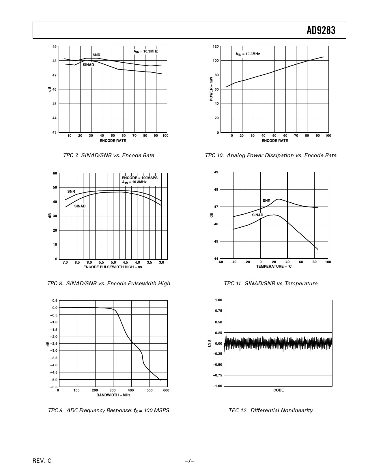

AD9283. 120. AIN = 10.3MHz. SNR. 100. SINAD. mW –. dB 46. POWER. ENCODE RATE. ENCODE = 100MSPS AIN = 10.3MHz. dB 30. 7.0. 6.5. 6.0. 5.5. 5.0. 4.5. 4.0. 3.5
AD9283 120 AIN = 10.3MHz SNR 100 SINAD mW – dB 46 POWER ENCODE RATE ENCODE = 100MSPS AIN = 10.3MHz dB 30 7.0 6.5 6.0 5.5 5.0 4.5 4.0 3.5
AD9283 49 120 AIN = 10.3MHz SNR AIN = 10.3MHz 48 100 SINAD 47 80 mW – dB 46 60 POWER 45 40 44 20 43 0 10 20 30 40 50 60 70 80 90 100 10 20 30 40 50 60 70 80 90 100 ENCODE RATE ENCODE RATE
TPC 7. SINAD/SNR vs. Encode Rate TPC 10. Analog Power Dissipation vs. Encode Rate
60 49 ENCODE = 100MSPS AIN = 10.3MHz 50 48 SNR 40 SNR SINAD 47 SINAD dB 30 dB 46 20 45 10 0 44 7.0 6.5 6.0 5.5 5.0 4.5 4.0 3.5 3.0 –60 –40 –20 0 20 40 60 80 100 ENCODE PULSEWIDTH HIGH – ns TEMPERATURE –
ⴗ
C
TPC 8. SINAD/SNR vs. Encode Pulsewidth High TPC 11. SINAD/SNR vs. Temperature
0.5 1.00 0.0 0.75 –0.5 –1.0 0.50 –1.5 0.25 –2.0 B 0.00 dB –2.5 LS –3.0 –0.25 –3.5 –4.0 –0.50 –4.5 –0.75 –5.0 –5.5 –1.00 0 100 200 300 400 500 600 CODE BANDWIDTH – MHz
TPC 9. ADC Frequency Response: fS = 100 MSPS TPC 12. Differential Nonlinearity REV. C –7–
