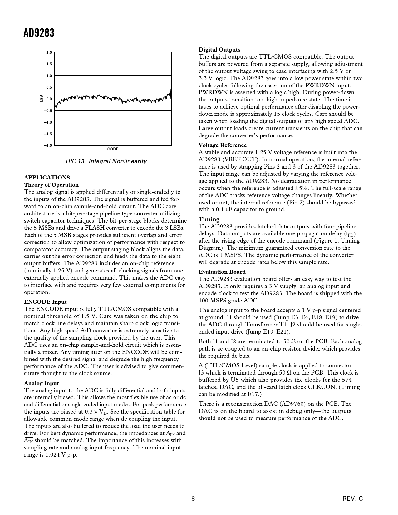

AD9283 Digital Outputs 2.0
The digital outputs are TTL/CMOS compatible. The output
1.5
buffers are powered from a separate supply, allowing adjustment of the output voltage swing to ease interfacing with 2.5 V or
1.0
3.3 V logic. The AD9283 goes into a low power state within two clock cycles following the assertion of the PWRDWN input.
0.5
PWRDWN is asserted with a logic high. During power-down
B 0.0 LS
the outputs transition to a high impedance state. The time it takes to achieve optimal performance after disabling the power-
–0.5
down mode is approximately 15 clock cycles. Care should be
–1.0
taken when loading the digital outputs of any high speed ADC. Large output loads create current transients on the chip that can
–1.5
degrade the converter’s performance.
–2.0 Voltage Reference CODE
A stable and accurate 1.25 V voltage reference is built into the TPC 13. Integral Nonlinearity AD9283 (VREF OUT). In normal operation, the internal refer- ence is used by strapping Pins 2 and 3 of the AD9283 together. The input range can be adjusted by varying the reference volt-
