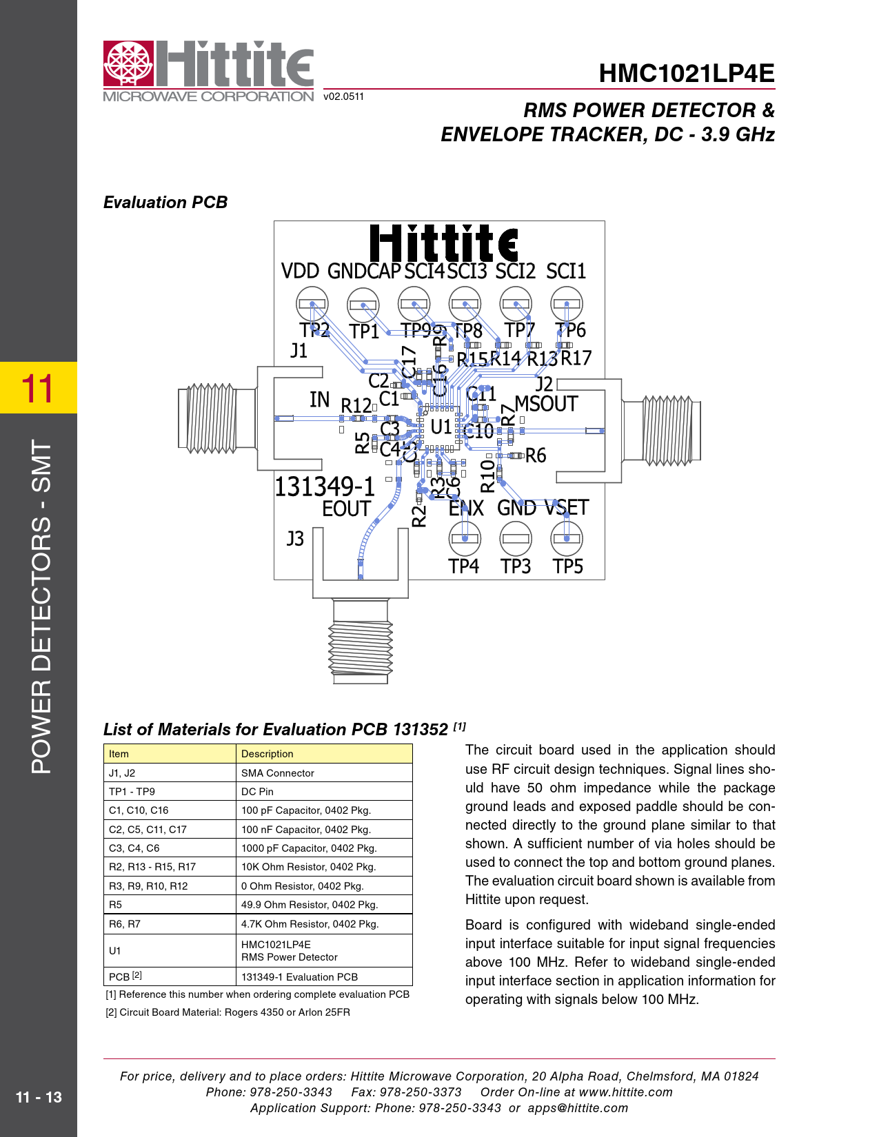

HMC1021LP4E. RMS POWER DETECTOR &. ENVELOPE TRACKER, DC - 3.9 GHz. Evaluation PCB
HMC1021LP4E RMS POWER DETECTOR & ENVELOPE TRACKER, DC - 3.9 GHz Evaluation PCB
HMC1021LP4E
v02.0511
11 t M s - rs o t c e t e D r e w
List of Materials for Evaluation PCB 131352 [1]
o Item Description the circuit board used in the application should P J1, J2 sMA connector use RF circuit design techniques. Signal lines sho- tP1 - tP9 Dc Pin uld have 50 ohm impedance while the package ground leads and exposed paddle should be con- c1, c10, c16 100 pF capacitor, 0402 Pkg. nected directly to the ground plane similar to that c2, c5, c11, c17 100 nF capacitor, 0402 Pkg. shown. A sufficient number of via holes should be c3, c4, c6 1000 pF capacitor, 0402 Pkg. used to connect the top and bottom ground planes. r2, r13 - r15, r17 10K ohm resistor, 0402 Pkg. the evaluation circuit board shown is available from r3, r9, r10, r12 0 ohm resistor, 0402 Pkg. Hittite upon request. r5 49.9 ohm resistor, 0402 Pkg. r6, r7 4.7K ohm resistor, 0402 Pkg. Board is configured with wideband single-ended HMc1021LP4e input interface suitable for input signal frequencies U1 rMs Power Detector above 100 MHz. refer to wideband single-ended PcB [2] 131349-1 evaluation PcB input interface section in application information for [1] reference this number when ordering complete evaluation PcB operating with signals below 100 MHz. [2] circuit Board Material: rogers 4350 or Arlon 25Fr For price, delivery and to place orders: Hittite Microwave Corporation, 20 Alpha Road, Chelmsford, MA 01824
