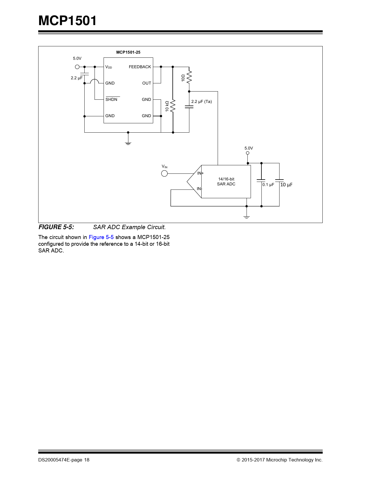

MCP1501. MCP1501-25. 5.0V. FEEDBACK. 10Ω VDD GND OUT SHDN GND GND GND 10 kΩ 2.2 μF 2.2 μF (Ta) 5.0V VIN. IN+. 14/16-bit. SAR ADC

IN-FIGURE 5-5: 0.1 μF 10 μF SAR ADC Example Circuit. The circuit shown in Figure 5-5 shows a MCP1501-25
configured to provide the reference to a 14-bit or 16-bit
SAR ADC. DS20005474E-page 18  2015-2017 Microchip Technology Inc.
