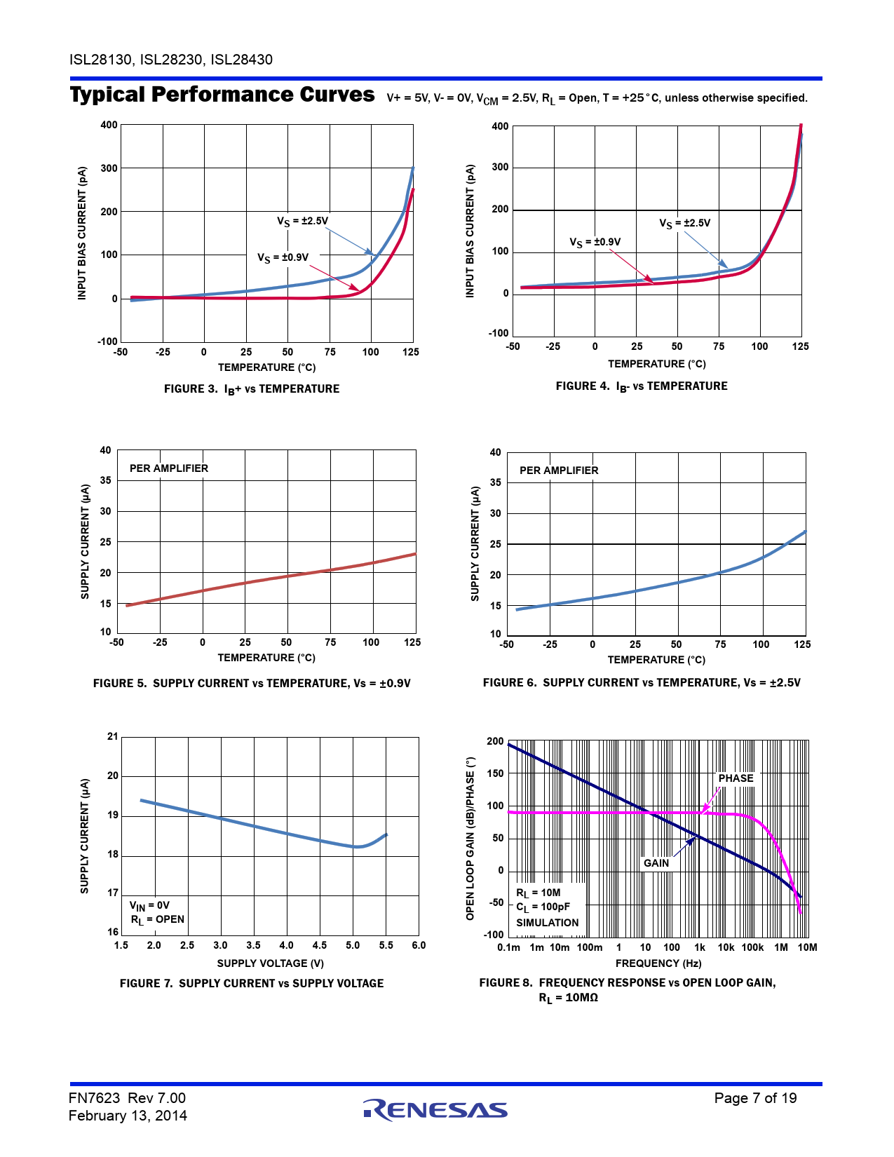

ISL28130, ISL28230, ISL28430 n Typical Performance Curves V+ = 5V, V- = 0V, VCM = 2.5V, RL = Open, T = +25°C, unless otherwise specified.
400 400 ) 300 300 200 200 VS = ±2.5V VS = ±2.5V CURRENT (pA VS = ±0.9V 100 100 V IAS CURRENT (pA) S = ±0.9V T BIAS U INP 0 0 INPUT B -100 -100-50 -25 0 25 50 75 100 125 -50 -25 0 25 50 75 100 125 TEMPERATURE (°C) TEMPERATURE (°C)
FIGURE 3. IB+ vs TEMPERATURE FIGURE 4. IB- vs TEMPERATURE
40 40 PER AMPLIFIER PER AMPLIFIER 35 35 30 30 25 25 CURRENT (µA) CURRENT (µA) LY 20 LY 20 SUPP 15 SUPP 15 10 10 -50 -25 0 25 50 75 100 125 -50 -25 0 25 50 75 100 125 TEMPERATURE (°C) TEMPERATURE (°C)
FIGURE 5. SUPPLY CURRENT vs TEMPERATURE, Vs = ±0.9V FIGURE 6. SUPPLY CURRENT vs TEMPERATURE, Vs = ±2.5V
21 200 (°) 20 150 PHASE ASE (µA) PH 100 NT )/ 19 B RE (d IN 50 A 18 Y CUR G P GAIN 0 PPL U OO S 17 L N RL = 10M V E -50 IN = 0V P CL = 100pF RL = OPEN O SIMULATION 16 -100 1.5 2.0 2.5 3.0 3.5 4.0 4.5 5.0 5.5 6.0 0.1m 1m 10m 100m 1 10 100 1k 10k 100k 1M 10M SUPPLY VOLTAGE (V) FREQUENCY (Hz)
FIGURE 7. SUPPLY CURRENT vs SUPPLY VOLTAGE FIGURE 8. FREQUENCY RESPONSE vs OPEN LOOP GAIN, RL = 10MΩ FN7623 Rev 7.00 Page 7 of 19 February 13, 2014
