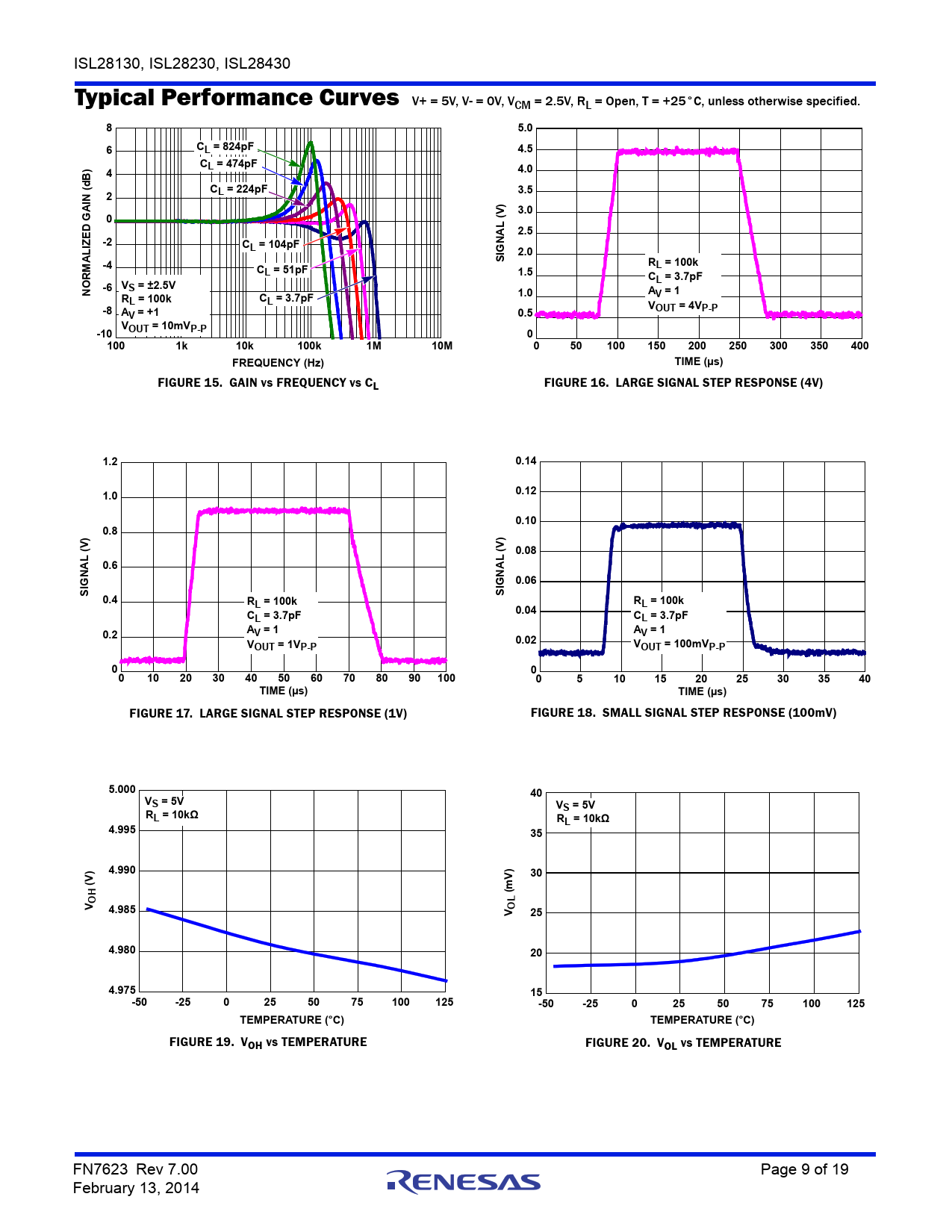

ISL28130, ISL28230, ISL28430 Typical Performance Curves V+ = 5V, V- = 0V, VCM = 2.5V, RL = Open, T = +25°C, unless otherwise specified.
8 5.0 6 CL = 824pF 4.5 CL = 474pF 4 4.0 C 3.5 2 L = 224pF 3.0 0 (V) 2.5 -2 IZED GAIN (dB) C L L = 104pF IGNAL 2.0 S -4 R C L = 100k L = 51pF 1.5 CL = 3.7pF -6 V NORMA S = ±2.5V A R C 1.0 V = 1 L = 100k L = 3.7pF -8 V A OUT = 4VP-P V = +1 0.5 V -10 OUT = 10mVP-P 0 100 1k 10k 100k 1M 10M 0 50 100 150 200 250 300 350 400 FREQUENCY (Hz) TIME (µs)
FIGURE 15. GAIN vs FREQUENCY vs CL FIGURE 16. LARGE SIGNAL STEP RESPONSE (4V)
1.2 0.14 1.0 0.12 0.10 0.8 ) (V) 0.08 0.6 GNAL 0.06 SIGNAL (V SI 0.4 RL = 100k RL = 100k C 0.04 L = 3.7pF CL = 3.7pF 0.2 AV = 1 AV = 1 V 0.02 OUT = 1VP-P VOUT = 100mVP-P 0 0 0 10 20 30 40 50 60 70 80 90 100 0 5 10 15 20 25 30 35 40 TIME (µs) TIME (µs)
FIGURE 17. LARGE SIGNAL STEP RESPONSE (1V) FIGURE 18. SMALL SIGNAL STEP RESPONSE (100mV)
5.000 40 VS = 5V VS = 5V RL = 10kΩ RL = 10kΩ 4.995 35 ) 4.990 ) V 30 V ( m ( OHV 4.985 OLV 25 4.980 20 4.975 15 -50 -25 0 25 50 75 100 125 -50 -25 0 25 50 75 100 125 TEMPERATURE (°C) TEMPERATURE (°C)
FIGURE 19. VOH vs TEMPERATURE FIGURE 20. VOL vs TEMPERATURE FN7623 Rev 7.00 Page 9 of 19 February 13, 2014
