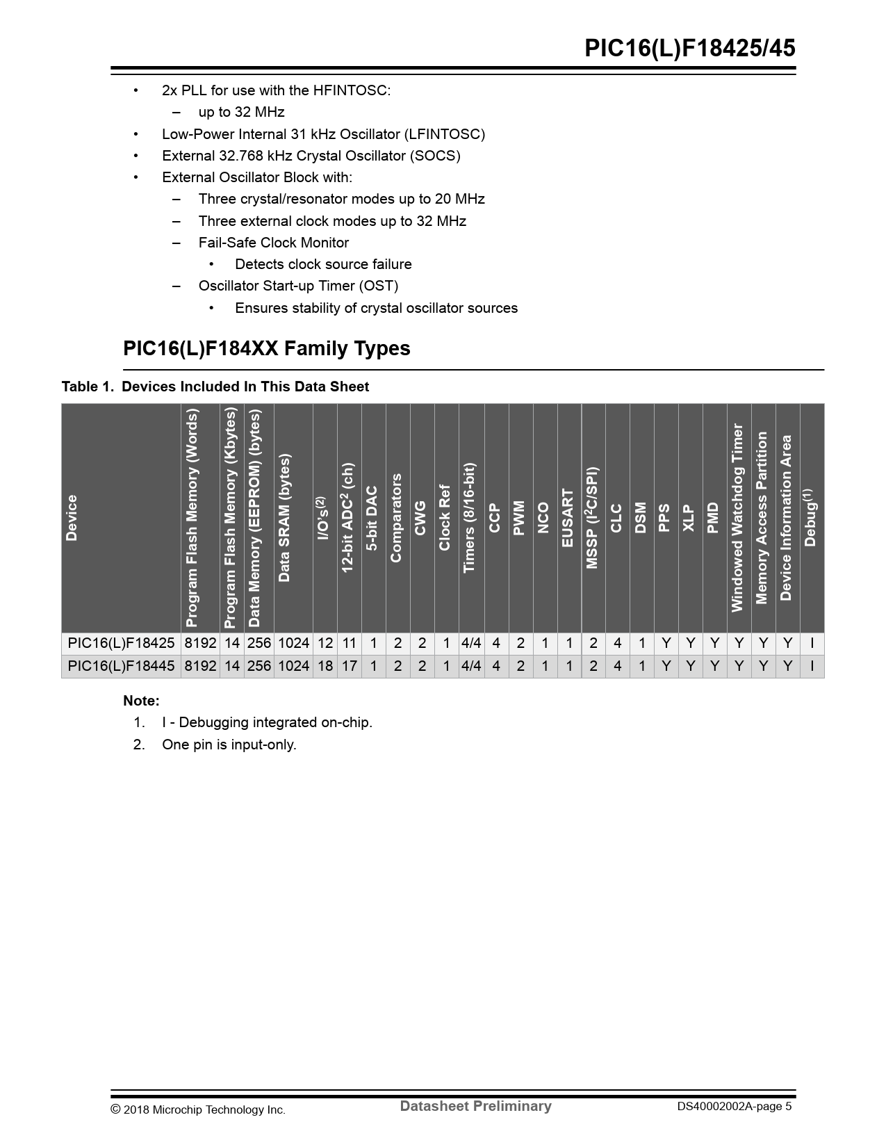

PIC16(L)F18425/45
• 2x PLL for use with the HFINTOSC: – up to 32 MHz • Low-Power Internal 31 kHz Oscillator (LFINTOSC) • External 32.768 kHz Crystal Oscillator (SOCS) • External Oscillator Block with: – Three crystal/resonator modes up to 20 MHz – Three external clock modes up to 32 MHz – Fail-Safe Clock Monitor • Detects clock source failure – Oscillator Start-up Timer (OST) • Ensures stability of crystal oscillator sources
PIC16(L)F184XX Family Types Table 1. Devices Included In This Data Sheet ords) imer (ch)2 (1) (2) s C/SPI)2 atchdog T CLC Device I/O’ CWG CCP PWM NCO DSM PPS XLP PMD 5-bit DAC Clock Ref EUSART Debug Comparators imers (8/16-bit) 12-bit ADC T MSSP (I Data SRAM (bytes) indowed W W Memory Access Partition Device Information Area Program Flash Memory (W Program Flash Memory (Kbytes) Data Memory (EEPROM) (bytes)
PIC16(L)F18425 8192 14 256 1024 12 11 1 2 2 1 4/4 4 2 1 1 2 4 1 Y Y Y Y Y Y I PIC16(L)F18445 8192 14 256 1024 18 17 1 2 2 1 4/4 4 2 1 1 2 4 1 Y Y Y Y Y Y I
Note: 
1. I - Debugging integrated on-chip. 2. One pin is input-only. © 2018 Microchip Technology Inc.
