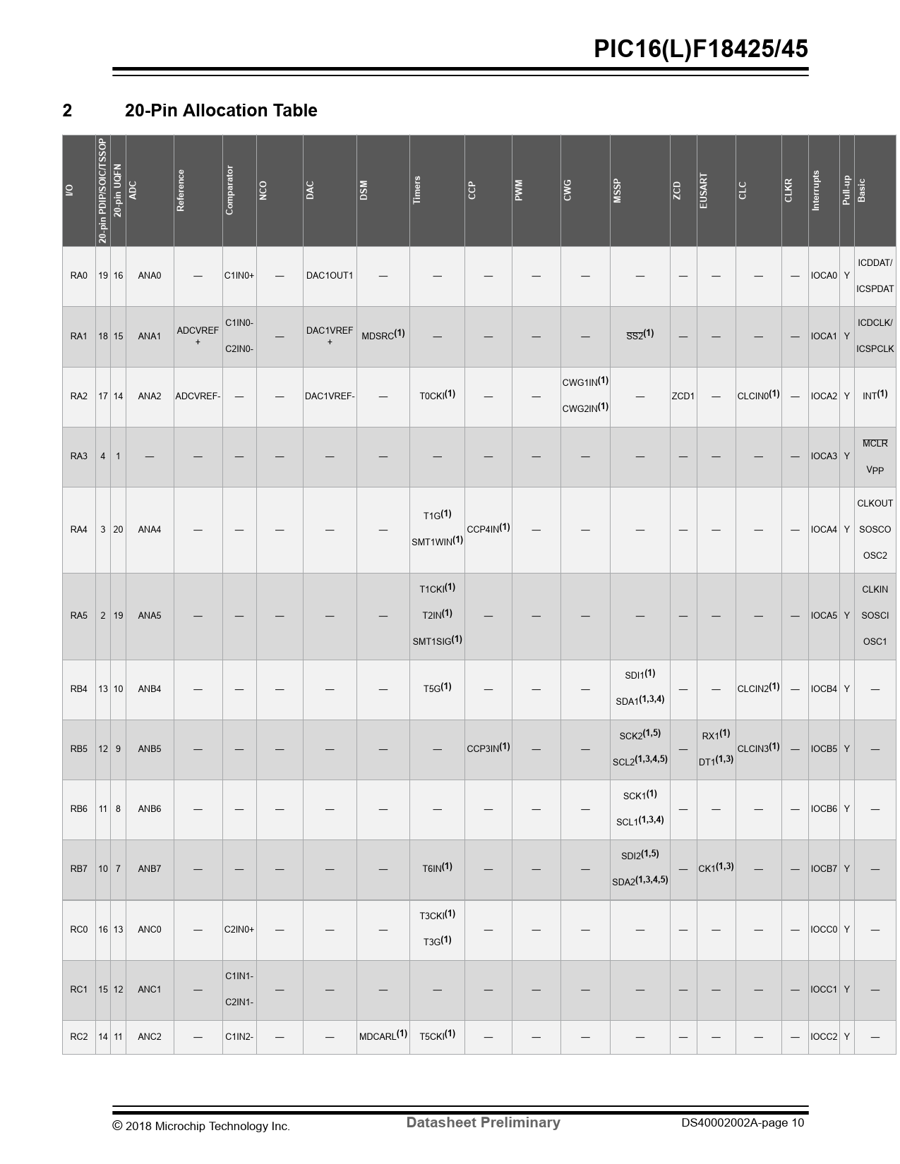

Pages / Page756 / 10 — PIC16(L)F18425/45. 20-Pin Allocation Table. I/O. ADC. NCO. DAC. DSM. …
File Format / SizePDF / 7.8 Mb
PIC16(L)F18425/45. 20-Pin Allocation Table. I/O. ADC. NCO. DAC. DSM. imers. CCP. CLC. PWM. CWG. MSSP. ZCD. CLKR. Pull-up. Basic. Reference. EUSART
PIC16(L)F18425/45 20-Pin Allocation Table I/O ADC NCO DAC DSM imers CCP CLC PWM CWG MSSP ZCD CLKR Pull-up Basic Reference EUSART
PIC16(L)F18425/45 2 20-Pin Allocation Table I/O ADC NCO DAC DSM imers CCP CLC T PWM CWG MSSP ZCD CLKR Pull-up Basic Reference EUSART Interrupts 20-pin UQFN Comparator 20-pin PDIP/SOIC/TSSOP
ICDDAT/ RA0 19 16 ANA0 — C1IN0+ — DAC1OUT1 — — — — — — — — — — IOCA0 Y ICSPDAT C1IN0- ICDCLK/ ADCVREF DAC1VREF RA1 18 15 ANA1 — MDSRC
(1)
— — — — SS2
(1)
— — — — IOCA1 Y + + C2IN0- ICSPCLK CWG1IN
(1)
RA2 17 14 ANA2 ADCVREF- — — DAC1VREF- — T0CKI
(1)
— — — ZCD1 — CLCIN0
(1)
— IOCA2 Y INT
(1)
CWG2IN
(1)
MCLR RA3 4 1 — — — — — — — — — — — — — — — IOCA3 Y VPP CLKOUT T1G
(1)
RA4 3 20 ANA4 — — — — — CCP4IN
(1)
— — — — — — — IOCA4 Y SOSCO SMT1WIN
(1)
OSC2 T1CKI
(1)
CLKIN RA5 2 19 ANA5 — — — — — T2IN
(1)
— — — — — — — — IOCA5 Y SOSCI SMT1SIG
(1)
OSC1 SDI1
(1)
RB4 13 10 ANB4 — — — — — T5G
(1)
— — — — — CLCIN2
(1)
— IOCB4 Y — SDA1
(1,3,4)
SCK2
(1,5)
RX1
(1)
RB5 12 9 ANB5 — — — — — — CCP3IN
(1)
— — — CLCIN3
(1)
— IOCB5 Y — SCL2
(1,3,4,5)
DT1
(1,3)
SCK1
(1)
RB6 11 8 ANB6 — — — — — — — — — — — — — IOCB6 Y — SCL1
(1,3,4)
SDI2
(1,5)
RB7 10 7 ANB7 — — — — — T6IN
(1)
— — — — CK1
(1,3)
— — IOCB7 Y — SDA2
(1,3,4,5)
T3CKI
(1)
RC0 16 13 ANC0 — C2IN0+ — — — — — — — — — — — IOCC0 Y — T3G
(1)
C1IN1- RC1 15 12 ANC1 — — — — — — — — — — — — — IOCC1 Y — C2IN1- RC2 14 11 ANC2 — C1IN2- — — MDCARL
(1)
T5CKI
(1)
— — — — — — — — IOCC2 Y — © 2018 Microchip Technology Inc.
