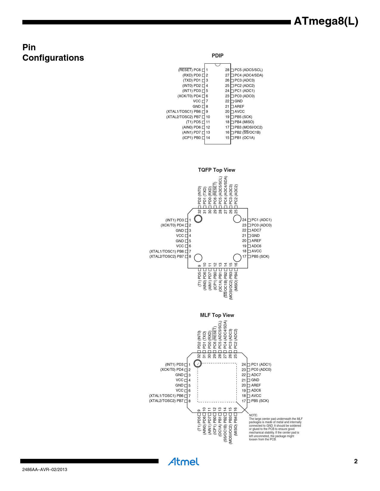

ATmega8(L). Pin Configurations. PDIP. TQFP Top View. MLF Top View
ATmega8(L) Pin Configurations PDIP TQFP Top View MLF Top View
(RESET) PC6 1 28 PC5 (ADC5/SCL) (RXD) PD0 2 27 PC4 (ADC4/SDA) (TXD) PD1 3 26 PC3 (ADC3) (INT0) PD2 4 25 PC2 (ADC2) (INT1) PD3 5 24 PC1 (ADC1) (XCK/T0) PD4 6 23 PC0 (ADC0) VCC 7 22 GND GND 8 21 AREF (XTAL1/TOSC1) PB6 9 20 AVCC (XTAL2/TOSC2) PB7 10 19 PB5 (SCK) (T1) PD5 11 18 PB4 (MISO) (AIN0) PD6 12 17 PB3 (MOSI/OC2) (AIN1) PD7 13 16 PB2 (SS/OC1B) (ICP1) PB0 14 15 PB1 (OC1A)
TQFP Top View
PD2 (INT0) PD1 (TXD) PD0 (RXD) PC6 (RESET) PC5 (ADC5/SCL) PC4 (ADC4/SDA) PC3 (ADC3) PC2 (ADC2) 32 31 30 29 28 27 26 25 (INT1) PD3 1 24 PC1 (ADC1) (XCK/T0) PD4 2 23 PC0 (ADC0) GND 3 22 ADC7 VCC 4 21 GND GND 5 20 AREF VCC 6 19 ADC6 (XTAL1/TOSC1) PB6 7 18 AVCC (XTAL2/TOSC2) PB7 8 17 PB5 (SCK) 9 10 11 12 13 14 15 16 (T1) PD5 (AIN0) PD6 (AIN1) PD7 (ICP1) PB0 (OC1A) PB1 (MISO) PB4 (SS/OC1B) PB2 (MOSI/OC2) PB3
MLF Top View
PD2 (INT0) PD1 (TXD) PD0 (RXD) PC6 (RESET) PC5 (ADC5/SCL) PC4 (ADC4/SDA) PC3 (ADC3) PC2 (ADC2) 32 31 30 29 28 27 26 25 (INT1) PD3 1 24 PC1 (ADC1) (XCK/T0) PD4 2 23 PC0 (ADC0) GND 3 22 ADC7 VCC 4 21 GND GND 5 20 AREF VCC 6 19 ADC6 (XTAL1/TOSC1) PB6 7 18 AVCC (XTAL2/TOSC2) PB7 8 17 PB5 (SCK) 9 10 11 12 13 14 15 16 NOTE: The large center pad underneath the MLF packages is made of metal and internally connected to GND. It should be soldered (T1) PD5 or glued to the PCB to ensure good (AIN0) PD6 (AIN1) PD7 (ICP1) PB0 mechanical stability. If the center pad is (OC1A) PB1 (MISO) PB4 left unconneted, the package might loosen from the PCB. (SS/OC1B) PB2 (MOSI/OC2) PB3
