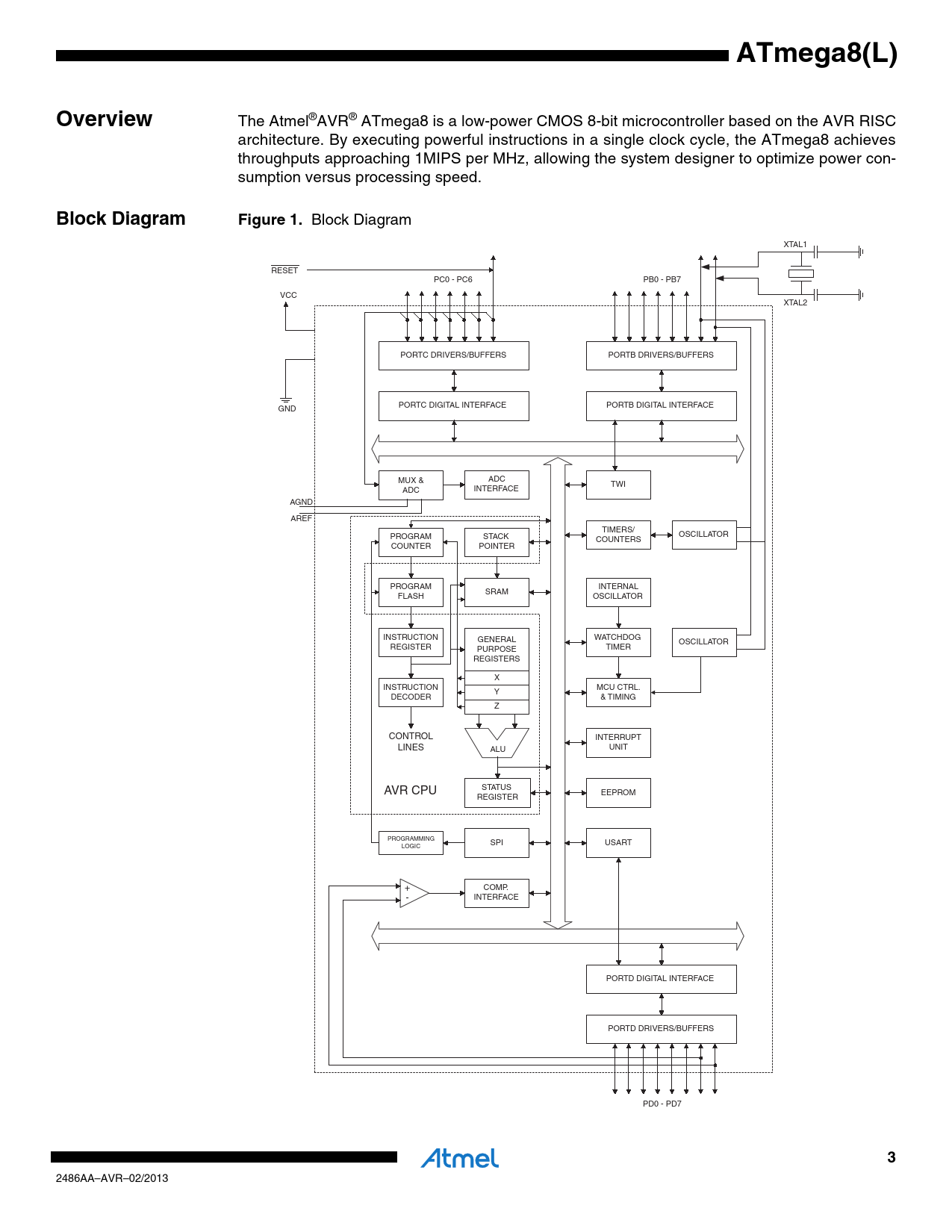

ATmega8(L). Overview. Block Diagram. Figure 1
ATmega8(L) Overview Block Diagram Figure 1
ATmega8(L) Overview
The Atmel®AVR® ATmega8 is a low-power CMOS 8-bit microcontroller based on the AVR RISC architecture. By executing powerful instructions in a single clock cycle, the ATmega8 achieves throughputs approaching 1MIPS per MHz, allowing the system designer to optimize power con- sumption versus processing speed.
Block Diagram Figure 1.
Block Diagram XTAL1 RESET PC0 - PC6 PB0 - PB7 VCC XTAL2 PORTC DRIVERS/BUFFERS PORTB DRIVERS/BUFFERS PORTC DIGITAL INTERFACE PORTB DIGITAL INTERFACE GND MUX & ADC TWI ADC INTERFACE AGND AREF TIMERS/ OSCILLATOR PROGRAM STACK COUNTERS COUNTER POINTER PROGRAM INTERNAL SRAM FLASH OSCILLATOR INSTRUCTION WATCHDOG GENERAL OSCILLATOR REGISTER TIMER PURPOSE REGISTERS X INSTRUCTION MCU CTRL. Y DECODER & TIMING Z CONTROL INTERRUPT LINES UNIT ALU STATUS AVR CPU EEPROM REGISTER PROGRAMMING SPI USART LOGIC + COMP. - INTERFACE PORTD DIGITAL INTERFACE PORTD DRIVERS/BUFFERS PD0 - PD7
