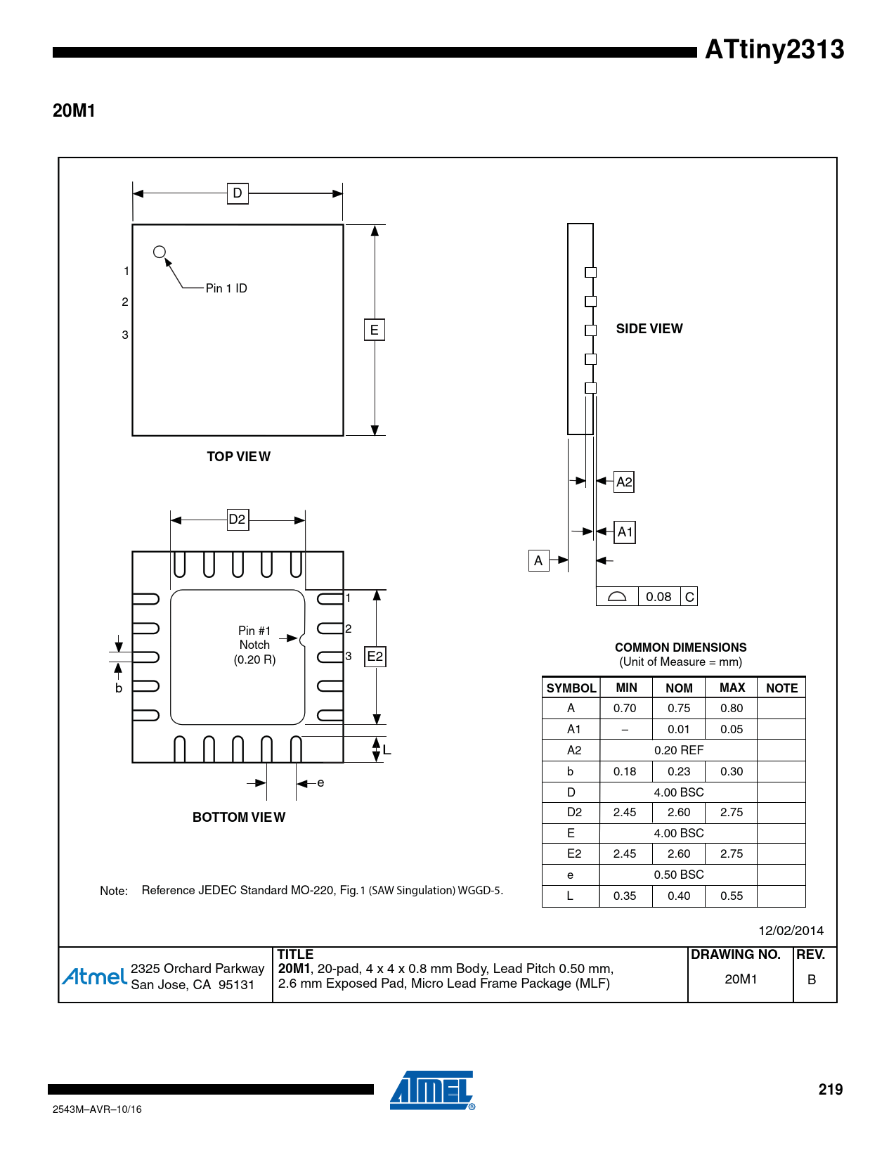

ATtiny2313. 20M1. SIDE VIEW. TOP VIEW. COMMON DIMENSIONS. SYMBOL. MIN. NOM. MAX. NOTE. BOTTOM VIEW. TITLE. DRAWING NO. REV. 219
ATtiny2313 20M1 SIDE VIEW TOP VIEW COMMON DIMENSIONS SYMBOL MIN NOM MAX NOTE BOTTOM VIEW TITLE DRAWING NO REV 219
ATtiny2313 20M1
D 1 Pin 1 ID 2 E
SIDE VIEW
3
TOP VIEW
A2 D2 A1 A 1 0.08 C Pin #1 2 Notch
COMMON DIMENSIONS
(0.20 R) 3 E2 (Unit of Measure = mm) b
A 0.70 0.75 0.80 A1 – 0.01 0.05 L A2 0.20 REF b 0.18 0.23 0.30 e D 4.00 BSC D2 2.45 2.60 2.75
BOTTOM VIEW
E 4.00 BSC E2 2.45 2.60 2.75 e 0.50 BSC Note: Reference JEDEC Standard MO-220, Fig. 1 (SAW Singulation) WGGD-5. L 0.35 0.40 0.55 12/02/2014
TITLE DRAWING NO. REV.
2325 Orchard Parkway
20M1
, 20-pad, 4 x 4 x 0.8 mm Body, Lead Pitch 0.50 mm, San Jose, CA 95131 20M1 B 2.6 mm Exposed Pad, Micro Lead Frame Package (MLF)
