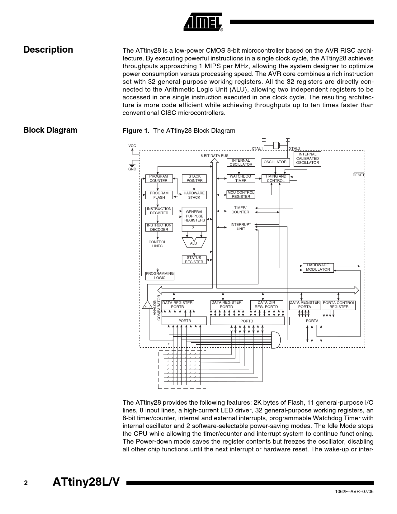

Description. Block Diagram. Figure 1. ATtiny28L/V
Description Block Diagram Figure 1 ATtiny28L/V
The ATtiny28 is a low-power CMOS 8-bit microcontroller based on the AVR RISC archi- tecture. By executing powerful instructions in a single clock cycle, the ATtiny28 achieves throughputs approaching 1 MIPS per MHz, allowing the system designer to optimize power consumption versus processing speed. The AVR core combines a rich instruction set with 32 general-purpose working registers. All the 32 registers are directly con- nected to the Arithmetic Logic Unit (ALU), allowing two independent registers to be accessed in one single instruction executed in one clock cycle. The resulting architec- ture is more code efficient while achieving throughputs up to ten times faster than conventional CISC microcontrollers.
Block Diagram Figure 1.
The ATtiny28 Block Diagram VCC XTAL1 XTAL2 8-BIT DATA BUS INTERNAL CALIBRATED INTERNAL OSCILLATOR OSCILLATOR OSCILLATOR GND PROGRAM STACK WATCHDOG TIMING AND RESET COUNTER POINTER TIMER CONTROL PROGRAM HARDWARE MCU CONTROL FLASH STACK REGISTER INSTRUCTION TIMER/ GENERAL REGISTER COUNTER PURPOSE REGISTERS INSTRUCTION INTERRUPT DECODER Z UNIT CONTROL ALU LINES STATUS REGISTER HARDWARE MODULATOR PROGRAMMING LOGIC DATA REGISTER DATA REGISTER DATA DIR DATA REGISTER PORTA CONTROL + - PORTB PORTD REG. PORTD PORTA REGISTER ANALOG COMPARATOR PORTB PORTD PORTA The ATtiny28 provides the following features: 2K bytes of Flash, 11 general-purpose I/O lines, 8 input lines, a high-current LED driver, 32 general-purpose working registers, an 8-bit timer/counter, internal and external interrupts, programmable Watchdog Timer with internal oscillator and 2 software-selectable power-saving modes. The Idle Mode stops the CPU while allowing the timer/counter and interrupt system to continue functioning. The Power-down mode saves the register contents but freezes the oscillator, disabling all other chip functions until the next interrupt or hardware reset. The wake-up or inter-
