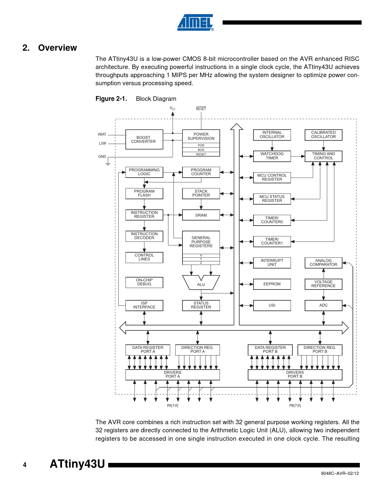

Overview. Figure 2-1. ATtiny43U
Overview Figure 2-1 ATtiny43U
2. Overview
The ATtiny43U is a low-power CMOS 8-bit microcontroller based on the AVR enhanced RISC architecture. By executing powerful instructions in a single clock cycle, the ATtiny43U achieves throughputs approaching 1 MIPS per MHz allowing the system designer to optimize power con- sumption versus processing speed.
Figure 2-1.
Block Diagram VCC RESET INTERNAL CALIBRATED VBAT POWER BOOST OSCILLATOR OSCILLATOR SUPERVISION CONVERTER LSW POR BOD RESET WATCHDOG TIMING AND GND TIMER CONTROL PROGRAMMING PROGRAM LOGIC COUNTER MCU CONTROL REGISTER PROGRAM STACK FLASH POINTER MCU STATUS REGISTER INSTRUCTION SRAM REGISTER TIMER/ COUNTER0 INSTRUCTION DECODER GENERAL TIMER/ PURPOSE COUNTER1 REGISTERS CONTROL X LINES Y INTERRUPT ANALOG Z UNIT COMPARATOR ON-CHIP VOLTAGE DEBUG ALU EEPROM REFERENCE ISP STATUS INTERFACE USI ADC REGISTER DATA REGISTER DIRECTION REG. DATA REGISTER DIRECTION REG. PORT A PORT A PORT B PORT B DRIVERS DRIVERS PORT A PORT B PA[7:0] PB[7:0] The AVR core combines a rich instruction set with 32 general purpose working registers. All the 32 registers are directly connected to the Arithmetic Logic Unit (ALU), allowing two independent registers to be accessed in one single instruction executed in one clock cycle. The resulting
