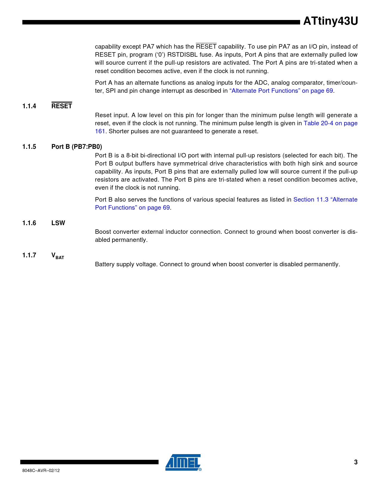

ATtiny43U
capability except PA7 which has the RESET capability. To use pin PA7 as an I/O pin, instead of RESET pin, program (‘0’) RSTDISBL fuse. As inputs, Port A pins that are externally pulled low will source current if the pull-up resistors are activated. The Port A pins are tri-stated when a reset condition becomes active, even if the clock is not running. Port A has an alternate functions as analog inputs for the ADC, analog comparator, timer/coun- ter, SPI and pin change interrupt as described in “Alternate Port Functions” on page 69.
1.1.4 RESET
Reset input. A low level on this pin for longer than the minimum pulse length will generate a reset, even if the clock is not running. The minimum pulse length is given in Table 20-4 on page 161. Shorter pulses are not guaranteed to generate a reset.
1.1.5 Port B (PB7:PB0)
Port B is a 8-bit bi-directional I/O port with internal pull-up resistors (selected for each bit). The Port B output buffers have symmetrical drive characteristics with both high sink and source capability. As inputs, Port B pins that are externally pulled low will source current if the pull-up resistors are activated. The Port B pins are tri-stated when a reset condition becomes active, even if the clock is not running. Port B also serves the functions of various special features as listed in Section 11.3 “Alternate Port Functions” on page 69.
1.1.6 LSW
Boost converter external inductor connection. Connect to ground when boost converter is dis- abled permanently.
1.1.7 VBAT
Battery supply voltage. Connect to ground when boost converter is disabled permanently.
