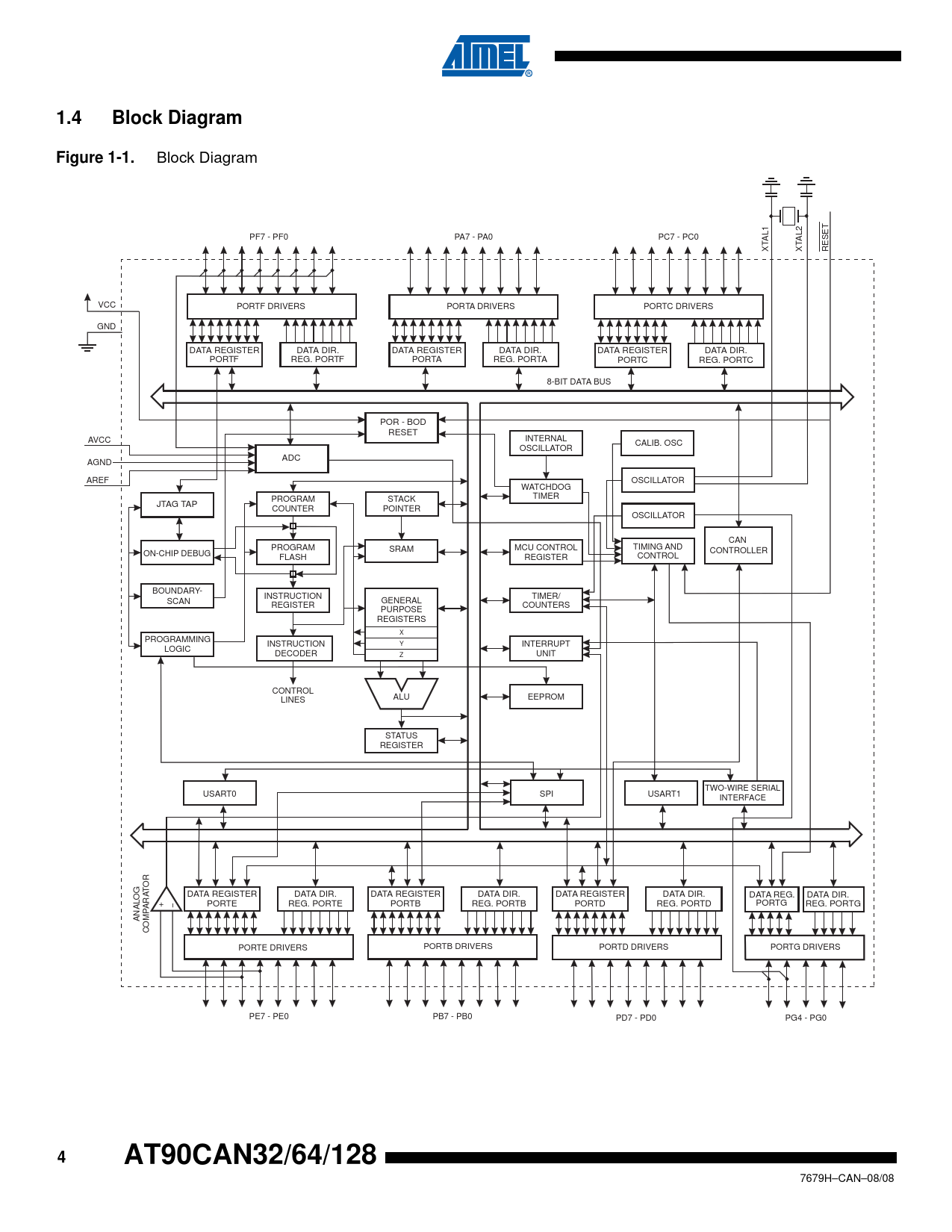

1.4. Block Diagram. Figure 1-1. AT90CAN32/64/128
1.4 Block Diagram Figure 1-1 AT90CAN32/64/128
1.4 Block Diagram Figure 1-1.
Block Diagram PF7 - PF0 PA7 - PA0 PC7 - PC0 AL1 AL2 XT XT RESET VCC PORTF DRIVERS PORTA DRIVERS PORTC DRIVERS GND DATA REGISTER DATA DIR. DATA REGISTER DATA DIR. DATA REGISTER DATA DIR. PORTF REG. PORTF PORTA REG. PORTA PORTC REG. PORTC 8-BIT DATA BUS POR - BOD RESET AVCC INTERNAL CALIB. OSC OSCILLATOR ADC AGND AREF OSCILLATOR WATCHDOG PROGRAM STACK TIMER JTAG TAP COUNTER POINTER OSCILLATOR CAN PROGRAM SRAM MCU CONTROL TIMING AND ON-CHIP DEBUG CONTROLLER FLASH REGISTER CONTROL BOUNDARY- INSTRUCTION TIMER/ SCAN GENERAL REGISTER COUNTERS PURPOSE REGISTERS X PROGRAMMING INSTRUCTION Y INTERRUPT LOGIC DECODER Z UNIT CONTROL ALU EEPROM LINES STATUS REGISTER TWO-WIRE SERIAL USART0 SPI USART1 INTERFACE R O T DATA REGISTER DATA DIR. DATA REGISTER DATA DIR. DATA REGISTER DATA DIR. DATA REG. DATA DIR. ARA + - PORTE REG. PORTE PORTB REG. PORTB PORTD REG. PORTD PORTG REG. PORTG ANALOG COMP PORTE DRIVERS PORTB DRIVERS PORTD DRIVERS PORTG DRIVERS PE7 - PE0 PB7 - PB0 PD7 - PD0 PG4 - PG0
4 AT90CAN32/64/128
