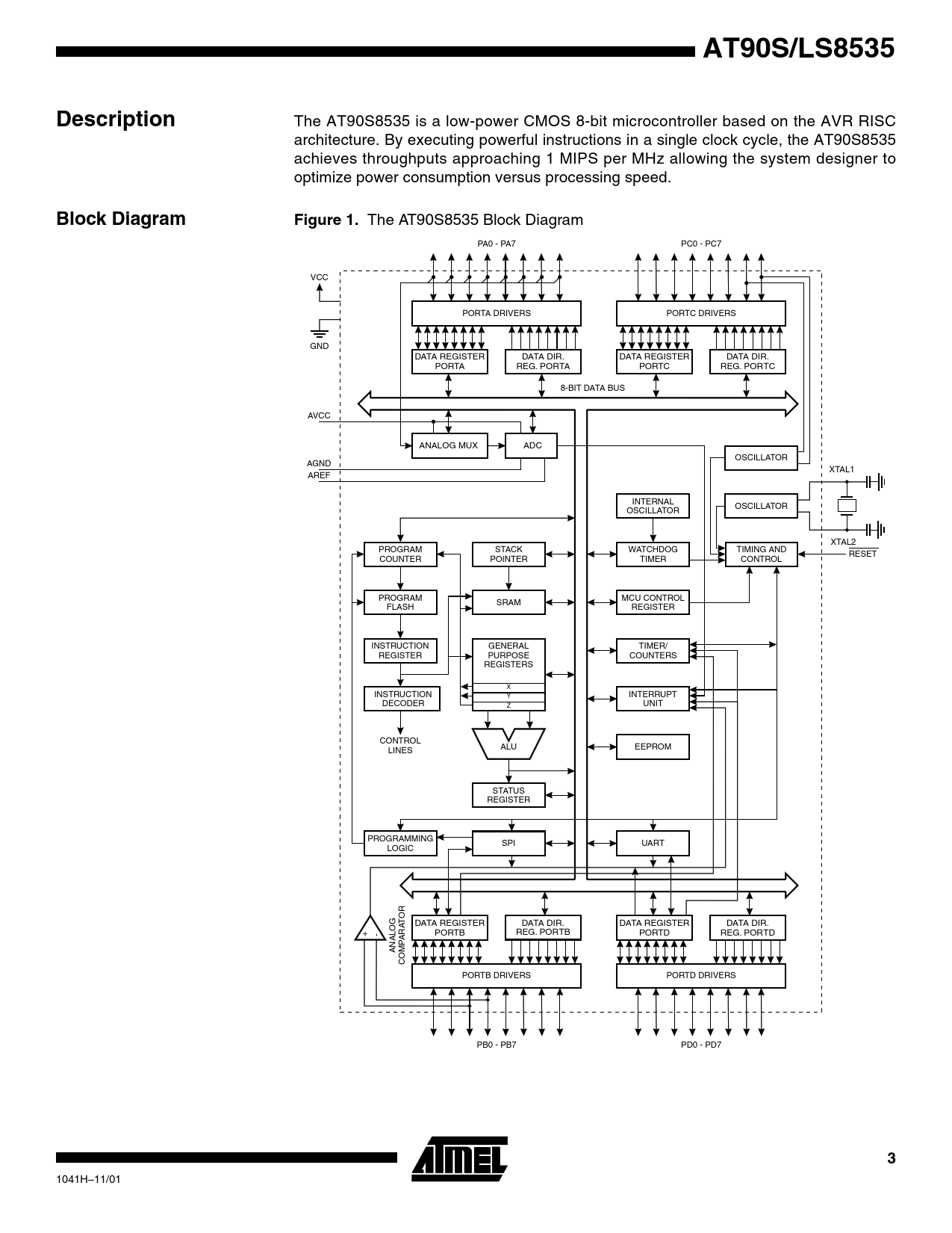

AT90S/LS8535 Description
The AT90S8535 is a low-power CMOS 8-bit microcontroller based on the AVR RISC architecture. By executing powerful instructions in a single clock cycle, the AT90S8535 achieves throughputs approaching 1 MIPS per MHz allowing the system designer to optimize power consumption versus processing speed.
Block Diagram Figure 1.
The AT90S8535 Block Diagram PA0 - PA7 PC0 - PC7 VCC PORTA DRIVERS PORTC DRIVERS GND DATA REGISTER DATA DIR. DATA REGISTER DATA DIR. PORTA REG. PORTA PORTC REG. PORTC 8-BIT DATA BUS AVCC ANALOG MUX ADC OSCILLATOR AGND XTAL1 AREF INTERNAL OSCILLATOR OSCILLATOR XTAL2 PROGRAM STACK WATCHDOG TIMING AND RESET COUNTER POINTER TIMER CONTROL PROGRAM MCU CONTROL SRAM FLASH REGISTER INSTRUCTION GENERAL TIMER/ REGISTER PURPOSE COUNTERS REGISTERS X INSTRUCTION Y INTERRUPT DECODER Z UNIT CONTROL ALU EEPROM LINES STATUS REGISTER PROGRAMMING SPI UART LOGIC R TO DATA REGISTER DATA DIR. DATA REGISTER DATA DIR. + - PORTB REG. PORTB PORTD REG. PORTD ARA ANALOG COMP PORTB DRIVERS PORTD DRIVERS PB0 - PB7 PD0 - PD7
