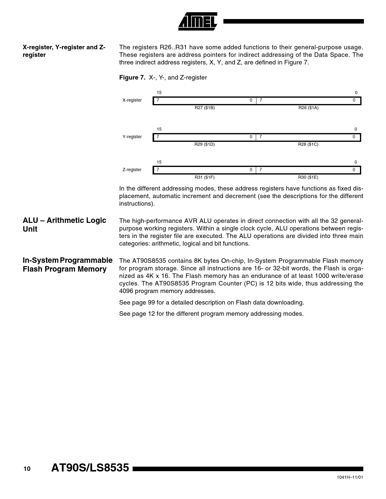

X-register, Y-register and Z-
The registers R26..R31 have some added functions to their general-purpose usage.
register
These registers are address pointers for indirect addressing of the Data Space. The three indirect address registers, X, Y, and Z, are defined in Figure 7.
Figure 7.
X-, Y-, and Z-register 15 0 X-register 7 0 7 0 R27 ($1B) R26 ($1A) 15 0 Y-register 7 0 7 0 R29 ($1D) R28 ($1C) 15 0 Z-register 7 0 7 0 R31 ($1F) R30 ($1E) In the different addressing modes, these address registers have functions as fixed dis- placement, automatic increment and decrement (see the descriptions for the different instructions).
