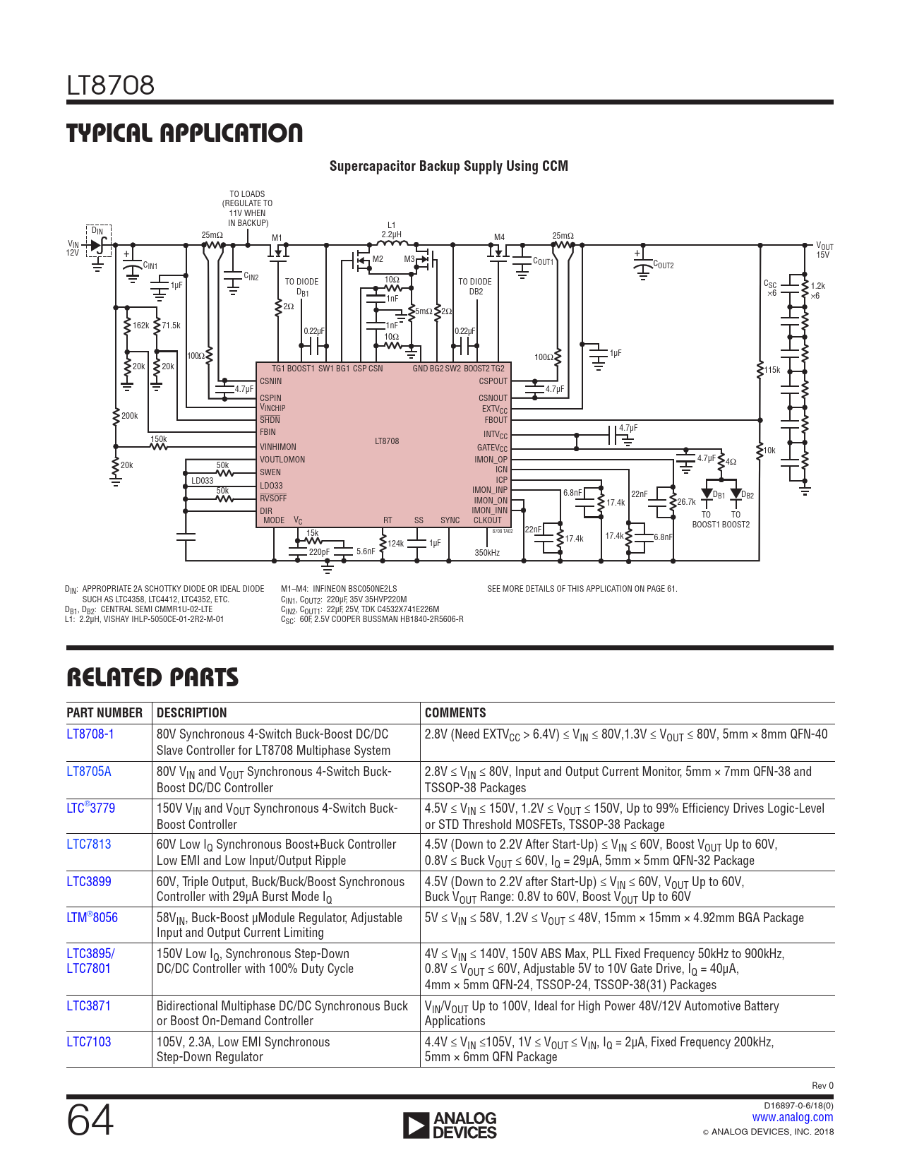

Description80V Synchronous 4-Switch Buck-Boost DC/DC Controller with Bidirectional Capability
Pages / Page64 / 64 — TYPICAL APPLICATION. Supercapacitor Backup Supply Using CCM. RELATED …

TYPICAL APPLICATION. Supercapacitor Backup Supply Using CCM. RELATED PARTS. PART NUMBER DESCRIPTION. COMMENTS
TYPICAL APPLICATION Supercapacitor Backup Supply Using CCM RELATED PARTS PART NUMBER DESCRIPTION COMMENTS
LT8708
TO LOADS (REGULATE TO 11V WHEN IN BACKUP) D L1 IN 25mΩ 2.2μH M1 M4 25mΩ VIN VOUT 12V + + 15V C M2 M3 C IN1 OUT1 COUT2 CIN2 TO DIODE 10Ω TO DIODE C 1µF SC 1.2k DB1 DB2 ×6 ×6 1nF 2Ω 5mΩ 2Ω 162k 71.5k 1nF 0.22µF 0.22µF 10Ω 100Ω 100Ω 1µF 20k 20k TG1 BOOST1 SW1 BG1 CSP CSN GND BG2 SW2 BOOST2 TG2 115k CSNIN CSPOUT 4.7µF 4.7µF CSPIN CSNOUT VINCHIP EXTVCC 200k SHDN FBOUT FBIN 4.7µF INTVCC 150k LT8708 VINHIMON GATEVCC 10k VOUTLOMON IMON_OP 4.7µF 4Ω 20k 50k SWEN ICN LD033 ICP LDO33 50k IMON_INP 6.8nF RVSOFF 22nF D IMON_ON B1 DB2 17.4k 26.7k DIR IMON_INN TO TO MODE VC RT SS SYNC CLKOUT BOOST1 BOOST2 8708 TA02 15k 22nF 17.4k 6.8nF 124k 1µF 17.4k 220pF 5.6nF 350kHz DIN: APPROPRIATE 2A SCHOTTKY DIODE OR IDEAL DIODE M1–M4: INFINEON BSC050NE2LS SEE MORE DETAILS OF THIS APPLICATION ON PAGE 61. SUCH AS LTC4358, LTC4412, LTC4352, ETC. CIN1, COUT2: 220μF, 35V 35HVP220M DB1, DB2: CENTRAL SEMI CMMR1U-02-LTE CIN2, COUT1: 22µF, 25V, TDK C4532X741E226M L1: 2.2μH, VISHAY IHLP-5050CE-01-2R2-M-01 CSC: 60F, 2.5V COOPER BUSSMAN HB1840-2R5606-R
