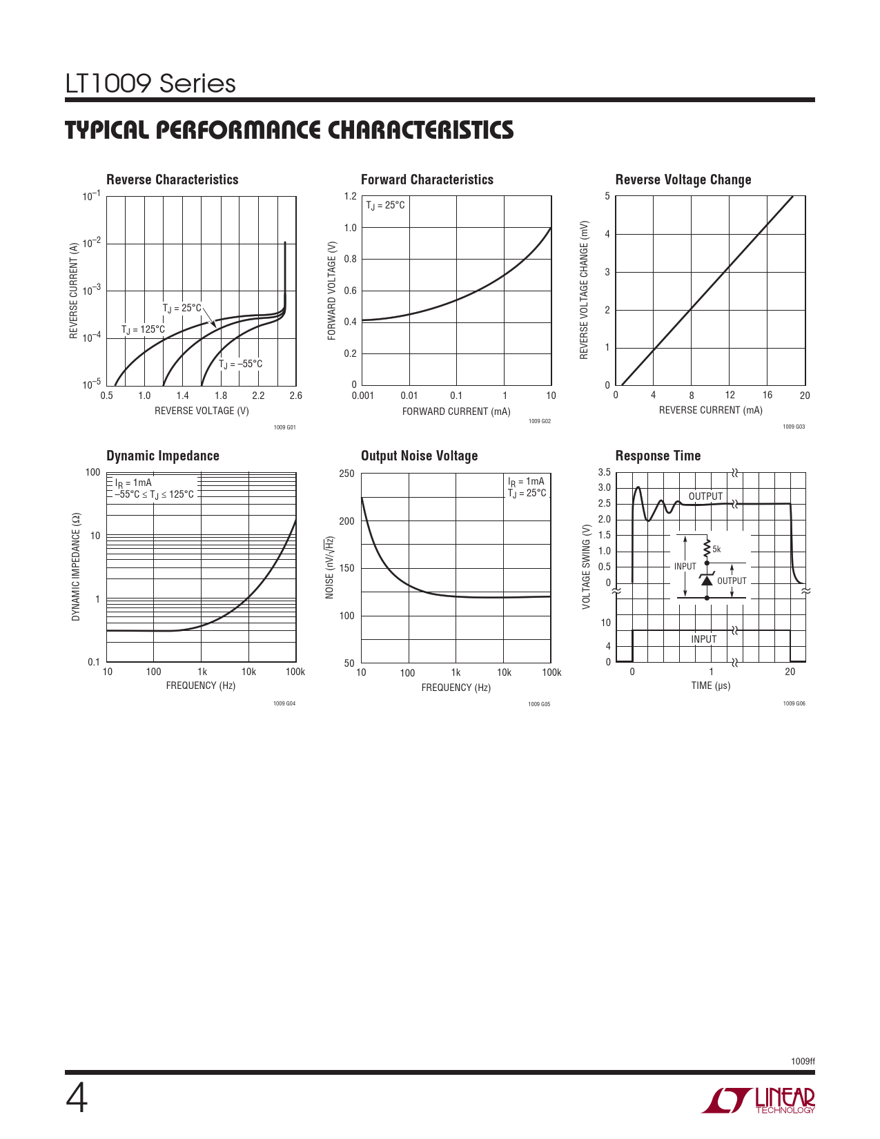

TYPICAL PERFORMANCE CHARACTERISTICS. Reverse Characteristics. Forward Characteristics. Reverse Voltage Change
TYPICAL PERFORMANCE CHARACTERISTICS Reverse Characteristics Forward Characteristics Reverse Voltage Change
LT1009 Series
10–1 1.2 5 TJ = 25°C 1.0 4 10–2 0.8 3 10–3 0.6 TJ = 25°C 2 0.4 T REVERSE CURRENT (A) J = 125°C 10–4 FORWARD VOLTAGE (V) 1 0.2 REVERSE VOLTAGE CHANGE (mV) TJ = –55°C 10–5 0 0 0.5 1.0 1.4 1.8 2.2 2.6 0.001 0.01 0.1 1 10 0 4 8 12 16 20 REVERSE VOLTAGE (V) FORWARD CURRENT (mA) REVERSE CURRENT (mA) 1009 G02 1009 G01 1009 G03
Dynamic Impedance Output Noise Voltage Response Time
100 250 3.5 I I R = 1mA R = 1mA 3.0 –55°C ≤ TJ ≤ 125°C TJ = 25°C OUTPUT 2.5 200 2.0 10 1.5 1.0 5k 150 0.5 INPUT 0 OUTPUT 1 NOISE (nV/√Hz) VOLTAGE SWING (V) DYNAMIC IMPEDANCE (Ω) 100 10 INPUT 4 0.1 50 0 10 100 1k 10k 100k 10 100 1k 10k 100k 0 1 20 FREQUENCY (Hz) FREQUENCY (Hz) TIME (μs) 1009 G04 1009 G05 1009 G06 1009ff 4
