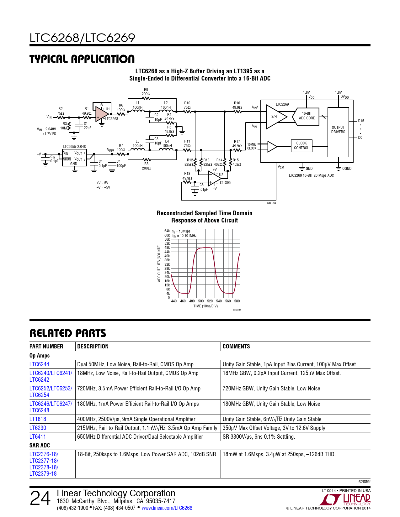

TYPICAL APPLICATION LTC6268 as a High-Z Buffer Driving an LT1395 as a Single-Ended to Differential Converter Into a 16-Bit ADC
R9 1.8V 1.8V 200Ω VDD OVDD L1 L2 R10 R16 +V LTC2269 R6 100nH 100nH 75Ω 49.9Ω A + IN+ R2 R1 U1 – 100Ω 75Ω 49.9Ω 16-BIT V C2 R4 IN + –LTC6268 S/H ADC CORE 10pF 49.9Ω D15 R3 C1 • • • A 22pF R5 IN– 10M OUTPUT VIN = 2.048V 49.9Ω DRIVERS ±1.7V FS D0 C3 L3 L4 R11 R17 10pF 10MHz CLOCK LTC6655-2.048 R7 100nH 100nH 75Ω 49.9Ω CLOCK CONTROL V 100Ω V REF +V IN VOUT_F CIN SHDN VOUT_s R12 R13 R14 R15 0.1µF C4 C4 GND R8 825Ω 825Ω 402Ω 402Ω 0.1µF 100µF V 200Ω CM GND OGND +V R18 + – U2 LTC2269 16-BIT 20 Msps ADC 49.9Ω +V = 5V + C5 – LT1395 –V = –5V .01µF –V 6268 TA03
Reconstructed Sampled Time Domain Response of Above Circuit
64k fS = 10Msps 60k fIN = 10.101MHz 56k 52k 48k 44k 40k 36k 32k 28k 24k 20k ADC OUTPUTS (COUNTS) 16k 12k 8k 4k0 440 460 480 500 520 540 560 580 TIME (10ns/DIV) 6268 F11
