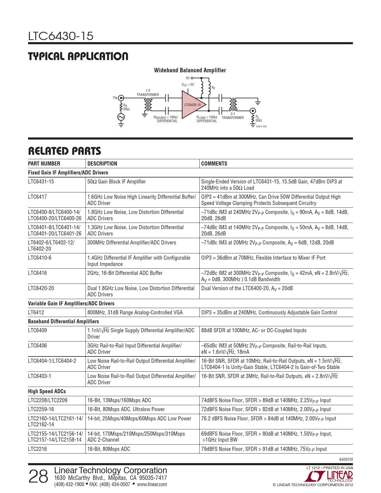

Typical applicaTion Wideband Balanced Amplifier
5V VCC = 5V RF 1:2 TRANSFORMER VIN R LTC6430-15 S 50Ω 2:1 RSOURCE = 100Ω R R LOAD = 100Ω TRANSFORMER L DIFFERENTIAL DIFFERENTIAL 50Ω 643015 TA05
