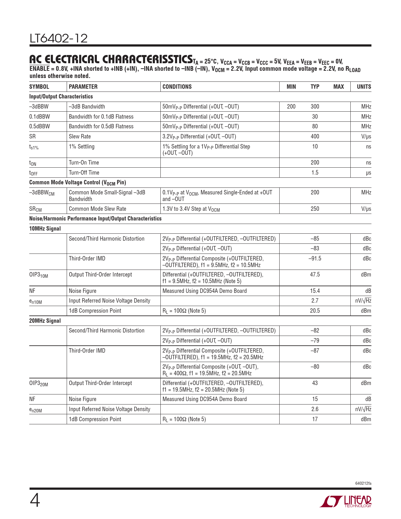

AC ELECTRICAL CHARACTERISSTICS A = 25°C, VCCA = VCCB = VCCC = 5V, VEEA = VEEB = VEEC = 0V,
LT6402-12
T AC ELECTRICAL CHARACTERISSTICS A = 25°C, VCCA = VCCB = VCCC = 5V, VEEA = VEEB = VEEC = 0V,
E
N
A
B
L
E = 0.8V, +INA shorted to +INB (+IN), –INA shorted to –INB (–IN), VOCM = 2.2V, Input common mode voltage = 2.2V, no RLOAD unless otherwise noted. SYMBOL PARAMETER CONDITIONS MIN TYP MAX UNITS Input/Output Characteristics
–3dBBW –3dB Bandwidth 50mVP-P Differential (+OUT, –OUT) 200 300 MHz 0.1dBBW Bandwidth for 0.1dB Flatness 50mVP-P Differential (+OUT, –OUT) 30 MHz 0.5dBBW Bandwidth for 0.5dB Flatness 50mVP-P Differential (+OUT, –OUT) 80 MHz SR Slew Rate 3.2VP-P Differential (+OUT, –OUT) 400 V/μs ts1% 1% Settling 1% Settling for a 1VP-P Differential Step 10 ns (+OUT, –OUT) tON Turn-On Time 200 ns tOFF Turn-Off Time 1.5 μs
Common Mode Voltage Control (VOCM Pin)
–3dBBWCM Common Mode Small-Signal –3dB 0.1VP-P at VOCM, Measured Single-Ended at +OUT 200 MHz Bandwidth and –OUT SRCM Common Mode Slew Rate 1.3V to 3.4V Step at VOCM 250 V/μs
Noise/Harmonic Performance Input/Output Characteristics 10MHz Signal
Second/Third Harmonic Distortion 2VP-P Differential (+OUTFILTERED, –OUTFILTERED) –85 dBc 2VP-P Differential (+OUT, –OUT) –83 dBc Third-Order IMD 2VP-P Differential Composite (+OUTFILTERED, –91.5 dBc –OUTFILTERED), f1 = 9.5MHz, f2 = 10.5MHz OIP310M Output Third-Order Intercept Differential (+OUTFILTERED, –OUTFILTERED), 47.5 dBm f1 = 9.5MHz, f2 = 10.5MHz (Note 5) NF Noise Figure Measured Using DC954A Demo Board 15.4 dB en10M Input Referred Noise Voltage Density 2.7 nV/√Hz 1dB Compression Point RL = 100Ω (Note 5) 20.5 dBm
20MHz Signal
Second/Third Harmonic Distortion 2VP-P Differential (+OUTFILTERED, –OUTFILTERED) –82 dBc 2VP-P Differential (+OUT, –OUT) –79 dBc Third-Order IMD 2VP-P Differential Composite (+OUTFILTERED, –87 dBc –OUTFILTERED), f1 = 19.5MHz, f2 = 20.5MHz 2VP-P Differential Composite (+OUT, –OUT), –80 dBc RL = 400Ω, f1 = 19.5MHz, f2 = 20.5MHz OIP320M Output Third-Order Intercept Differential (+OUTFILTERED, –OUTFILTERED), 43 dBm f1 = 19.5MHz, f2 = 20.5MHz (Note 5) NF Noise Figure Measured Using DC954A Demo Board 15 dB en20M Input Referred Noise Voltage Density 2.6 nV/√Hz 1dB Compression Point RL = 100Ω (Note 5) 17 dBm 640212fa 4
